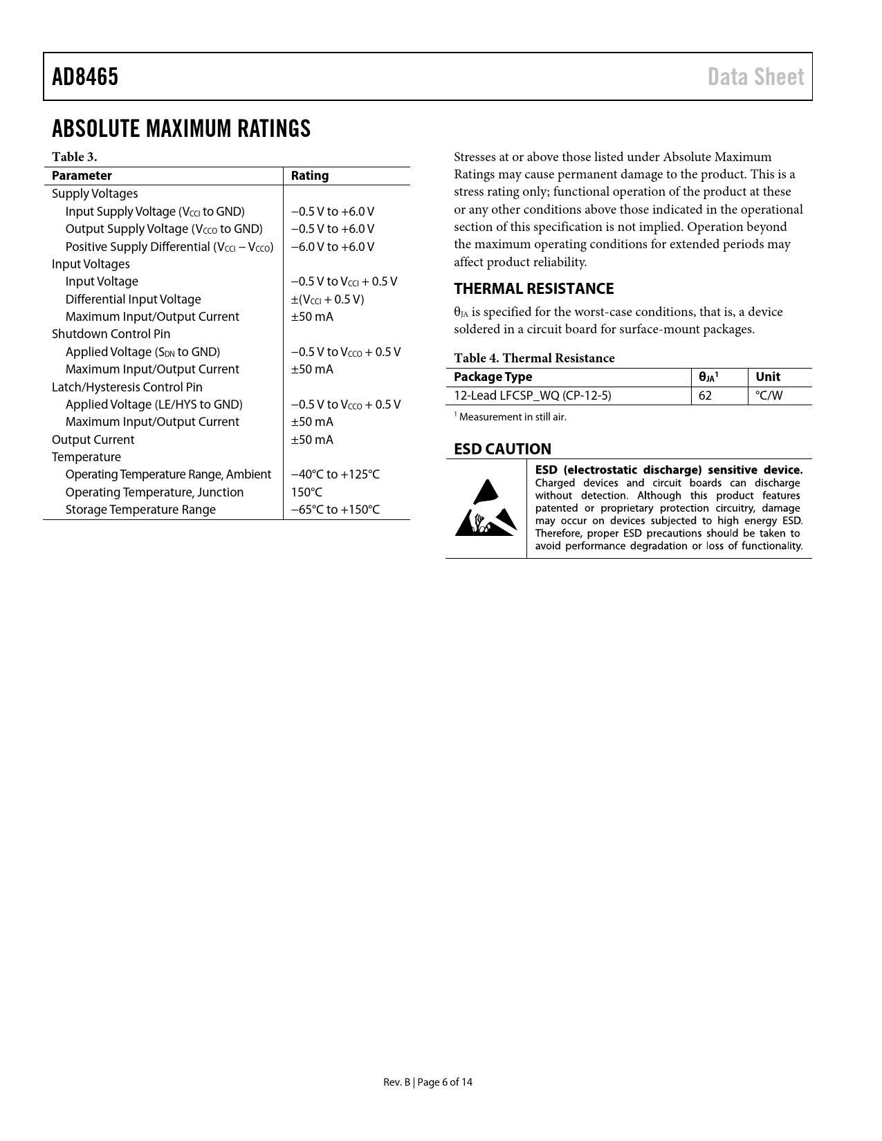

AD8465. Data Sheet. ABSOLUTE MAXIMUM RATINGS Table 3. Parameter. Rating. THERMAL RESISTANCE. Table 4. Thermal Resistance
AD8465 Data Sheet ABSOLUTE MAXIMUM RATINGS Table 3 Parameter Rating THERMAL RESISTANCE Table 4 Thermal Resistance
AD8465 Data Sheet ABSOLUTE MAXIMUM RATINGS Table 3.
Stresses at or above those listed under Absolute Maximum
Parameter Rating
Ratings may cause permanent damage to the product. This is a Supply Voltages stress rating only; functional operation of the product at these Input Supply Voltage (VCCI to GND) −0.5 V to +6.0 V or any other conditions above those indicated in the operational Output Supply Voltage (VCCO to GND) −0.5 V to +6.0 V section of this specification is not implied. Operation beyond Positive Supply Differential (VCCI − VCCO) −6.0 V to +6.0 V the maximum operating conditions for extended periods may Input Voltages affect product reliability. Input Voltage −0.5 V to VCCI + 0.5 V
THERMAL RESISTANCE
Differential Input Voltage ±(VCCI + 0.5 V) Maximum Input/Output Current ±50 mA θJA is specified for the worst-case conditions, that is, a device Shutdown Control Pin soldered in a circuit board for surface-mount packages. Applied Voltage (SDN to GND) −0.5 V to VCCO + 0.5 V
Package Type θ 1 JA Unit
Latch/Hysteresis Control Pin 12-Lead LFCSP_WQ (CP-12-5) 62 °C/W Applied Voltage (LE/HYS to GND) −0.5 V to VCCO + 0.5 V 1 Maximum Input/Output Current ±50 mA Measurement in stil air. Output Current ±50 mA
ESD CAUTION
Temperature Operating Temperature Range, Ambient −40°C to +125°C Operating Temperature, Junction 150°C Storage Temperature Range −65°C to +150°C Rev. B | Page 6 of 14 Document Outline FEATURES APPLICATIONS FUNCTIONAL BLOCK DIAGRAM GENERAL DESCRIPTION TABLE OF CONTENTS REVISION HISTORY SPECIFICATIONS ELECTRICAL CHARACTERISTICS TIMING INFORMATION ABSOLUTE MAXIMUM RATINGS THERMAL RESISTANCE ESD CAUTION PIN CONFIGURATION AND FUNCTION DESCRIPTIONS TYPICAL PERFORMANCE CHARACTERISTICS APPLICATION INFORMATION POWER/GROUND LAYOUT AND BYPASSING LVDS-COMPATIBLE OUTPUT STAGE USING/DISABLING THE LATCH FEATURE OPTIMIZING PERFORMANCE COMPARATOR PROPAGATION DELAY DISPERSION COMPARATOR HYSTERESIS CROSSOVER BIAS POINTS MINIMUM INPUT SLEW RATE REQUIREMENT TYPICAL APPLICATION CIRCUITS OUTLINE DIMENSIONS ORDERING GUIDE AUTOMOTIVE PRODUCTS
