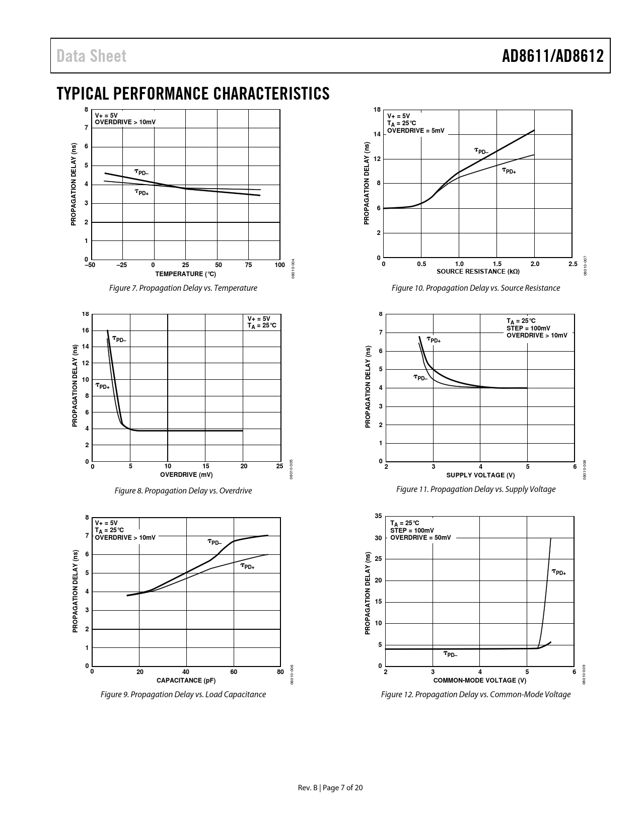

Data Sheet. AD8611/AD8612. TYPICAL PERFORMANCE CHARACTERISTICS. V+ = 5V. OVERDRIVE > 10mV. A = 25°C. OVERDRIVE = 5mV. PD–. PD+. N DE
Data Sheet AD8611/AD8612 TYPICAL PERFORMANCE CHARACTERISTICS V+ = 5V OVERDRIVE > 10mV A = 25°C OVERDRIVE = 5mV PD– PD+ N DE
Data Sheet AD8611/AD8612 TYPICAL PERFORMANCE CHARACTERISTICS 8 18 V+ = 5V V+ = 5V OVERDRIVE > 10mV T 7 A = 25°C OVERDRIVE = 5mV 14 s) 6 s) n n ( ( PD– 12 AY AY L 5 L PD– PD+ N DE N DE 4 8 IO IO PD+ AT AT 3 AG AG P P 6 RO RO P 2 P 2 1 0 0
007
–50 –25 0 25 50 75 100
004
0 0.5 1.0 1.5 2.0 2.5 SOURCE RESISTANCE (kΩ) TEMPERATURE (°C)
06010- 06010- Figure 7. Propagation Delay vs. Temperature Figure 10. Propagation Delay vs. Source Resistance
18 8 V+ = 5V T T A = 25°C A = 25°C 16 STEP = 100mV 7 OVERDRIVE > 10mV PD– PD+ s) 14 n s) 6 ( n ( AY 12 L AY L 5 10 PD– N DE N DE IO PD+ 4 IO AT 8 AT AG AG 3 P 6 P RO RO P 2 4 P 2 1 0 0 0 5 10 15 20 25
005
2 3 4 5 6
008
OVERDRIVE (mV) SUPPLY VOLTAGE (V)
06010- 06010- Figure 8. Propagation Delay vs. Overdrive Figure 11. Propagation Delay vs. Supply Voltage
8 35 V+ = 5V TA = 25°C TA = 25°C STEP = 100mV 7 OVERDRIVE > 10mV 30 OVERDRIVE = 50mV PD– s) 6 n s) ( n 25 ( AY PD+ L 5 AY L PD+ 20 N DE 4 N DE IO IO AT 15 AT 3 AG P AG P 10 RO 2 P RO P 1 5 PD– 0 0 0 20 40 60 80
006
2 3 4 5 6
009
CAPACITANCE (pF) COMMON-MODE VOLTAGE (V)
06010- 06010- Figure 9. Propagation Delay vs. Load Capacitance Figure 12. Propagation Delay vs. Common-Mode Voltage Rev. B | Page 7 of 20 Document Outline FEATURES APPLICATIONS PIN CONFIGURATIONS GENERAL DESCRIPTION REVISION HISTORY SPECIFICATIONS ABSOLUTE MAXIMUM RATINGS THERMAL RESISTANCE ESD CAUTION PIN CONFIGURATIONS AND FUNCTION DESCRIPTIONS TYPICAL PERFORMANCE CHARACTERISTICS APPLICATIONS INFORMATION OPTIMIZING HIGH SPEED PERFORMANCE UPGRADING THE LT1394 AND LT1016 MAXIMUM INPUT FREQUENCY AND OVERDRIVE OUTPUT LOADING CONSIDERATIONS USING THE LATCHTO MAINTAIN A CONSTANT OUTPUT INPUT STAGE AND BIAS CURRENTS USING HYSTERESIS CLOCK TIMING RECOVERY A 5 V, HIGH SPEED WINDOW COMPARATOR OUTLINE DIMENSIONS ORDERING GUIDE
