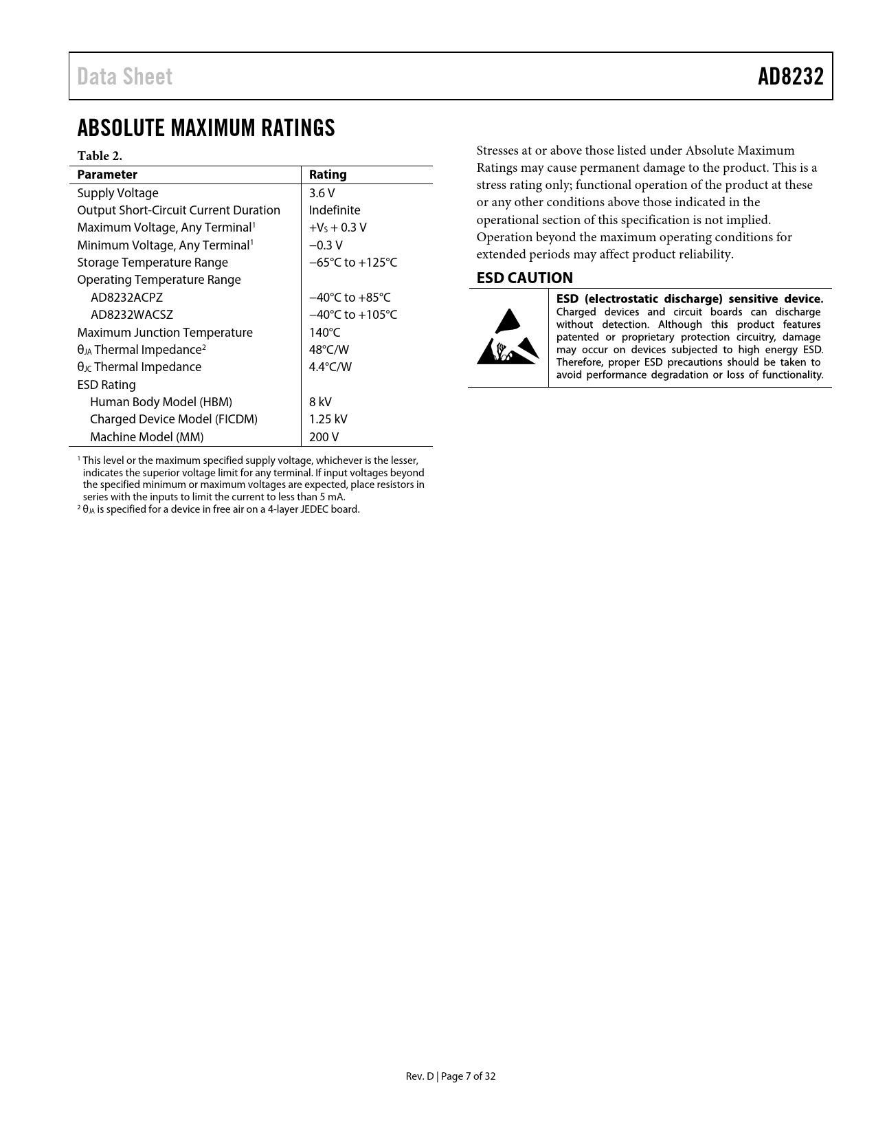

Data Sheet. AD8232. ABSOLUTE MAXIMUM RATINGS Table 2. Parameter. Rating. ESD CAUTION
Data Sheet AD8232 ABSOLUTE MAXIMUM RATINGS Table 2 Parameter Rating ESD CAUTION
Data Sheet AD8232 ABSOLUTE MAXIMUM RATINGS Table 2.
Stresses at or above those listed under Absolute Maximum
Parameter Rating
Ratings may cause permanent damage to the product. This is a stress rating only; functional operation of the product at these Supply Voltage 3.6 V or any other conditions above those indicated in the Output Short-Circuit Current Duration Indefinite operational section of this specification is not implied. Maximum Voltage, Any Terminal1 +VS + 0.3 V Operation beyond the maximum operating conditions for Minimum Voltage, Any Terminal1 −0.3 V extended periods may affect product reliability. Storage Temperature Range −65°C to +125°C Operating Temperature Range
ESD CAUTION
AD8232ACPZ −40°C to +85°C AD8232WACSZ −40°C to +105°C Maximum Junction Temperature 140°C θJA Thermal Impedance2 48°C/W θ JC Thermal Impedance 4.4°C/W ESD Rating Human Body Model (HBM) 8 kV Charged Device Model (FICDM) 1.25 kV Machine Model (MM) 200 V 1 This level or the maximum specified supply voltage, whichever is the lesser, indicates the superior voltage limit for any terminal. If input voltages beyond the specified minimum or maximum voltages are expected, place resistors in series with the inputs to limit the current to less than 5 mA. 2 θJA is specified for a device in free air on a 4-layer JEDEC board. Rev. D | Page 7 of 32 Document Outline Features Applications Functional Block Diagram General Description Revision History Specifications Absolute Maximum Ratings ESD Caution Pin Configuration and Function Descriptions Typical Performance Characteristics Instrumentation Amplifier Performance Curves Operational Amplifier Performance Curves Right Leg Drive (RLD) Amplifier Performance Curves Reference Buffer Performance Curves System Performance Curves Theory of Operation Architecture Overview Instrumentation Amplifier Operational Amplifier Right Leg Drive Amplifier Reference Buffer Fast Restore Circuit Leads Off Detection DC Leads Off Detection AC Leads Off Detection Standby Operation Input Protection Radio Frequency Interference (RFI) Power Supply Regulation and Bypassing Input Referred Offsets Layout Recommendations Applications Information Eliminating Electrode Offsets High-Pass Filtering Two-Pole High-Pass Filter Additional High-Pass Filtering Options Low-Pass Filtering and Gain Driving Analog-to-Digital Converters Driven Electrode Application Circuits Heart Rate Measurement Next to the Heart Exercise Application: Heart Rate Measured at the Hands Cardiac Monitor Configuration Portable Cardiac Monitor with Elimination of Motion Artifacts Packaging and Ordering Information Outline Dimensions Ordering Guide
