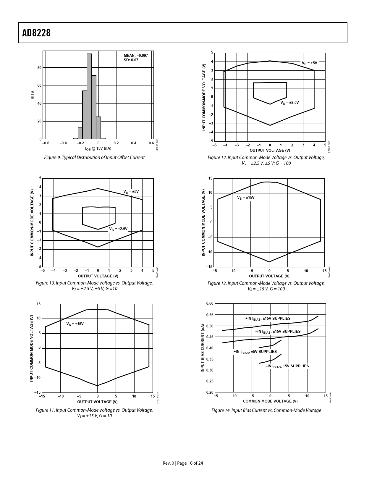

AD8228. MEAN: –0.097 SD: 0.07. VS = ±5V. (V E. G A T. E VO. D O. S = ±2.5V. M M O –2. T –3. PU IN –4. 0 –0.6. –0.4. –0.2. 0.2. 0.4. 0.6. OS @ 15V (nA)
AD8228 MEAN: –0.097 SD: 0.07 VS = ±5V (V E G A T E VO D O S = ±2.5V M M O –2 T –3 PU IN –4 0 –0.6 –0.4 –0.2 0.2 0.4 0.6 OS @ 15V (nA)
AD8228 5 MEAN: –0.097 SD: 0.07 4 ) VS = ±5V 80 (V E 3 G A T 2 L 60 1 S E VO T D O HI 0 -M 40 N V O S = ±2.5V –1 M M O –2 C 20 T –3 PU IN –4 0 –0.6 –0.4 –0.2 0 0.2 0.4 0.6

03 07 Figure 9. Typical Distribution of Input Offset Current Figure 12. Input Common-Mode Voltage vs. Output Voltage, VS = ±2.5 V, ±5 V; G = 100

03 07 07 Figure 10. Input Common-Mode Voltage vs. Output Voltage, Figure 13. Input Common-Mode Voltage vs. Output Voltage, VS = ±2.5 V, ±5 V; G =10 VS = ±15 V, G = 100

03 07 07 Figure 11. Input Common-Mode Voltage vs. Output Voltage, Figure 14. Input Bias Current vs. Common-Mode Voltage VS = ±15 V, G = 10 Rev. 0 | Page 10 of 24 Document Outline FEATURES APPLICATIONS GENERAL DESCRIPTION CONNECTION DIAGRAM TABLE OF CONTENTS REVISION HISTORY SPECIFICATIONS GAIN = 10 GAIN = 100 ABSOLUTE MAXIMUM RATINGS THERMAL RESISTANCE ESD CAUTION PIN CONFIGURATION AND FUNCTION DESCRIPTIONS TYPICAL PERFORMANCE CHARACTERISTICS THEORY OF OPERATION ARCHITECTURE SETTING THE GAIN COMMON-MODE INPUT VOLTAGE RANGE REFERENCE TERMINAL LAYOUT Common-Mode Rejection Ratio over Frequency Power Supplies References Input Bias Current Return Path INPUT PROTECTION Input Voltages Beyond the Rails Large Differential Voltages When G = 100 RADIO FREQUENCY INTERFERENCE (RFI) APPLICATIONS INFORMATION DIFFERENTIAL DRIVE PRECISION STRAIN GAGE DRIVING A DIFFERENTIAL ADC OUTLINE DIMENSIONS ORDERING GUIDE
