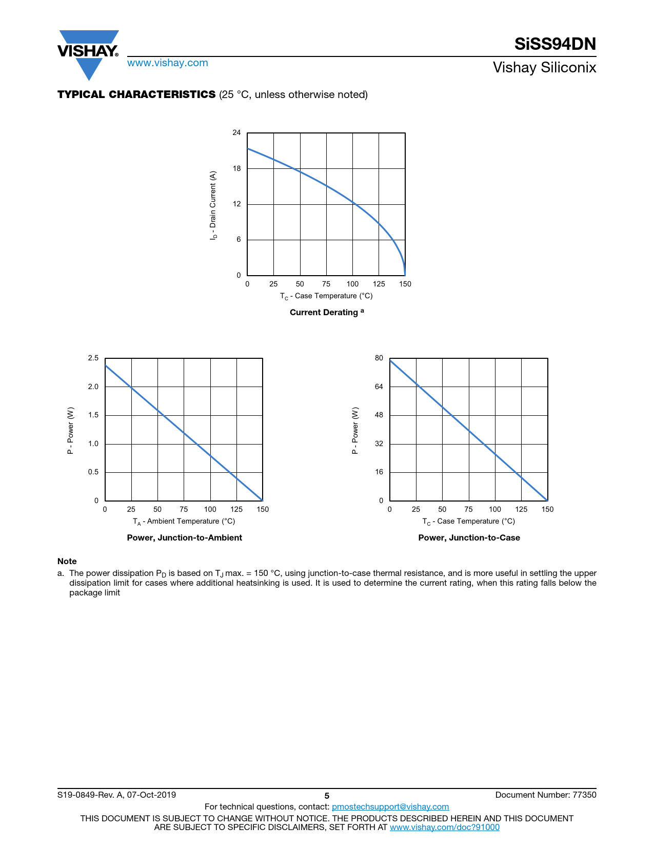

SiSS94DN. TYPICAL CHARACTERISTICS. Current Derating a. Power, Junction-to-Ambient. Power, Junction-to-Case. Note
SiSS94DN TYPICAL CHARACTERISTICS Current Derating a Power, Junction-to-Ambient Power, Junction-to-Case Note
SiSS94DN
(25 °C, unless otherwise noted) Axis Title 24 10000 18 ) 1000 rrent (A ne ne ine u 12 C n 1st li 2nd li 2nd l rai D 100 - I D 6 0 10 0 25 50 75 100 125 150 T - Case Temperature (°C) C
Current Derating a
Axis Title Axis Title 2.5 10000 80 10000 2.0 64 1000 ) 1000 ) 1.5 48 ne ne ne r (W ne er (W ne ne e w ow 1st li o P 2nd li 2nd li 1st li P 2nd li 1.0 2nd li - 32 P 100 P - 100 0.5 16 0 10 0 10 0 25 50 75 100 125 150 0 25 50 75 100 125 150 T - Ambient Temperature (°C) T - Case Temperature (°C) A C
a. The power dissipation PD is based on TJ max. = 150 °C, using junction-to-case thermal resistance, and is more useful in settling the upper dissipation limit for cases where additional heatsinking is used. It is used to determine the current rating, when this rating falls below the package limit S19-0849-Rev. A, 07-Oct-2019
