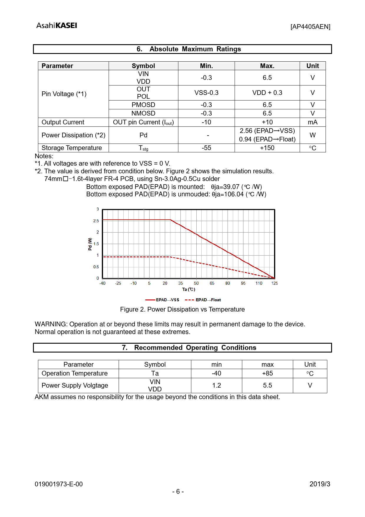

6. Absolute Maximum Ratings. Parameter. Symbol. Min. Max. Unit. 7. Recommended Operating Conditions
6 Absolute Maximum Ratings Parameter Symbol Min Max Unit 7 Recommended Operating Conditions
[AP4405AEN]
6. Absolute Maximum Ratings Parameter Symbol Min. Max. Unit
VIN -0.3 VDD 6.5 V OUT Pin Voltage (*1) VSS-0.3 POL VDD + 0.3 V PMOSD -0.3 6.5 V NMOSD -0.3 6.5 V Output Current OUT pin Current (Iout) -10 +10 mA 2.56 (EPAD→VSS) Power Dissipation (*2) Pd - W 0.94 (EPAD →Float) Storage Temperature Tstg -55 +150 C Notes: *1. All voltages are with reference to VSS = 0 V. *2. The value is derived from condition below. Figure 2 shows the simulation results. 74mm□-1.6t-4layer FR-4 PCB, using Sn-3.0Ag-0.5Cu solder Bottom exposed PAD(EPAD) is mounted: θja=39.07 (°C /W) Bottom exposed PAD(EPAD) is unmouded: θja=106.04 (°C /W) Figure 2. Power Dissipation vs Temperature WARNING: Operation at or beyond these limits may result in permanent damage to the device. Normal operation is not guaranteed at these extremes.
Parameter Symbol min max Unit Operation Temperature Ta -40 +85 C Power Supply Volgtage VIN 1.2 VDD 5.5 V AKM assumes no responsibility for the usage beyond the conditions in this data sheet. 019001973-E-00 2019/3 - 6 -
