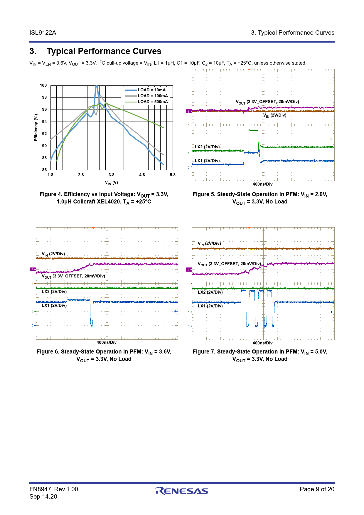

Typical Performance Curves. 100. LOAD = 10mA. LOAD = 100mA LOAD = 500mA. VOUT (3.3V_OFFSET, 20mV/Div). VIN (2V/Div). y (%)
Typical Performance Curves 100 LOAD = 10mA LOAD = 100mA LOAD = 500mA VOUT (3.3V_OFFSET, 20mV/Div) VIN (2V/Div) y (%)
ISL9122A 3. Typical Performance Curves
VIN = VEN = 3.6V, VOUT = 3.3V, I2C pull-up voltage = VIN, L1 = 1µH, C1 = 10µF, C2 = 10µF, TA = +25°C, unless otherwise stated.
100 LOAD = 10mA 98 LOAD = 100mA LOAD = 500mA VOUT (3.3V_OFFSET, 20mV/Div) 96 VIN (2V/Div) 94 y (%) 92 fficienc E 90 LX2 (2V/Div) 88 LX1 (2V/Div) 86 1.8 2.8 3.8 4.8 5.8 VIN (V) 400ns/Div Figure 4. Efficiency vs Input Voltage: VOUT = 3.3V, Figure 5. Steady-State Operation in PFM: VIN = 2.0V, 1.0μH Coilcraft XEL4020, TA = +25°C VOUT = 3.3V, No Load VIN (2V/Div) VIN (2V/Div) VOUT (3.3V_OFFSET, 20mV/Div) VOUT (3.3V_OFFSET, 20mV/Div) LX2 (2V/Div) LX2 (2V/Div) LX1 (2V/Div) LX1 (2V/Div) 400ns/Div 400ns/Div Figure 6. Steady-State Operation in PFM: VIN = 3.6V, Figure 7. Steady-State Operation in PFM: VIN = 5.0V, VOUT = 3.3V, No Load VOUT = 3.3V, No Load
