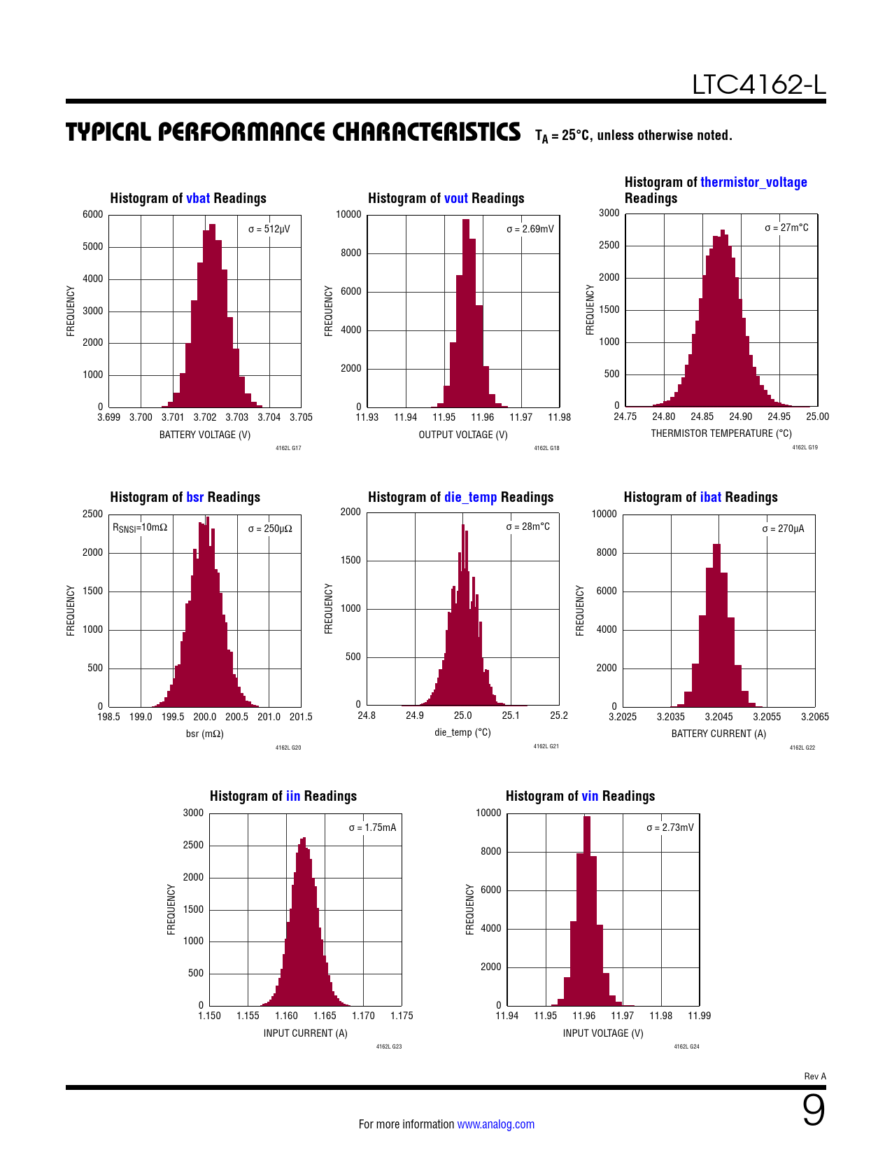

TYPICAL PERFORMANCE CHARACTERISTICS TA = 25°C, unless otherwise noted. Histogram of thermistor_voltage. Histogram of vbat
TYPICAL PERFORMANCE CHARACTERISTICS TA = 25°C, unless otherwise noted Histogram of thermistor_voltage Histogram of vbat
link to page 45 link to page 45 link to page 45 link to page 45 link to page 45 link to page 45 link to page 45 link to page 45 LTC4162-L
TYPICAL PERFORMANCE CHARACTERISTICS TA = 25°C, unless otherwise noted. Histogram of thermistor_voltage Histogram of vbat Readings Histogram of vout Readings Readings
6000 10000 3000 σ = 512µV σ = 2.69mV σ = 27m°C 5000 2500 8000 4000 2000 6000 3000 1500 FREQUENCY 4000 FREQUENCY FREQUENCY 2000 1000 2000 1000 500 0 0 0 3.699 3.700 3.701 3.702 3.703 3.704 3.705 11.93 11.94 11.95 11.96 11.97 11.98 24.75 24.80 24.85 24.90 24.95 25.00 BATTERY VOLTAGE (V) OUTPUT VOLTAGE (V) THERMISTOR TEMPERATURE (°C) 4162L G17 4162L G18 4162L G19
Histogram of bsr Readings Histogram of die_temp Readings Histogram of ibat Readings
2500 2000 10000 S R NSI =10mΩ σ = 250µΩ σ = 28m°C σ = 270µA 2000 8000 1500 1500 6000 1000 1000 FREQUENCY FREQUENCY 4000 FREQUENCY 500 500 2000 0 0 0 198.5 199.0 199.5 200.0 200.5 201.0 201.5 24.8 24.9 25.0 25.1 25.2 3.2025 3.2035 3.2045 3.2055 3.2065 bsr (mΩ) die_temp (°C) BATTERY CURRENT (A) 4162L G20 4162L G21 4162L G22
Histogram of iin Readings Histogram of vin Readings
3000 10000 σ = 1.75mA σ = 2.73mV 2500 8000 2000 6000 1500 FREQUENCY 4000 FREQUENCY 1000 2000 500 0 0 1.150 1.155 1.160 1.165 1.170 1.175 11.94 11.95 11.96 11.97 11.98 11.99 INPUT CURRENT (A) INPUT VOLTAGE (V) 4162L G23 4162L G24 Rev A For more information www.analog.com 9 Document Outline Features Applications Typical Application Description Absolute Maximum Ratings Order Information Pin Configuration Electrical Characteristics Typical Performance Characteristics Pin Functions Block Diagram ESD Diagram Timing Diagram Operation Applications Information Register Descriptions Typical Applications Package Description Revision History Typical Application Related Parts
