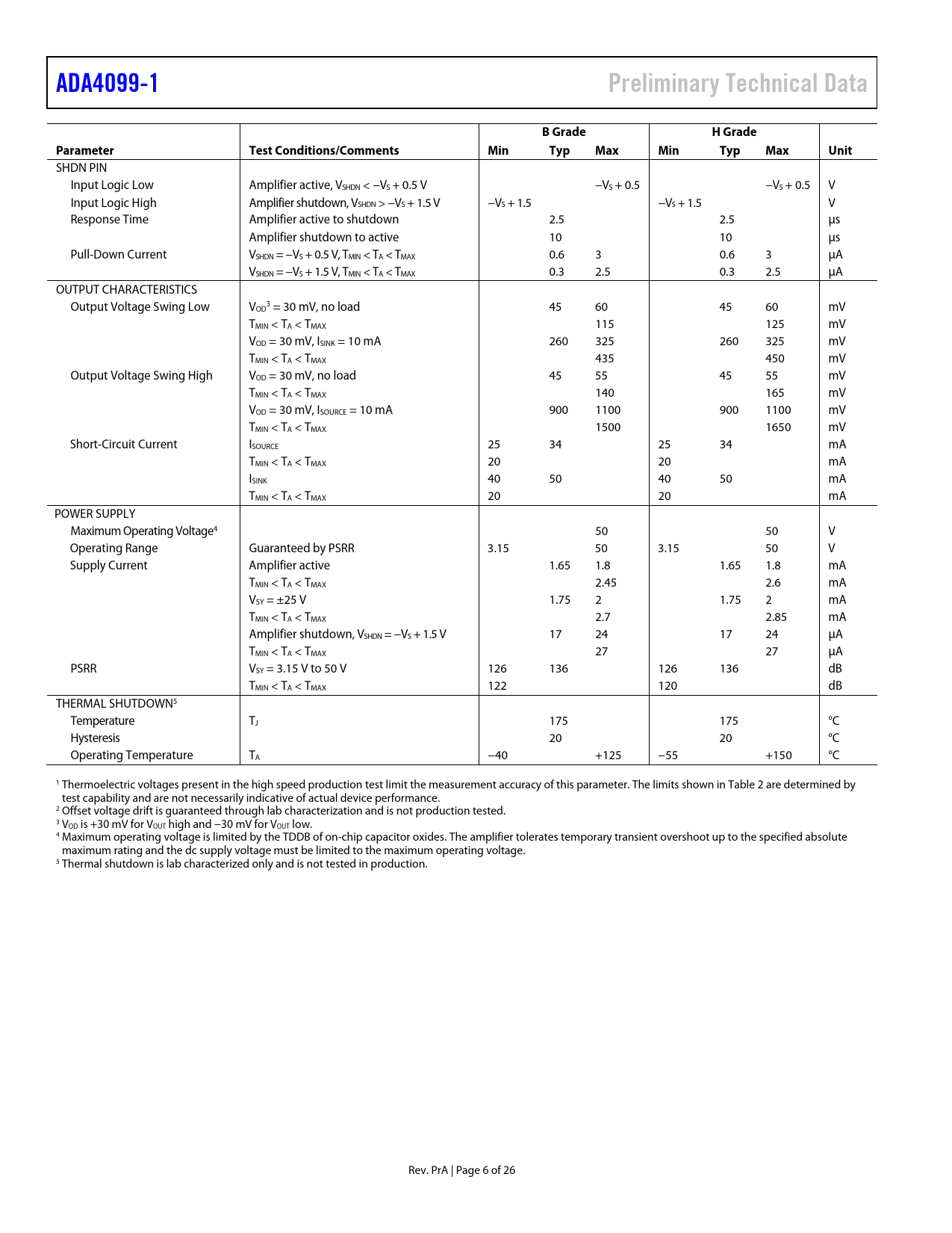

ADA4099-1. Preliminary Technical Data. B Grade. H Grade. Parameter Test. Conditions/Comments. Min Typ. Max Min Typ. Uni
ADA4099-1 Preliminary Technical Data B Grade H Grade Parameter Test Conditions/Comments Min Typ Max Min Typ Uni
link to page 5
ADA4099-1 Preliminary Technical Data B Grade H Grade Parameter Test Conditions/Comments Min Typ Max Min Typ Ma Uni x t
SHDN PIN Input Logic Low Amplifier active, VSHDN < −VS + 0.5 V −VS + 0.5 −VS + 0.5 V Input Logic High Amplifier shutdown, VSHDN > −VS + 1.5 V −VS + 1.5 −VS + 1.5 V Response Time Amplifier active to shutdown 2.5 2.5 μs Amplifier shutdown to active 10 10 μs Pull-Down Current VSHDN = −VS + 0.5 V, TMIN < TA < TMAX 0.6 3 0.6 3 μA VSHDN = −VS + 1.5 V, TMIN < TA < TMAX 0.3 2.5 0.3 2.5 μA OUTPUT CHARACTERISTICS Output Voltage Swing Low V 3 OD = 30 mV, no load 45 60 45 60 mV TMIN < TA < TMAX 115 125 mV VOD = 30 mV, ISINK = 10 mA 260 325 260 325 mV TMIN < TA < TMAX 435 450 mV Output Voltage Swing High VOD = 30 mV, no load 45 55 45 55 mV TMIN < TA < TMAX 140 165 mV VOD = 30 mV, ISOURCE = 10 mA 900 1100 900 1100 mV TMIN < TA < TMAX 1500 1650 mV Short-Circuit Current ISOURCE 25 34 25 34 mA TMIN < TA < TMAX 20 20 mA ISINK 40 50 40 50 mA TMIN < TA < TMAX 20 20 mA POWER SUPPLY Maximum Operating Voltage4 50 50 V Operating Range Guaranteed by PSRR 3.15 50 3.15 50 V Supply Current Amplifier active 1.65 1.8 1.65 1.8 mA TMIN < TA < TMAX 2.45 2.6 mA VSY = ±25 V 1.75 2 1.75 2 mA TMIN < TA < TMAX 2.7 2.85 mA Amplifier shutdown, VSHDN = −VS + 1.5 V 17 24 17 24 μA TMIN < TA < TMAX 27 27 μA PSRR VSY = 3.15 V to 50 V 126 136 126 136 dB TMIN < TA < TMAX 122 120 dB THERMAL SHUTDOWN5 Temperature TJ 175 175 °C Hysteresis 20 20 °C Operating Temperature TA −40 +125 −55 +150 °C 1 Thermoelectric voltages present in the high speed production test limit the measurement accuracy of this parameter. The limits shown in Table 2 are determined by test capability and are not necessarily indicative of actual device performance. 2 Offset voltage drift is guaranteed through lab characterization and is not production tested. 3 VOD is +30 mV for VOUT high and −30 mV for VOUT low. 4 Maximum operating voltage is limited by the TDDB of on-chip capacitor oxides. The amplifier tolerates temporary transient overshoot up to the specified absolute maximum rating and the dc supply voltage must be limited to the maximum operating voltage. 5 Thermal shutdown is lab characterized only and is not tested in production. Rev. PrA | Page 6 of 26 Document Outline FEATURES APPLICATIONS GENERAL DESCRIPTION TYPICAL APPLICATION CIRCUIT TABLE OF CONTENTS SPECIFICATIONS 5 V SUPPLY ±15 V SUPPLY ABSOLUTE MAXIMUM RATINGS MAXIMUM POWER DISSIPATION THERMAL RESISTANCE ESD CAUTION PIN CONFIGURATION AND FUNCTION DESCRIPTIONS TYPICAL PERFORMANCE CHARACTERISTICS THEORY OF OPERATION INPUT PROTECTION OVER-THE-TOP OPERATION CONSIDERATIONS OUTPUT SHUTDOWN PIN (SHDN) APPLICATIONS INFORMATION LARGE RESISTOR GAIN OPERATION RECOMMENDED VALUES FOR VARIOUS GAINS NOISE DISTORTION POWER DISSIPATION AND THERMAL SHUTDOWN CIRCUIT LAYOUT CONSIDERATIONS POWER SUPPLY BYPASSING GROUNDING ESD PROTECTION WHEN POWERED RELATED PRODUCTS TYPICAL APPLICATIONS OUTLINE DIMENSIONS
