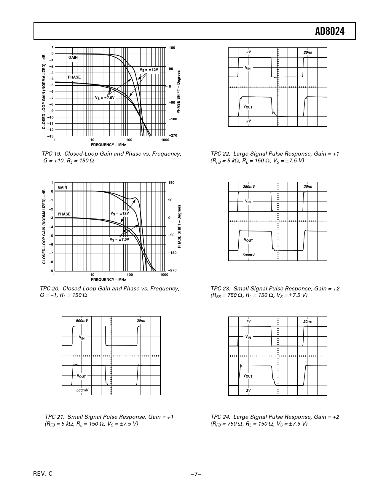

AD8024. 180. 20ns. GAIN. dB –. S =. 12V. PHASE. Degrees. VS =. 7.5V. –90. VOUT. PHASE SHIFT. –10. –180. –11. CLOSED LOOP GAIN (NORMALIZED) –12. –270. –13. 100
AD8024 180 20ns GAIN dB – S = 12V PHASE Degrees VS = 7.5V –90 VOUT PHASE SHIFT –10 –180 –11 CLOSED LOOP GAIN (NORMALIZED) –12 –270 –13 100
AD8024 1 180 0 2V 20ns GAIN dB – –1 –2 90 V V IN S = 12V –3 –4 PHASE –5 Degrees 0 –6 –7 VS = 7.5V –90 –8 VOUT –9 PHASE SHIFT –10 –180 2V –11 CLOSED LOOP GAIN (NORMALIZED) –12 –270 –13 1 10 100 1000 FREQUENCY – MHz
TPC 19. Closed-Loop Gain and Phase vs. Frequency, TPC 22. Large Signal Pulse Response, Gain = +1 G = +10, RL = 150 Ω (RFB = 5 kΩ, RL = 150 Ω, VS = ±7.5 V)
1 180 GAIN 250mV 20ns 0 dB – –1 90 VIN –2 rees VS = 12V PHASE g –3 0 De – –4 –5 –90 VS = 7.5V VOUT –6 PHASE SHIFT –7 –180 500mV CLOSED-LOOP GAIN (NORMALIZED) –8 –9 –270 1 10 100 1000 FREQUENCY – MHz
TPC 20. Closed-Loop Gain and Phase vs. Frequency, TPC 23. Small Signal Pulse Response, Gain = +2 G = –1, RL = 150 Ω (RFB = 750 Ω, RL = 150 Ω, VS = ±7.5 V)
500mV 20ns 1V 20ns V V IN IN VOUT VOUT 500mV 2V
TPC 21. Small Signal Pulse Response, Gain = +1 TPC 24. Large Signal Pulse Response, Gain = +2 (RFB = 5 kΩ, RL = 150 Ω, VS = ±7.5 V) (RFB = 750 Ω, RL = 150 Ω, VS = ±7.5 V) REV. C –7–
