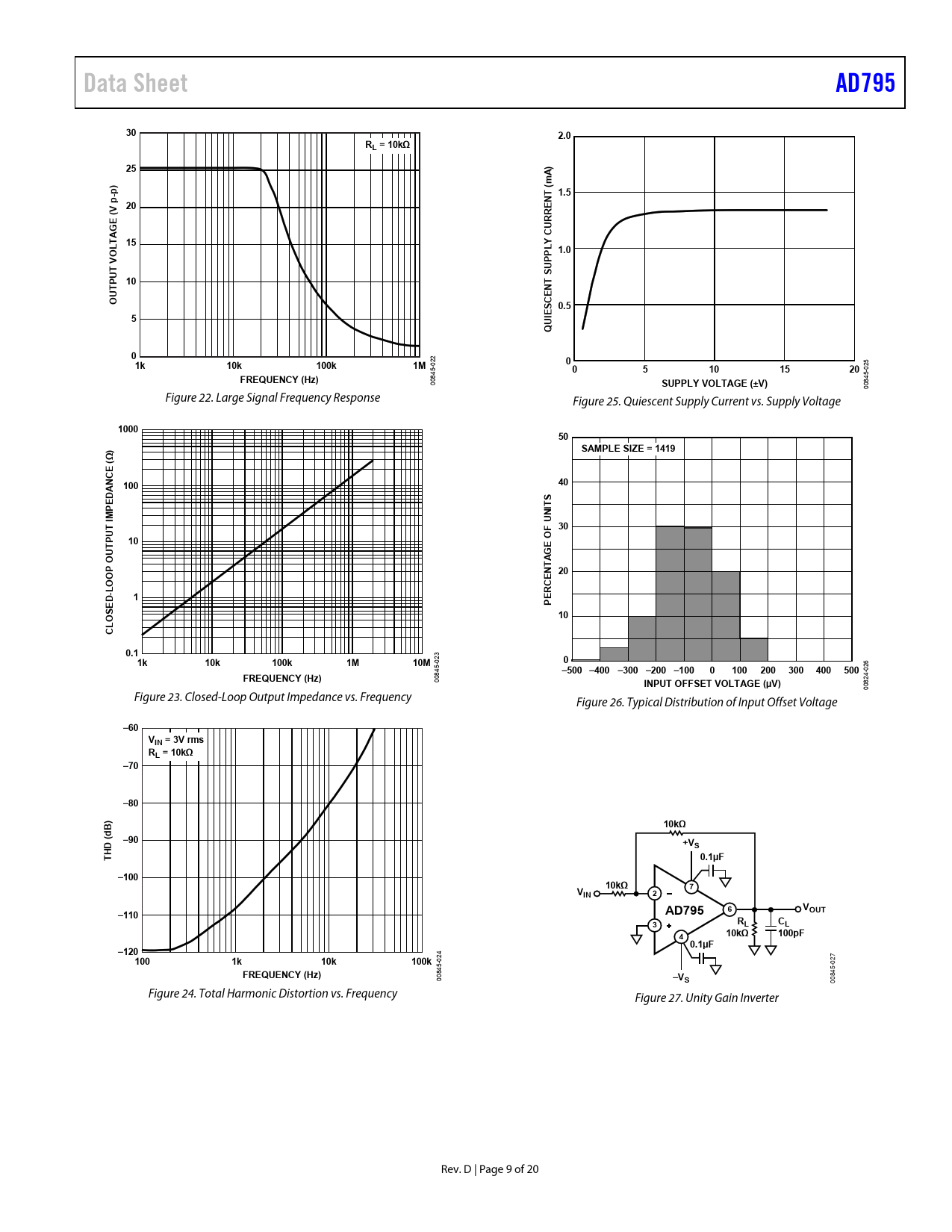

Data Sheet. AD795. 2.0. RL = 10kΩ. ) A. (m T 1.5. p- 20. R R. U C. TA 15. 1.0. T U. SC 0.5. IE U Q. 10k. 100k. FREQUENCY (Hz). SUPPLY VOLTAGE (±V). 1000
Data Sheet AD795 2.0 RL = 10kΩ ) A (m T 1.5 p- 20 R R U C TA 15 1.0 T U SC 0.5 IE U Q 10k 100k FREQUENCY (Hz) SUPPLY VOLTAGE (±V) 1000
Data Sheet AD795 30 2.0 RL = 10kΩ 25 ) A p) (m T 1.5 p- 20 EN (V R R GE U C TA 15 Y L L O 1.0 V PP T U SU 10 T TP EN OU SC 0.5 5 IE U Q 0

84 00 Figure 22. Large Signal Frequency Response Figure 25. Quiescent Supply Current vs. Supply Voltage

82 00 Figure 23. Closed-Loop Output Impedance vs. Frequency Figure 26. Typical Distribution of Input Offset Voltage
–60 VIN = 3V rms RL = 10kΩ –70 –80 B) 10kΩ (d –90 +VS HD T 0.1µF –100 10kΩ 7 V 2 IN 6 VOUT –110 AD795 3 R C L L 4 10kΩ 100pF 0.1µF –120

00 Figure 24. Total Harmonic Distortion vs. Frequency Figure 27. Unity Gain Inverter Rev. D | Page 9 of 20 Document Outline FEATURES APPLICATIONS CONNECTION DIAGRAM GENERAL DESCRIPTION REVISION HISTORY SPECIFICATIONS ABSOLUTE MAXIMUM RATINGS THERMAL RESISTANCE ESD CAUTION TYPICAL PERFORMANCE CHARACTERISTICS MINIMIZING INPUT CURRENT CIRCUIT BOARD NOTES OFFSET NULLING AC RESPONSE WITH HIGH VALUE SOURCE AND FEEDBACK RESISTANCE OVERLOAD ISSUES INPUT PROTECTION PREAMPLIFIER APPLICATIONS MINIMIZING NOISE CONTRIBUTIONS USING A T NETWORK A pH PROBE BUFFER AMPLIFIER OUTLINE DIMENSIONS ORDERING GUIDE
