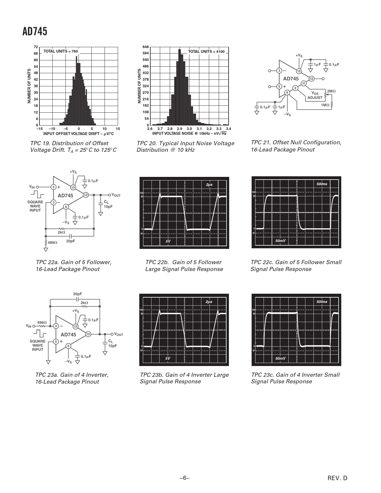

AD745. 648. TOTAL UNITS = 760. TOTAL UNITS = 4100. 594. 540. 486. 432. 378. 324. 270. 216. NUMBER OF UNITS. 162. 108. –15. –10. 2.6. 2.7. 2.8. 2.9. 3.0. 3.1. 3.2. 3.3
AD745 648 TOTAL UNITS = 760 TOTAL UNITS = 4100 594 540 486 432 378 324 270 216 NUMBER OF UNITS 162 108 –15 –10 2.6 2.7 2.8 2.9 3.0 3.1 3.2 3.3
AD745 72 648 TOTAL UNITS = 760 TOTAL UNITS = 4100 66 594 60 540 54 486 48 432 42 378 36 324 30 270 24 216 NUMBER OF UNITS NUMBER OF UNITS 18 162 12 108 6 54 0 0 –15 –10 –5 0 5 10 15 2.6 2.7 2.8 2.9 3.0 3.1 3.2 3.3 3.4 INPUT OFFSET VOLTAGE DRIFT – V/ C INPUT VOLTAGE NOISE @ 10kHz – nV Hz
TPC 19. Distribution of Offset TPC 20. Typical Input Noise Voltage TPC 21. Offset Null Configuration, Voltage Drift. T 16-Lead Package Pinout A = 25°C to 125°C Distribution @ 10 kHz
2µs 500ns 100 100 90 90 10 10 0% 0% 5V 50mV
TPC 22a. Gain of 5 Follower, TPC 22b. Gain of 5 Follower TPC 22c. Gain of 5 Follower Small 16-Lead Package Pinout Large Signal Pulse Response Signal Pulse Response
TPC 23a. Gain of 4 Inverter, TPC 23b. Gain of 4 Inverter Large TPC 23c. Gain of 4 Inverter Small 16-Lead Package Pinout Signal Pulse Response Signal Pulse Response –6– REV. D
