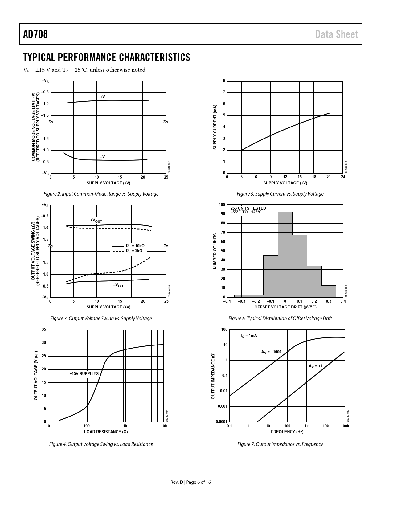

AD708 Data Sheet TYPICAL PERFORMANCE CHARACTERISTICS
VS = ±15 V and TA = 25°C, unless otherwise noted.

Figure 2. Input Common-Mode Range vs. Supply Voltage Figure 5. Supply Current vs. Supply Voltage

Figure 3. Output Voltage Swing vs. Supply Voltage Figure 6. Typical Distribution of Offset Voltage Drift

Figure 4. Output Voltage Swing vs. Load Resistance Figure 7. Output Impedance vs. Frequency Rev. D | Page 6 of 16 Document Outline Features Pin Configuration General Description Product Highlights Revision History Specifications Absolute Maximum Ratings ESD Caution Typical Performance Characteristics Matching Characteristics Theory of Operation Crosstalk Performance Operation with a Gain of −100 High Precision Programmable Gain Amplifier Bridge Signal Conditioner Precision Absolute Value Circuit Selection of Passive Components Outline Dimensions Ordering Guide
