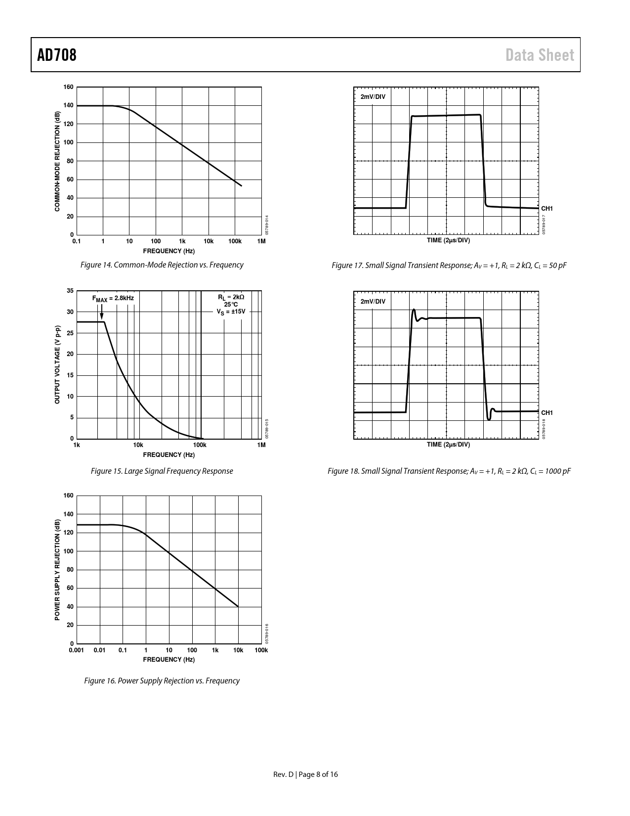

AD708. Data Sheet. 160. 2mV/DIV. 140. B) d 120. N ( IO CT 100 JE. DE O M. N- O M. CH1. 0.1. 100. 10k. 100k. TIME (2µs/DIV). FREQUENCY (Hz)

Figure 14. Common-Mode Rejection vs. Frequency Figure 17. Small Signal Transient Response; AV = +1, RL = 2 kΩ, CL = 50 pF

Figure 15. Large Signal Frequency Response Figure 18. Small Signal Transient Response; AV = +1, RL = 2 kΩ, CL = 1000 pF

0.001 0.01 0.1 1 10 100 1k 10k 100k FREQUENCY (Hz)
