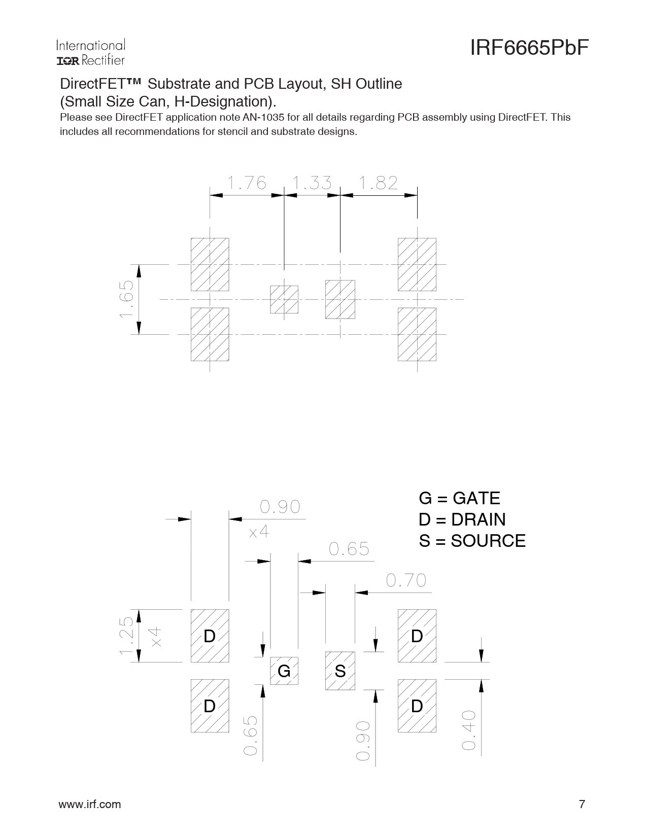

IRF6665PbF. DirectFET™Substrate. and. PCB. Layout,. SH. Outline. (Small. Size. Can,. H-Designation). Please. see. DirectFET. application. note. AN-1035
IRF6665PbF DirectFET™Substrate and PCB Layout, SH Outline (Small Size Can, H-Designation) Please see DirectFET application note AN-1035
Substrate and PCB Layout, SH Outline (Small Size Can, H-Designation). Please see DirectFET application note AN-1035 for all details regarding PCB assembly using DirectFET. This includes all recommendations for stencil and substrate designs. G = GATE D = DRAIN S = SOURCE D D G S D D www.irf.com 7
