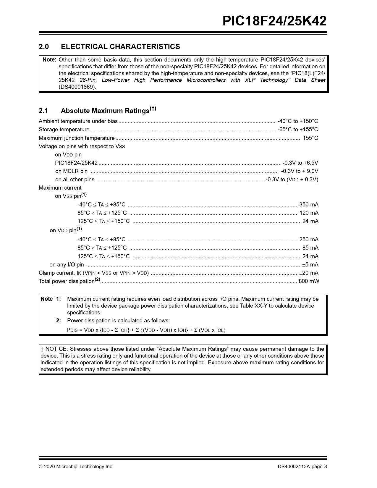

Other than some basic data, this section documents only the high-temperature PIC18F24/25K42 devices’ specifications that differ from those of the non-specialty PIC18F24/25K42 devices. For detailed information on the electrical specifications shared by the high-temperature and non-specialty devices, see the “PIC18(L)F24/ 25K42 28-Pin, Low-Power High Performance Microcontrollers with XLP Technology” Data Sheet (DS40001869).
2.1 Absolute Maximum Ratings(†)
Ambient temperature under bias .. -40°C to +150°C Storage temperature .. -65°C to +155°C Maximum junction temperature .. 155°C Voltage on pins with respect to VSS on VDD pin PIC18F24/25K42 ... -0.3V to +6.5V on MCLR pin .. -0.3V to + 9.0V on all other pins .. -0.3V to (VDD + 0.3V) Maximum current on VSS pin
(1)
-40°C  TA  +85°C .. 350 mA 85°C  TA  +125°C ... 120 mA 125°C  TA  +150°C ... 24 mA on VDD pin
(1)
-40°C  TA  +85°C .. 250 mA 85°C  TA  +125°C ... 85 mA 125°C  TA  +150°C ... 24 mA on any I/O pin ... 5 mA Clamp current, IK (VPIN < VSS or VPIN > VDD) ... 20 mA Total power dissipation
(2)
.. 800 mW
Note 1:
Maximum current rating requires even load distribution across I/O pins. Maximum current rating may be limited by the device package power dissipation characterizations, see Table XX-Y to calculate device specifications.
2:
Power dissipation is calculated as follows: PDIS = VDD x {IDD - IOH} + VDD - VOH) x IOH} + VOL x IOL † NOTICE: Stresses above those listed under “Absolute Maximum Ratings” may cause permanent damage to the device. This is a stress rating only and functional operation of the device at those or any other conditions above those indicated in the operation listings of this specification is not implied. Exposure above maximum rating conditions for extended periods may affect device reliability.  2020 Microchip Technology Inc. DS40002113A-page 8 Document Outline Description Family Types Table of Contents 1.0 Device Overview 2.0 Electrical Characteristics TABLE 2-1: Supply Voltage (High Temperature) FIGURE 2-1: Voltage-Frequency Graph, -40°C £ Ta £ +150°C TABLE 2-2: DC Characteristics: Supply Current (Idd)(1,2) TABLE 2-3: DC Characteristics: Power-Down Currents (Ipd)(1,2,3) TABLE 2-4: Memory Specifications (150°C) TABLE 2-5: Internal Oscillator Parameters(1) FIGURE 3-2: Precision-Calibrated HFINTOSC Frequency Accuracy Over Device Vdd and Temperature TABLE 2-6: Reset, Watchdog Timer, Oscillator Start-up Timer, Power-up Timer, Brown-out Timer and Low-Power Brown-out Reset Specifications TABLE 2-7: High/Low-Voltage Detect Characteristics TABLE 2-8: Fixed Voltage Reference (FVR) Specifications Appendix A: Revision History Product ID System Trademarks Worldwide Sales
