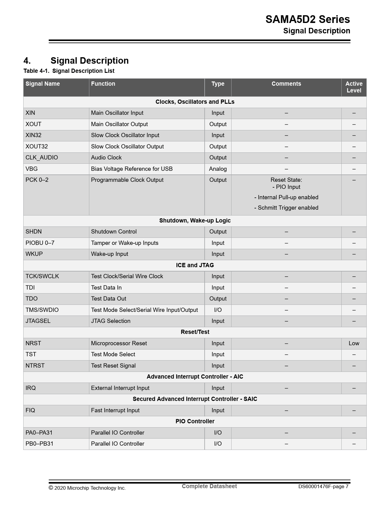

SAMA5D2 Series. Signal Description. Table 4-1. Signal Description List. Signal Name. Function. Type. Comments. Active. Level
SAMA5D2 Series Signal Description Table 4-1. Signal Description List Signal Name Function Type Comments Active Level
SAMA5D2 Series Signal Description 4. Signal Description Table 4-1. Signal Description List Signal Name Function Type Comments Active Level Clocks, Oscillators and PLLs
XIN Main Oscillator Input Input – – XOUT Main Oscillator Output Output – – XIN32 Slow Clock Oscillator Input Input – – XOUT32 Slow Clock Oscillator Output Output – – CLK_AUDIO Audio Clock Output – – VBG Bias Voltage Reference for USB Analog – – PCK 0–2 Programmable Clock Output Output Reset State: – - PIO Input - Internal Pull-up enabled - Schmitt Trigger enabled
Shutdown, Wake-up Logic
SHDN Shutdown Control Output – – PIOBU 0–7 Tamper or Wake-up Inputs Input – – WKUP Wake-up Input Input – –
ICE and JTAG
TCK/SWCLK Test Clock/Serial Wire Clock Input – – TDI Test Data In Input – – TDO Test Data Out Output – – TMS/SWDIO Test Mode Select/Serial Wire Input/Output I/O – – JTAGSEL JTAG Selection Input – –
Reset/Test
NRST Microprocessor Reset Input – Low TST Test Mode Select Input – – NTRST Test Reset Signal Input – –
Advanced Interrupt Controller - AIC
IRQ External Interrupt Input Input – –
Secured Advanced Interrupt Controller - SAIC
FIQ Fast Interrupt Input Input – –
PIO Controller
PA0–PA31 Parallel IO Controller I/O – – PB0–PB31 Parallel IO Controller I/O – – © 2020 Microchip Technology Inc.
