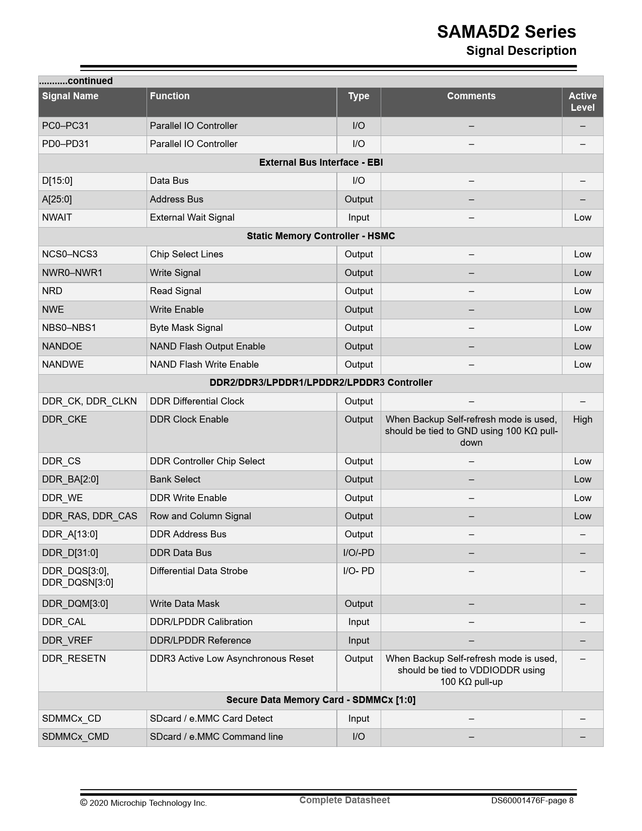

SAMA5D2 Series. Signal Description. ...continued. Signal Name. Function. Type. Comments. Active. Level. External Bus Interface - EBI
SAMA5D2 Series Signal Description ...continued Signal Name Function Type Comments Active Level External Bus Interface - EBI
PC0–PC31 Parallel IO Controller I/O – – PD0–PD31 Parallel IO Controller I/O – –
D[15:0] Data Bus I/O – – A[25:0] Address Bus Output – – NWAIT External Wait Signal Input – Low
Static Memory Controller - HSMC
NCS0–NCS3 Chip Select Lines Output – Low NWR0–NWR1 Write Signal Output – Low NRD Read Signal Output – Low NWE Write Enable Output – Low NBS0–NBS1 Byte Mask Signal Output – Low NANDOE NAND Flash Output Enable Output – Low NANDWE NAND Flash Write Enable Output – Low
DDR2/DDR3/LPDDR1/LPDDR2/LPDDR3 Controller
DDR_CK, DDR_CLKN DDR Differential Clock Output – – DDR_CKE DDR Clock Enable Output When Backup Self-refresh mode is used, High should be tied to GND using 100 KΩ pull- down DDR_CS DDR Controller Chip Select Output – Low DDR_BA[2:0] Bank Select Output – Low DDR_WE DDR Write Enable Output – Low DDR_RAS, DDR_CAS Row and Column Signal Output – Low DDR_A[13:0] DDR Address Bus Output – – DDR_D[31:0] DDR Data Bus I/O/-PD – – DDR_DQS[3:0], Differential Data Strobe I/O- PD – – DDR_DQSN[3:0] DDR_DQM[3:0] Write Data Mask Output – – DDR_CAL DDR/LPDDR Calibration Input – – DDR_VREF DDR/LPDDR Reference Input – – DDR_RESETN DDR3 Active Low Asynchronous Reset Output When Backup Self-refresh mode is used, – should be tied to VDDIODDR using 100 KΩ pull-up
Secure Data Memory Card - SDMMCx [1:0]
SDMMCx_CD SDcard / e.MMC Card Detect Input – – SDMMCx_CMD SDcard / e.MMC Command line I/O – – © 2020 Microchip Technology Inc.
