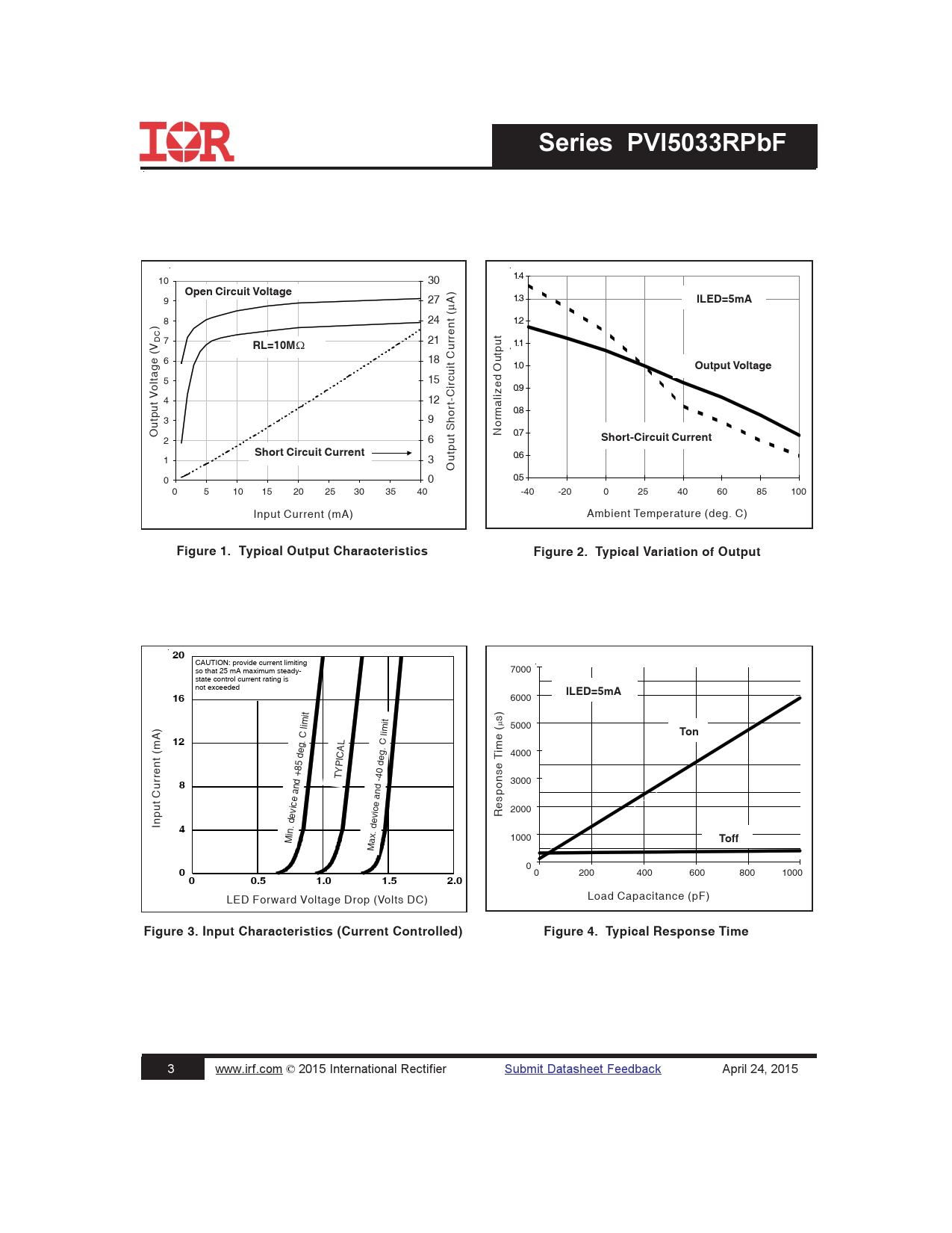

Series PVI5033RPbF. Open Circuit Voltage. ILED=5mA. RL=10M. Output Voltage. Short-Circuit Current. Short Circuit Current
Series PVI5033RPbF Open Circuit Voltage ILED=5mA RL=10M Output Voltage Short-Circuit Current Short Circuit Current
Series PVI5033RPbF
1.4 10 30
9 27 A) 1.3
ILED=5mA
μ 8 24 1.2 ) DC 7 21 1.1
RL=10M
W
p
6 18 1.0
Output Voltage
5 15 oltage (V 0.9 4 12 0.8 3 9 Output V Normalized Output 0.7
2 6
0.6 1 3 Output Short-Circuit Current ( 0.5 0 0 0 5 10 15 20 25 30 35 40 -40 -20 0 25 40 60 85 100 Input Current (mA) Ambient Temperature (deg. C)
Figure 1. Typical Output Characteristics Figure 2. Typical Variation of Output 20
CAUTION: provide current limiting so that 25 mA maximum steady- 7000 state control current rating is not exceeded
ILED=5mA 16
6000 s) (μ 5000
Ton 12
ime 4000 TYPICAL
8
3000 Response T 2000 Input Current (mA)
4
1000 Min. device and +85 deg. C limit
Toff
Max. device and -40 deg. C limit 0
0
0 200 400 600 800 1000
0 0.5 1.0 1.5 2.0
LED Forward Voltage Drop (Volts DC) Load Capacitance (pF)
Figure 3. Input Characteristics (Current Controlled) Figure 4. Typical Response Time
