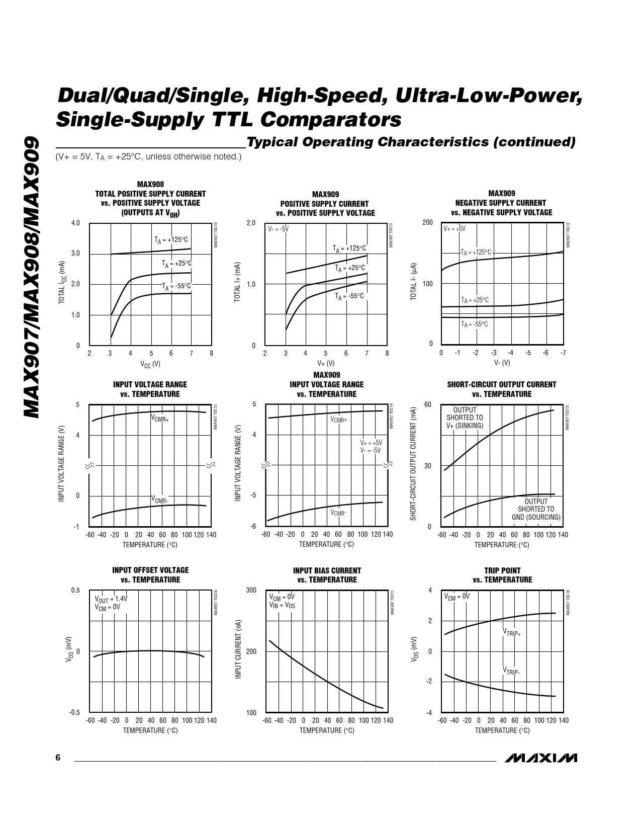

Dual/Quad/Single, High-Speed, Ultra-Low-Power, Single-Supply TTL Comparators Typical Operating Characteristics (continued)
(V+ = 5V, TA = +25°C, unless otherwise noted.)
MAX908 TOTAL POSITIVE SUPPLY CURRENT MAX909 MAX909 vs. POSITIVE SUPPLY VOLTAGE POSITIVE SUPPLY CURRENT NEGATIVE SUPPLY CURRENT (OUTPUTS AT VOH) vs. POSITIVE SUPPLY VOLTAGE vs. NEGATIVE SUPPLY VOLTAGE
4.0 2.0 200 V- = -5V V+ = +5V TA = +125°C MAX907 TOC10 T MAX907 TOC11 MAX907 TOC12 3.0 A = +125°C TA = +125°C TA = +25°C TA = +25°C µA) (mA) CC 2.0 T 1.0 100 A = -55°C T TOTAL I- ( TOTAL I TOTAL I+ (mA) A = -55°C TA = +25°C 1.0 TA = -55°C 0 0 0 2 3 4 5 6 7 8 2 3 4 5 6 7 8 0 -1 -2 -3 -4 -5 -6 -7 V V+ (V) V- (V) CC (V)
MAX909 INPUT VOLTAGE RANGE INPUT VOLTAGE RANGE SHORT-CIRCUIT OUTPUT CURRENT vs. TEMPERATURE vs. TEMPERATURE vs. TEMPERATURE
5 5 60
MAX907/MAX908/MAX909
OUTPUT VCMR+ V SHORTED TO CMR+ MAX907 TOC14 V+ (SINKING) MAX907 TOC13 MAX907 TOC15 4 4 V+ = +5V V- = -5V 30 0 -5 INPUT VOLTAGE RANGE (V) VCMR- INPUT VOLTAGE RANGE (V) OUTPUT SHORTED TO VCMR- SHORT-CIRCUIT OUTPUT CURRENT (mA) GND (SOURCING) -1 -6 0 -60 -40 -20 0 20 40 60 80 100 120 140 -60 -40 -20 0 20 40 60 80 100 120 140 -60 -40 -20 0 20 40 60 80 100 120 140 TEMPERATURE (°C) TEMPERATURE (°C) TEMPERATURE (°C)
INPUT OFFSET VOLTAGE INPUT BIAS CURRENT TRIP POINT vs. TEMPERATURE vs. TEMPERATURE vs. TEMPERATURE
0.5 300 4 V V V OUT = 1.4V CM = 0V CM = 0V V VIN = VOS CM = 0V MAX907 TOC16 MAX907 TOC17 MAX907 TOC18 2 VTRIP+ (mV) 0 (mV) 200 0 OS OS V V VTRIP- INPUT CURRENT (nA) -2 -0.5 100 -4 -60 -40 -20 0 20 40 60 80 100 120 140 -60 -40 -20 0 20 40 60 80 100 120 140 -60 -40 -20 0 20 40 60 80 100 120 140 TEMPERATURE (°C) TEMPERATURE (°C) TEMPERATURE (°C)
