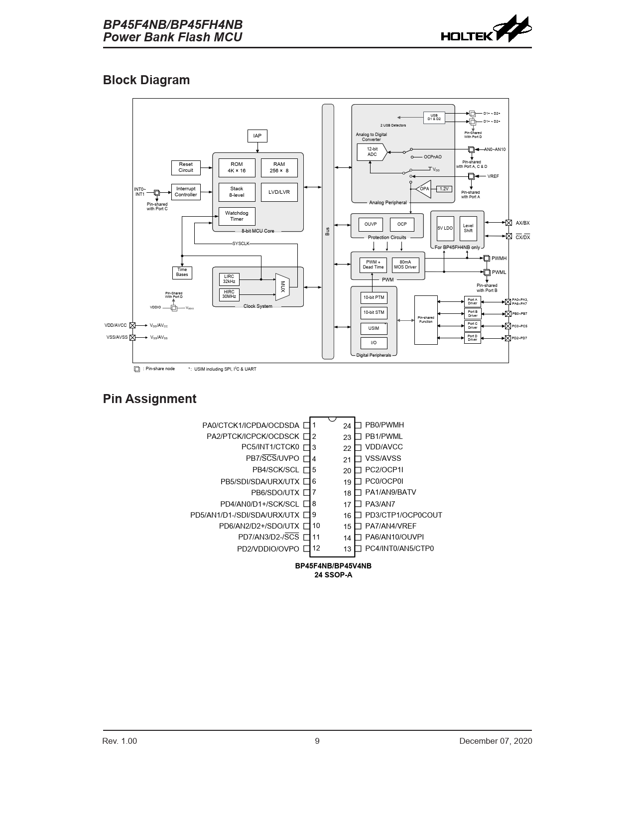

BP45F4NB/BP45FH4NB BP45F4NB/BP45FH4NB Power Bank Flash MCU Power Bank Flash MCU Block Diagram
D1+ ~ D2+ USB D1 & D2 D1+ ~ D2+ 2 USB Detectors Analog to Digital IAP Pin-Shared Converter With Port D 12-bit AN0~AN10 ADC OCPnAO Reset ROM RAM Pin-shared with Port A, C & D Circuit 4K × 16 256 × 8 VDD VREF INT0~ Interrupt Stack OPA 1.2V INT1 Controller Pin-shared 8-level LVD/LVR with Port A Pin-shared Analog Peripheral with Port C Watchdog Timer OUVP OCP AX/BX Level 8-bit MCU Core s 5V LDO Bu Shift Protection Circuits CX/DX SYSCLK For BP45FH4NB only PWMH PWM + 80mA Dead Time MOS Driver Time PWML Bases LIRC 32kHz MUX PWM Pin-shared Pin-Shared HIRC with Port B With Port D 30MHz 10-bit PTM Port A PA0~PA3, Driver PA6~PA7 VDDIO V Clock System DDIO 10-bit STM Port B PB0~PB7 Driver Pin-shared Function Port C VDD/AVCC VDD/AVCC * PC0~PC5 Driver USIM VSS/AVSS V Port D SS/AVSS PD2~PD7 Driver I/O Digital Peripherals :Pin-share node *:USIM including SPI, I2C & UART
Pin Assignment
PA0/CTCK1/ICPDA/OCDSDA 1 24 PB0/PWMH PA2/PTCK/ICPCK/OCDSCK 2 23 PB1/PWML PC5/INT1/CTCK0 3 22 VDD/AVCC PB7/SCS/UVPO 4 21 VSS/AVSS PB4/SCK/SCL 5 20 PC2/OCP1I PB5/SDI/SDA/URX/UTX 6 19 PC0/OCP0I PB6/SDO/UTX 7 18 PA1/AN9/BATV PD4/AN0/D1+/SCK/SCL 8 17 PA3/AN7 PD5/AN1/D1-/SDI/SDA/URX/UTX 9 16 PD3/CTP1/OCP0COUT PD6/AN2/D2+/SDO/UTX 10 15 PA7/AN4/VREF PD7/AN3/D2-/SCS 11 14 PA6/AN10/OUVPI PD2/VDDIO/OVPO 12 13 PC4/INT0/AN5/CTP0
