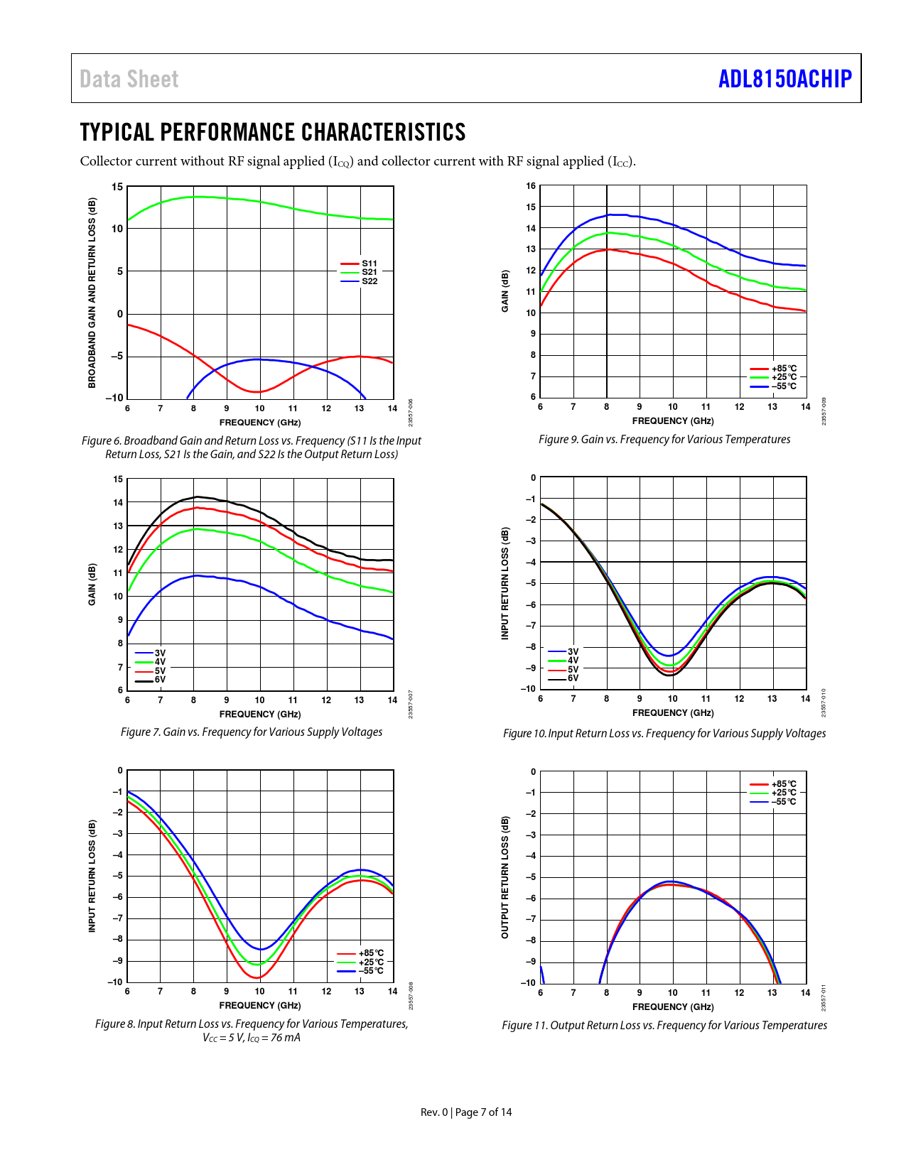

Data Sheet. ADL8150ACHIP. TYPICAL PERFORMANCE CHARACTERISTICS. B) d. ( S S. URN L T. S11. S21. S22. d N (. AND RE. ADBAND G. +85°C. +25°C. BRO. –55°C

Collector current without RF signal applied (ICQ) and collector current with RF signal applied (ICC).
15 16 B) d 15 ( S S 10 14 O 13 URN L T S11 5 S21 12 B) S22 d N ( 11 AND RE AI N 0 G 10 AI 9 –5 8 ADBAND G +85°C 7 +25°C BRO –55°C –10 6 6 7 8 9 10 11 12 13 14

FREQUENCY (GHz) FREQUENCY (GHz)
23557- 23557- Figure 6. Broadband Gain and Return Loss vs. Frequency (S11 Is the Input Figure 9. Gain vs. Frequency for Various Temperatures Return Loss, S21 Is the Gain, and S22 Is the Output Return Loss)
15 0 14 –1 –2 13 B) d ( –3 12 S S O –4 B) d 11 N ( –5 URN L AI 10 T G –6 RE 9 UT –7 INP 8 –8 3V 3V 4V 4V 7 5V –9 5V 6V 6V 6 –10 6 7 8 9 10 11 12 13 14
23557- 23557- Figure 7. Gain vs. Frequency for Various Supply Voltages Figure 10. Input Return Loss vs. Frequency for Various Supply Voltages
0 0 +85°C –1 –1 +25°C –55°C –2 –2 B) B) d d ( –3 ( –3 S S S S O –4 O –4 –5 –5 URN L URN L T T –6 –6 RE RE UT UT –7 P –7 INP UT –8 O –8 +85°C –9 +25°C –9 –55°C –10 –10

FREQUENCY (GHz)
23557-
FREQUENCY (GHz)
23557- Figure 8. Input Return Loss vs. Frequency for Various Temperatures, Figure 11. Output Return Loss vs. Frequency for Various Temperatures VCC = 5 V, ICQ = 76 mA Rev. 0 | Page 7 of 14 Document Outline Features Applications Functional Block Diagram General Description Revision History Specifications Frequency Range: 6 GHz to 7 GHz Frequency Range: 7 GHz to 11 GHz Frequency Range: 11 GHz to 14 GHz Absolute Maximum Ratings Thermal Resistance Electrostatic Discharge (ESD) Ratings ESD Ratings for ADL8150ACHIP ESD Caution Pin Configuration and Function Descriptions Interface Schematics Typical Performance Characteristics Theory of Operation Applications Information Biasing Procedures Handling Precautions Mounting Wire Bonding Assembly and Typical Application Circuit Diagrams Outline Dimensions Ordering Guide
