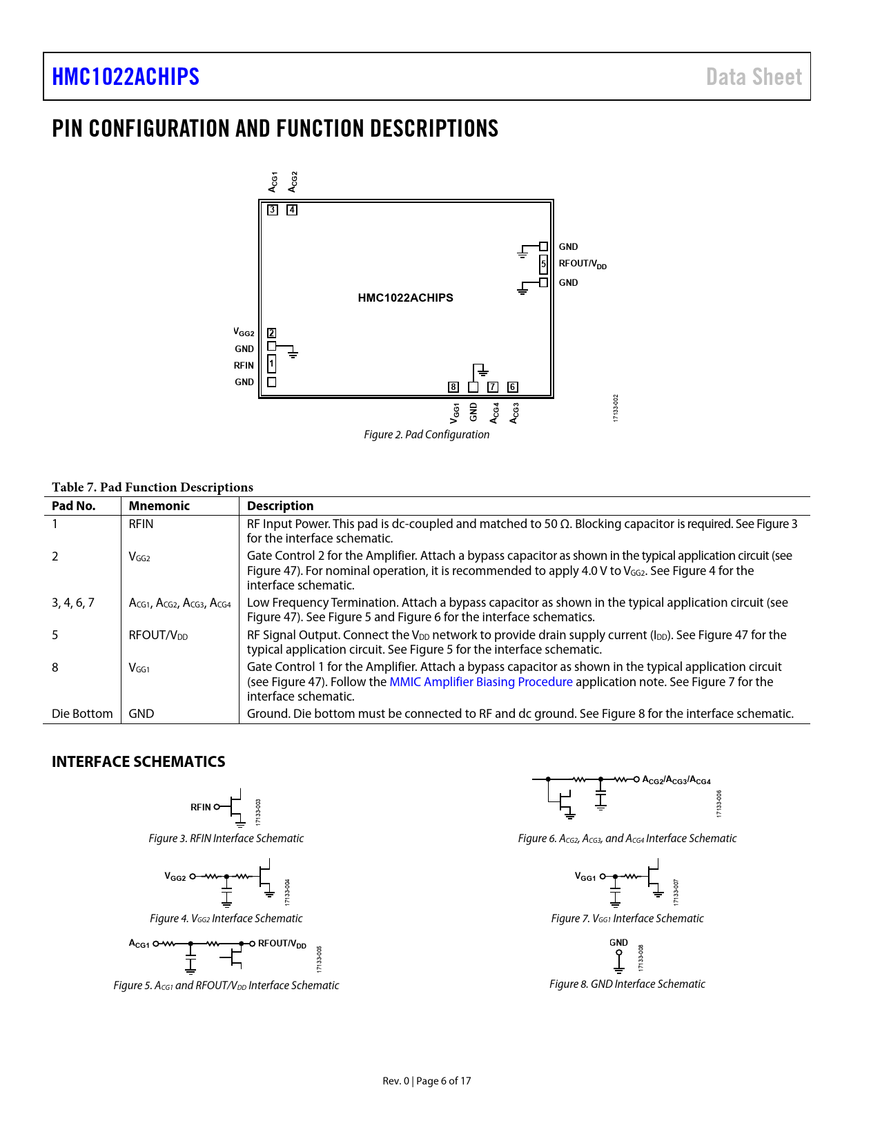

HMC1022ACHIPS Data Sheet PIN CONFIGURATION AND FUNCTION DESCRIPTIONS 1 2 CG CG A A 3 4 GND 5 RFOUT/VDD GND HMC1022ACHIPS VGG2 2 GND 1 RFIN GND 8 7 6 4 3 D
002 3-
GG1 CG CG V GN A A
1713 Figure 2. Pad Configuration
Table 7. Pad Function Descriptions Pad No. Mnemonic Description
1 RFIN RF Input Power. This pad is dc-coupled and matched to 50 Ω. Blocking capacitor is required. See Figure 3 for the interface schematic. 2 VGG2 Gate Control 2 for the Amplifier. Attach a bypass capacitor as shown in the typical application circuit (see Figure 47). For nominal operation, it is recommended to apply 4.0 V to VGG2. See Figure 4 for the interface schematic. 3, 4, 6, 7 ACG1, ACG2, ACG3, ACG4 Low Frequency Termination. Attach a bypass capacitor as shown in the typical application circuit (see Figure 47). See Figure 5 and Figure 6 for the interface schematics. 5 RFOUT/VDD RF Signal Output. Connect the VDD network to provide drain supply current (IDD). See Figure 47 for the typical application circuit. See Figure 5 for the interface schematic. 8 VGG1 Gate Control 1 for the Amplifier. Attach a bypass capacitor as shown in the typical application circuit (see Figure 47). Follow the MMIC Amplifier Biasing Procedure application note. See Figure 7 for the interface schematic. Die Bottom GND Ground. Die bottom must be connected to RF and dc ground. See Figure 8 for the interface schematic.
INTERFACE SCHEMATICS ACG2/ACG3/ACG4
6 3 -00
RFIN
-00 133 33 17 171 Figure 3. RFIN Interface Schematic Figure 6. ACG2, ACG3, and ACG4 Interface Schematic
VGG2 V
4
GG1
7 -00 -00 33 33 171 171 Figure 4. VGG2 Interface Schematic Figure 7. VGG1 Interface Schematic
ACG1 RFOUT/VDD GND
08 005 0 3- 3- 13 13 17 17 Figure 5. ACG1 and RFOUT/VDD Interface Schematic Figure 8. GND Interface Schematic Rev. 0 | Page 6 of 17 Document Outline Features Applications Functional Block Diagram General Description Revision History Electrical Specifications DC to 30 GHz Frequency Range 30 GHz to 40 GHz Frequency Range 40 GHz to 48 GHz Frequency Range Absolute Maximum Ratings Thermal Resistance ESD Caution Pin Configuration and Function Descriptions Interface Schematics Typical Performance Characteristics Theory of Operation Applications Information Biasing Procedures Mounting and Bonding Techniques for Millimeterwave GaAs MMICs Handling Precautions Mounting Wire Bonding Outline Dimensions Ordering Guide
