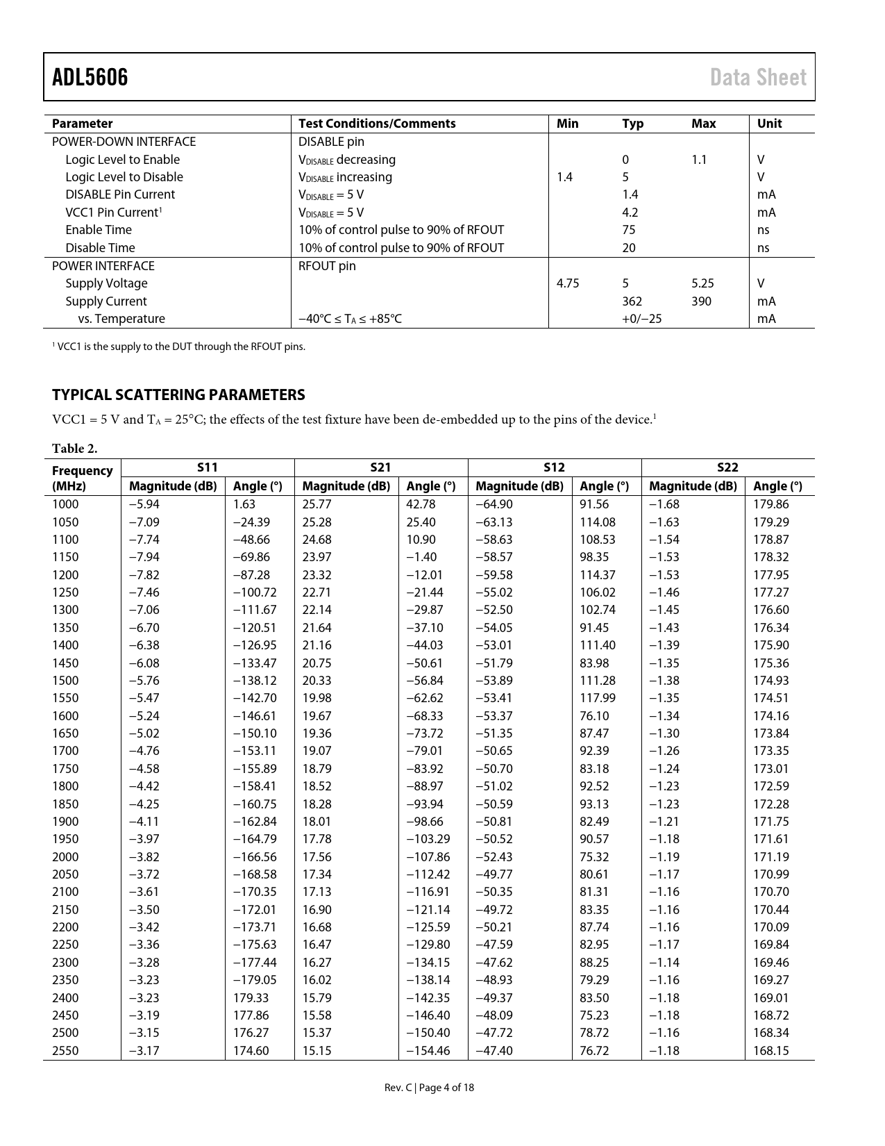

ADL5606. Data Sheet. Parameter Test. Conditions/Comments. Min. Typ. Max. Unit. TYPICAL SCATTERING PARAMETERS. Table 2. Frequency
ADL5606 Data Sheet Parameter Test Conditions/Comments Min Typ Max Unit TYPICAL SCATTERING PARAMETERS Table 2 Frequency
link to page 5
POWER-DOWN INTERFACE DISABLE pin Logic Level to Enable VDISABLE decreasing 0 1.1 V Logic Level to Disable VDISABLE increasing 1.4 5 V DISABLE Pin Current VDISABLE = 5 V 1.4 mA VCC1 Pin Current1 VDISABLE = 5 V 4.2 mA Enable Time 10% of control pulse to 90% of RFOUT 75 ns Disable Time 10% of control pulse to 90% of RFOUT 20 ns POWER INTERFACE RFOUT pin Supply Voltage 4.75 5 5.25 V Supply Current 362 390 mA vs. Temperature −40°C ≤ TA ≤ +85°C +0/−25 mA 1 VCC1 is the supply to the DUT through the RFOUT pins.
VCC1 = 5 V and TA = 25C; the effects of the test fixture have been de-embedded up to the pins of the device.1
Table 2. Frequency S11 S21 S12 S22 (MHz) Magnitude (dB) Angle (°) Magnitude (dB) Angle (°) Magnitude (dB) Angle (°) Magnitude (dB) Angle (°)
1000 −5.94 1.63 25.77 42.78 −64.90 91.56 −1.68 179.86 1050 −7.09 −24.39 25.28 25.40 −63.13 114.08 −1.63 179.29 1100 −7.74 −48.66 24.68 10.90 −58.63 108.53 −1.54 178.87 1150 −7.94 −69.86 23.97 −1.40 −58.57 98.35 −1.53 178.32 1200 −7.82 −87.28 23.32 −12.01 −59.58 114.37 −1.53 177.95 1250 −7.46 −100.72 22.71 −21.44 −55.02 106.02 −1.46 177.27 1300 −7.06 −111.67 22.14 −29.87 −52.50 102.74 −1.45 176.60 1350 −6.70 −120.51 21.64 −37.10 −54.05 91.45 −1.43 176.34 1400 −6.38 −126.95 21.16 −44.03 −53.01 111.40 −1.39 175.90 1450 −6.08 −133.47 20.75 −50.61 −51.79 83.98 −1.35 175.36 1500 −5.76 −138.12 20.33 −56.84 −53.89 111.28 −1.38 174.93 1550 −5.47 −142.70 19.98 −62.62 −53.41 117.99 −1.35 174.51 1600 −5.24 −146.61 19.67 −68.33 −53.37 76.10 −1.34 174.16 1650 −5.02 −150.10 19.36 −73.72 −51.35 87.47 −1.30 173.84 1700 −4.76 −153.11 19.07 −79.01 −50.65 92.39 −1.26 173.35 1750 −4.58 −155.89 18.79 −83.92 −50.70 83.18 −1.24 173.01 1800 −4.42 −158.41 18.52 −88.97 −51.02 92.52 −1.23 172.59 1850 −4.25 −160.75 18.28 −93.94 −50.59 93.13 −1.23 172.28 1900 −4.11 −162.84 18.01 −98.66 −50.81 82.49 −1.21 171.75 1950 −3.97 −164.79 17.78 −103.29 −50.52 90.57 −1.18 171.61 2000 −3.82 −166.56 17.56 −107.86 −52.43 75.32 −1.19 171.19 2050 −3.72 −168.58 17.34 −112.42 −49.77 80.61 −1.17 170.99 2100 −3.61 −170.35 17.13 −116.91 −50.35 81.31 −1.16 170.70 2150 −3.50 −172.01 16.90 −121.14 −49.72 83.35 −1.16 170.44 2200 −3.42 −173.71 16.68 −125.59 −50.21 87.74 −1.16 170.09 2250 −3.36 −175.63 16.47 −129.80 −47.59 82.95 −1.17 169.84 2300 −3.28 −177.44 16.27 −134.15 −47.62 88.25 −1.14 169.46 2350 −3.23 −179.05 16.02 −138.14 −48.93 79.29 −1.16 169.27 2400 −3.23 179.33 15.79 −142.35 −49.37 83.50 −1.18 169.01 2450 −3.19 177.86 15.58 −146.40 −48.09 75.23 −1.18 168.72 2500 −3.15 176.27 15.37 −150.40 −47.72 78.72 −1.16 168.34 2550 −3.17 174.60 15.15 −154.46 −47.40 76.72 −1.18 168.15 Rev. C | Page 4 of 18 Document Outline FEATURES APPLICATIONS GENERAL DESCRIPTION FUNCTIONAL BLOCK DIAGRAM TABLE OF CONTENTS REVISION HISTORY SPECIFICATIONS TYPICAL SCATTERING PARAMETERS ABSOLUTE MAXIMUM RATINGS THERMAL RESISTANCE ESD CAUTION PIN CONFIGURATION AND FUNCTION DESCRIPTIONS TYPICAL PERFORMANCE CHARACTERISTICS 1960 MHZ FREQUENCY TUNING BAND 2140 MHZ FREQUENCY TUNING BAND 2630 MHZ FREQUENCY TUNING BAND GENERAL APPLICATIONS INFORMATION BASIC LAYOUT CONNECTIONS Power Supply RF Input Interface RF Output Interface Power-Down ADL5606 MATCHING ACPR AND EVM THERMAL CONSIDERATIONS SOLDERING INFORMATION AND RECOMMENDED PCB LAND PATTERN EVALUATION BOARD OUTLINE DIMENSIONS ORDERING GUIDE
