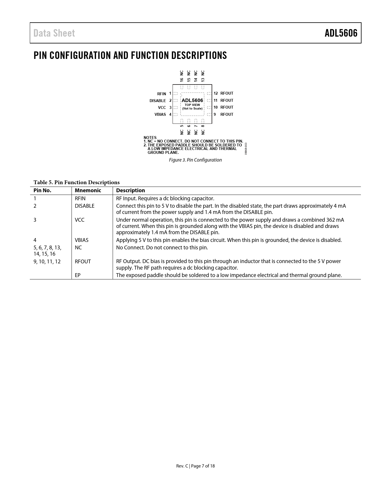

Data Sheet. ADL5606. PIN CONFIGURATION AND FUNCTION DESCRIPTIONS. RFIN 1. 12 RFOUT. DISABLE 2. 11 RFOUT. TOP VIEW. VCC 3. 10 RFOUT
Data Sheet ADL5606 PIN CONFIGURATION AND FUNCTION DESCRIPTIONS RFIN 1 12 RFOUT DISABLE 2 11 RFOUT TOP VIEW VCC 3 10 RFOUT
Data Sheet ADL5606 PIN CONFIGURATION AND FUNCTION DESCRIPTIONS C C C C N N N N 61 51 41 31 RFIN 1 12 RFOUT DISABLE 2 ADL5606 11 RFOUT TOP VIEW VCC 3 10 RFOUT (Not to Scale) VBIAS 4 9 RFOUT 5 6 7 8 C C C C N N N N NOTES 1. NC = NO CONNECT. DO NOT CONNECT TO THIS PIN.
3
2. THE EXPOSED PADDLE SHOULD BE SOLDERED TO
00 8-
A LOW IMPEDANCE ELECTRICAL AND THERMAL GROUND PLANE.
0996 Figure 3. Pin Configuration
Table 5. Pin Function Descriptions Pin No. Mnemonic Description
1 RFIN RF Input. Requires a dc blocking capacitor. 2 DISABLE Connect this pin to 5 V to disable the part. In the disabled state, the part draws approximately 4 mA of current from the power supply and 1.4 mA from the DISABLE pin. 3 VCC Under normal operation, this pin is connected to the power supply and draws a combined 362 mA of current. When this pin is grounded along with the VBIAS pin, the device is disabled and draws approximately 1.4 mA from the DISABLE pin. 4 VBIAS Applying 5 V to this pin enables the bias circuit. When this pin is grounded, the device is disabled. 5, 6, 7, 8, 13, NC No Connect. Do not connect to this pin. 14, 15, 16 9, 10, 11, 12 RFOUT RF Output. DC bias is provided to this pin through an inductor that is connected to the 5 V power supply. The RF path requires a dc blocking capacitor. EP The exposed paddle should be soldered to a low impedance electrical and thermal ground plane. Rev. C | Page 7 of 18 Document Outline FEATURES APPLICATIONS GENERAL DESCRIPTION FUNCTIONAL BLOCK DIAGRAM TABLE OF CONTENTS REVISION HISTORY SPECIFICATIONS TYPICAL SCATTERING PARAMETERS ABSOLUTE MAXIMUM RATINGS THERMAL RESISTANCE ESD CAUTION PIN CONFIGURATION AND FUNCTION DESCRIPTIONS TYPICAL PERFORMANCE CHARACTERISTICS 1960 MHZ FREQUENCY TUNING BAND 2140 MHZ FREQUENCY TUNING BAND 2630 MHZ FREQUENCY TUNING BAND GENERAL APPLICATIONS INFORMATION BASIC LAYOUT CONNECTIONS Power Supply RF Input Interface RF Output Interface Power-Down ADL5606 MATCHING ACPR AND EVM THERMAL CONSIDERATIONS SOLDERING INFORMATION AND RECOMMENDED PCB LAND PATTERN EVALUATION BOARD OUTLINE DIMENSIONS ORDERING GUIDE
