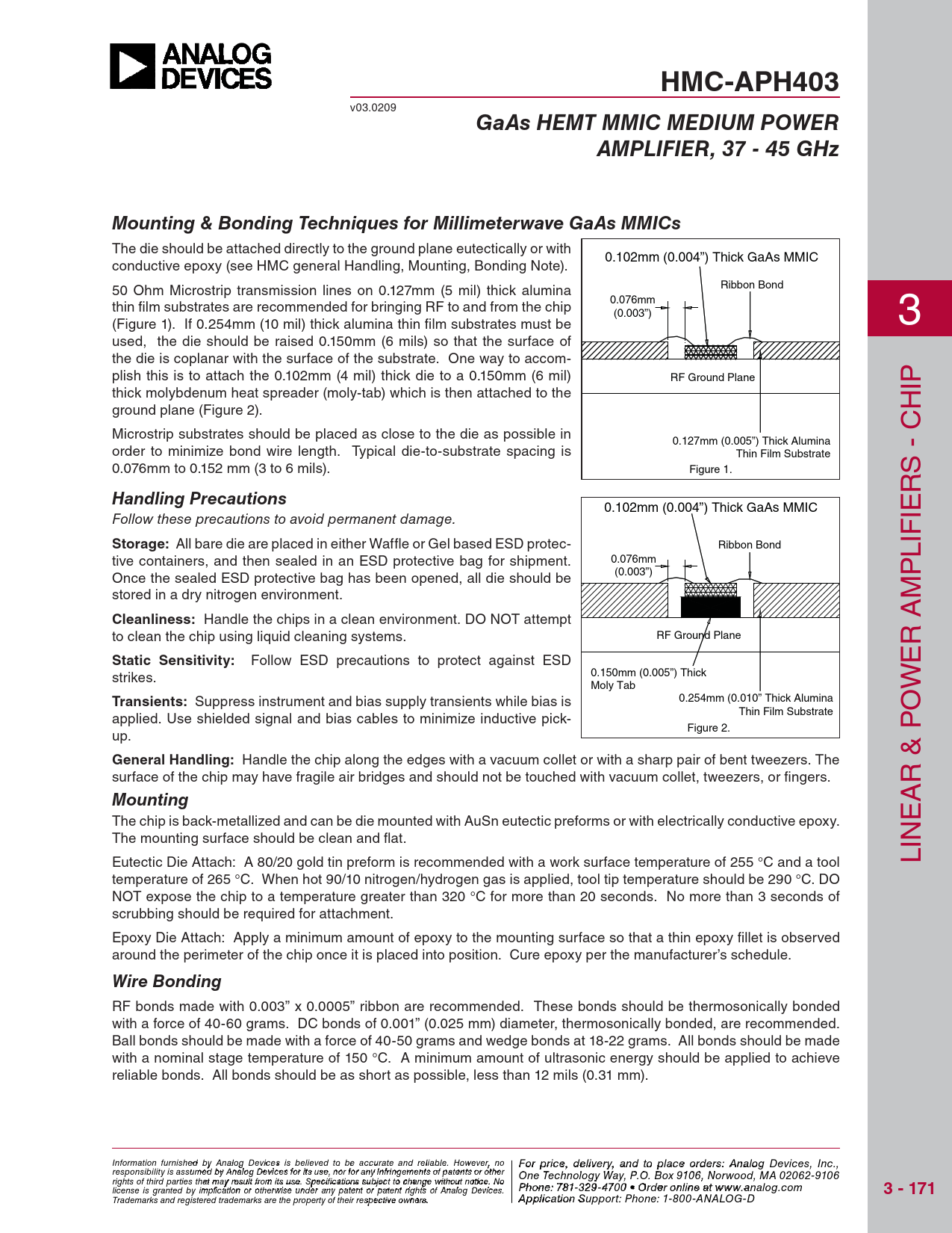

GaAs HEMT MMIC MEDIUM POWER AMPLIFIER, 37 - 45 GHz Mounting & Bonding Techniques for Millimeterwave GaAs MMICs
The die should be attached directly to the ground plane eutectically or with 0.102mm (0.004”) Thick GaAs MMIC conductive epoxy (see HMC general Handling, Mounting, Bonding Note). 50 Ohm Microstrip transmission lines on 0.127mm (5 mil) thick alumina Ribbon Bond 0.076mm thin fi lm substrates are recommended for bringing RF to and from the chip (0.003”) (Figure 1). If 0.254mm (10 mil) thick alumina thin fi lm substrates must be 3 used, the die should be raised 0.150mm (6 mils) so that the surface of the die is coplanar with the surface of the substrate. One way to accom- plish this is to attach the 0.102mm (4 mil) thick die to a 0.150mm (6 mil) RF Ground Plane IP thick molybdenum heat spreader (moly-tab) which is then attached to the ground plane (Figure 2). H Microstrip substrates should be placed as close to the die as possible in 0.127mm (0.005”) Thick Alumina order to minimize bond wire length. Typical die-to-substrate spacing is Thin Film Substrate 0.076mm to 0.152 mm (3 to 6 mils). Figure 1. S - C R

0.102mm (0.004”) Thick GaAs MMIC IE Follow these precautions to avoid permanent damage. IF

All bare die are placed in either Waffle or Gel based ESD protec- Ribbon Bond L tive containers, and then sealed in an ESD protective bag for shipment. 0.076mm (0.003”) P Once the sealed ESD protective bag has been opened, all die should be stored in a dry nitrogen environment. M
