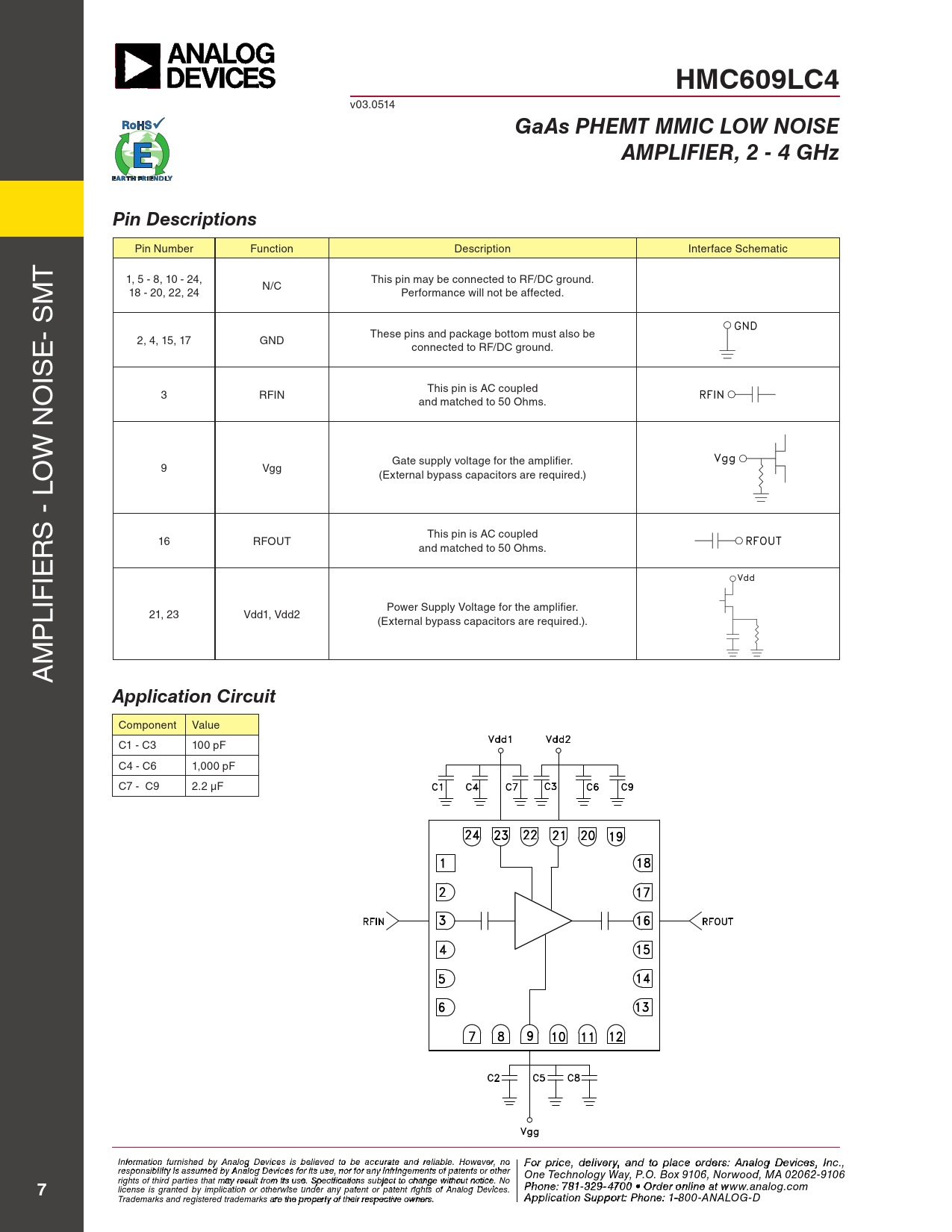

GaAs PHEMT MMIC LOW NOISE AMPLIFIER, 2 - 4 GHz Pin Descriptions
Pin Number Function Description Interface Schematic T M 1, 5 - 8, 10 - 24, This pin may be connected to RF/DC ground. N/C 18 - 20, 22, 24 Performance will not be affected. - S E These pins and package bottom must also be 2, 4, 15, 17 GND connected to RF/DC ground. IS O This pin is AC coupled 3 RFIN and matched to 50 Ohms. W N O Gate supply voltage for the amplifier. 9 Vgg (External bypass capacitors are required.) S - L R This pin is AC coupled 16 RFOUT and matched to 50 Ohms. IE LIF Power Supply Voltage for the amplifier. 21, 23 Vdd1, Vdd2 P (External bypass capacitors are required.). M A
Application Circuit
Component Value C1 - C3 100 pF C4 - C6 1,000 pF C7 - C9 2.2 µF I F nf o or r p mati r o in cfe ur , d nish e e l d iv b e y r A y a nalo n g d t Devi o p ces i la s c bele o ieve rd d t e o rbs e : H acc iutrtatite e M and ic reli rao bl w e. a H v o e C wever o , nrp o For price, delivery, and to place orders: Analog Devices, Inc., responsibility is assumed by Analog Devices for its use, nor for any infringements of patents or other oration, 2 Elizabeth Drive, Chelmsford, MA 01824 One Technology Way, P.O. Box 9106, Norwood, MA 02062-9106 Phone: 978-250-3343 Fax: 978-250-3373 O rights of third parties that may result from its use. Specifications subject to change without notice. No rd Phoe n r O e: 7 n- 81-li 3 n 2 e a 9-4 t w 70 ww 0 • O . rdh e itt r o it nle i . n co e a m
