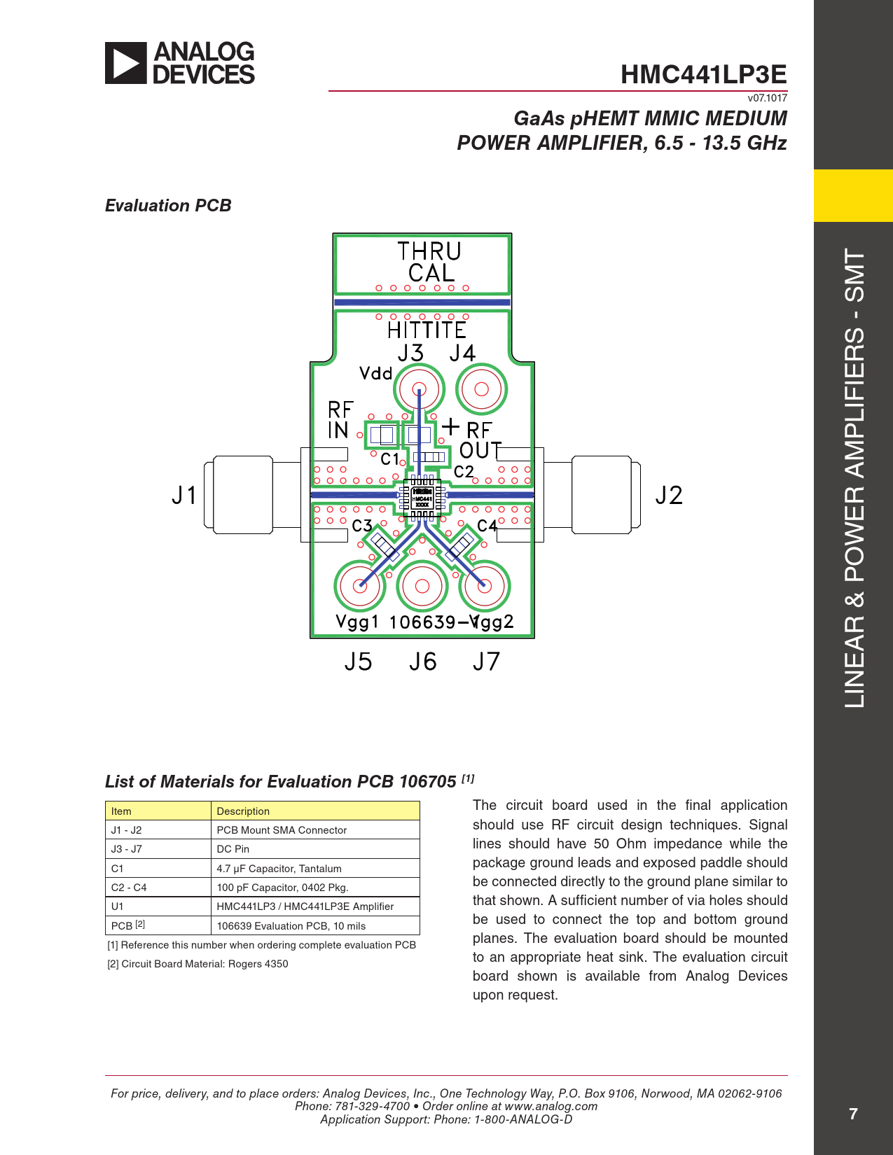

HMC441LP3E. GaAs pHEMT MMIC MEDIUM. POWER AMPLIFIER, 6.5 - 13.5 GHz. Evaluation PCB
HMC441LP3E GaAs pHEMT MMIC MEDIUM POWER AMPLIFIER, 6.5 - 13.5 GHz Evaluation PCB
HMC441LP3E
v07.1017
T M S - S R IE LIF P M R A E W O R & P A E LIN
List of Materials for Evaluation PCB 106705 [1]
The circuit board used in the final application Item Description should use RF circuit design techniques. Signal J1 - J2 PCB Mount SMA Connector lines should have 50 Ohm impedance while the J3 - J7 DC Pin package ground leads and exposed paddle should C1 4.7 µF Capacitor, Tantalum be connected directly to the ground plane similar to C2 - C4 100 pF Capacitor, 0402 Pkg. that shown. A sufficient number of via holes should U1 HMC441LP3 / HMC441LP3E Amplifier be used to connect the top and bottom ground PCB [2] 106639 Evaluation PCB, 10 mils planes. The evaluation board should be mounted [1] Reference this number when ordering complete evaluation PCB to an appropriate heat sink. The evaluation circuit [2] Circuit Board Material: Rogers 4350 board shown is available from Analog Devices upon request. For price, delivery, and to place orders: Analog Devices, Inc., One Technology Way, P.O. Box 9106, Norwood, MA 02062-9106 Phone: 781-329-4700 • Order online at www.analog.com Application Support: Phone: 1-800-ANALOG-D
