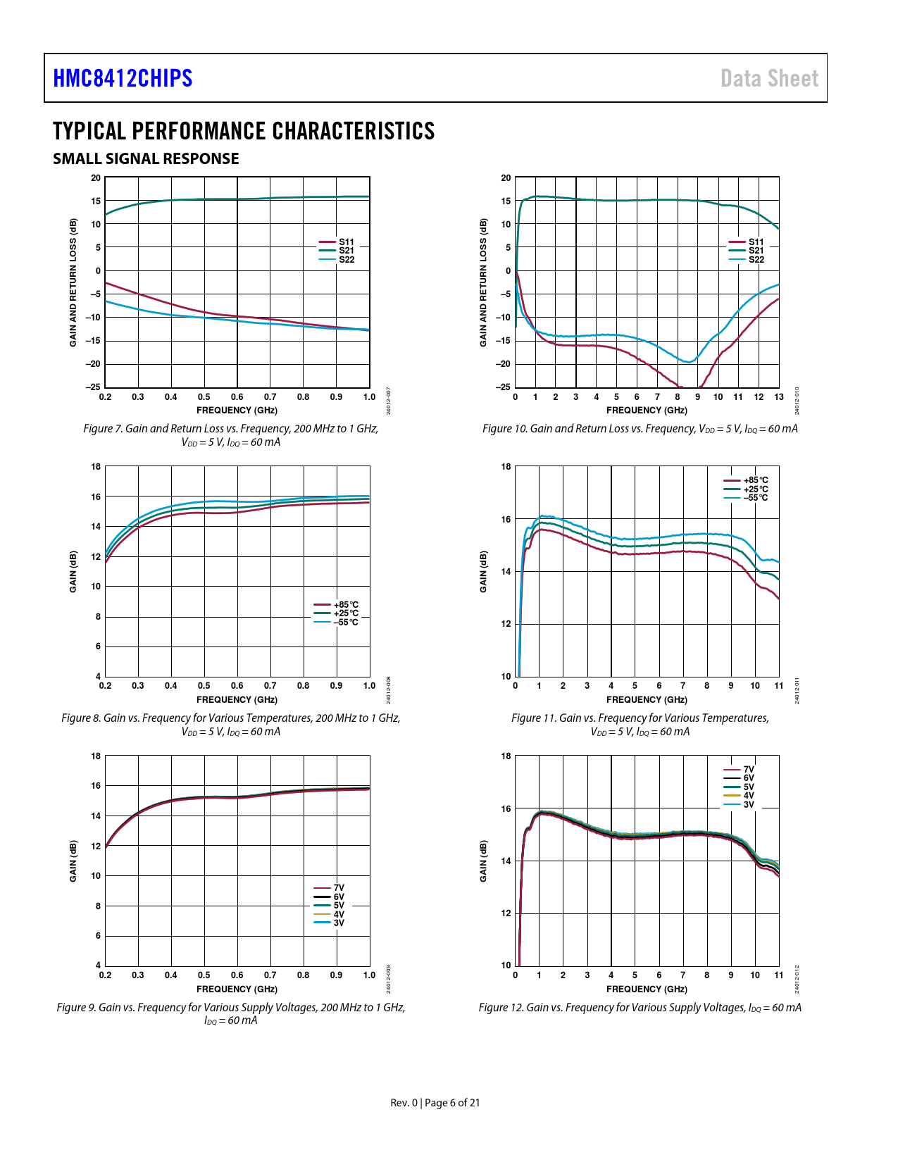

HMC8412CHIPS. Data Sheet. TYPICAL PERFORMANCE CHARACTERISTICS SMALL SIGNAL RESPONSE. S11. S21. S22. URN L. –10. N AND RE. –15. –20. –25. 0.2. 0.3
HMC8412CHIPS Data Sheet TYPICAL PERFORMANCE CHARACTERISTICS SMALL SIGNAL RESPONSE S11 S21 S22 URN L –10 N AND RE –15 –20 –25 0.2 0.3
HMC8412CHIPS Data Sheet TYPICAL PERFORMANCE CHARACTERISTICS SMALL SIGNAL RESPONSE 20 20 15 15 B) 10 B) 10 d d ( ( S S11 S S11 S 5 S 5 O S21 O S21 S22 S22 0 0 URN L URN L T T –5 –5 –10 –10 N AND RE N AND RE AI –15 AI G –15 G –20 –20 –25 –25 0.2 0.3 0.4 0.5 0.6 0.7 0.8 0.9 1.0
007
0 1 2 3 4 5 6 7 8 9 10 11 12 13
010
FREQUENCY (GHz)
24012-
FREQUENCY (GHz)
24012- Figure 7. Gain and Return Loss vs. Frequency, 200 MHz to 1 GHz, Figure 10. Gain and Return Loss vs. Frequency, VDD = 5 V, IDQ = 60 mA VDD = 5 V, IDQ = 60 mA
18 18 +85°C +25°C 16 –55°C 16 14 B) 12 B) d d N ( 14 N ( AI 10 AI G G +85°C 8 +25°C –55°C 12 6 4 10
1 1
008
0
FREQUENCY (GHz)
24012-
FREQUENCY (GHz)
24012- Figure 8. Gain vs. Frequency for Various Temperatures, 200 MHz to 1 GHz, Figure 11. Gain vs. Frequency for Various Temperatures, VDD = 5 V, IDQ = 60 mA VDD = 5 V, IDQ = 60 mA
18 18 7V 6V 16 5V 4V 16 3V 14 B) 12 B) d d N ( 14 N ( AI 10 AI G G 7V 6V 8 5V 4V 12 3V 6 4 10 0.2 0.3 0.4 0.5 0.6 0.7 0.8 0.9 1.0
009
012
FREQUENCY (GHz)
24012-
FREQUENCY (GHz)
24012- Figure 9. Gain vs. Frequency for Various Supply Voltages, 200 MHz to 1 GHz, Figure 12. Gain vs. Frequency for Various Supply Voltages, IDQ = 60 mA IDQ = 60 mA Rev. 0 | Page 6 of 21 Document Outline Features Applications Functional Block Diagram General Description Revision History Specifications 0.4 GHz to 8 GHz Frequency Range 8 GHz to 10 GHz Frequency Range Absolute Maximum Ratings Thermal Resistance Electrostatic Discharge (ESD) Ratings ESD Ratings for HMC8412CHIPS ESD Caution Pin Configuration and Function Descriptions Interface Schematics Typical Performance Characteristics Small Signal Response Large Signal Response Theory of Operation Applications Information Typical Application Circuit Recommended Bias Sequencing During Power-Up During Power-Down Assembly Diagram Mounting and Bonding Techniques for Millimeter Wave GaAs MMICs Handling Precautions Outline Dimensions Ordering Guide
