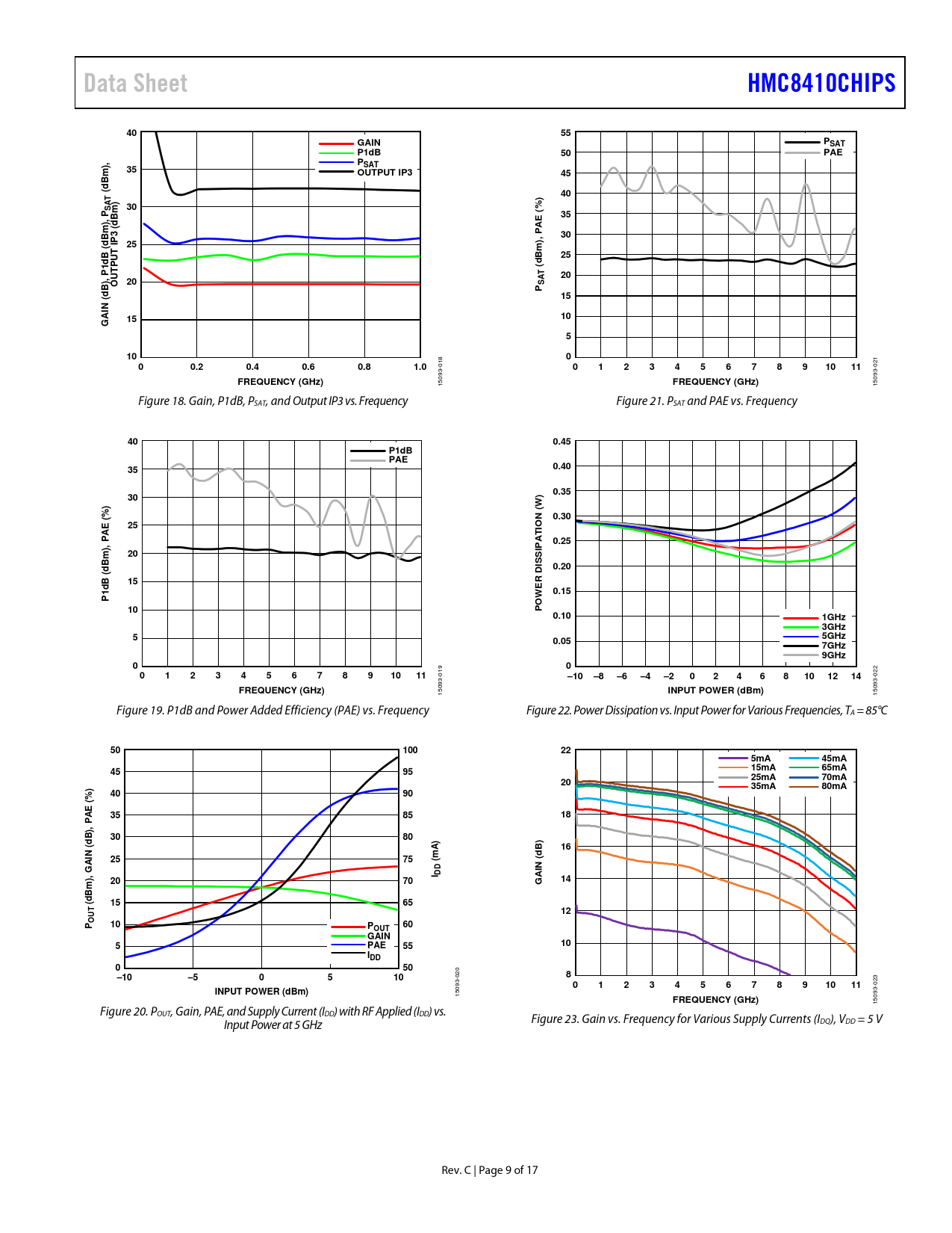

Data Sheet. HMC8410CHIPS. GAIN. PSAT. P1dB. PAE. OUTPUT IP3. Bm) d (. AT S. , P. Bm). E (%. 3 (. B (. N ( AI. 0.2. 0.4. 0.6. 0.8. 1.0. FREQUENCY (GHz). 0.45
Data Sheet HMC8410CHIPS GAIN PSAT P1dB PAE OUTPUT IP3 Bm) d ( AT S , P Bm) E (% 3 ( B ( N ( AI 0.2 0.4 0.6 0.8 1.0 FREQUENCY (GHz) 0.45
Data Sheet HMC8410CHIPS 40 55 GAIN PSAT P1dB 50 PAE , PSAT 35 OUTPUT IP3 45 Bm) d ( 40 ) AT S 30 35 , P Bm) E (% d Bm) 3 ( PA 30 d P ), I 25 m B ( UT B 25 1d P (d , P UT AT 20 20 S B) O P d 15 N ( AI 10 G 15 5 10 0 0 0.2 0.4 0.6 0.8 1.0

15093- Figure 18. Gain, P1dB, PSAT, and Output IP3 vs. Frequency Figure 21. PSAT and PAE vs. Frequency
40 0.45 P1dB PAE 35 0.40 0.35 30 ) (W %) ( N 0.30 25 IO AE T , P 0.25 PA 20 Bm) ISSI d 0.20 D B ( 15 ER 1d 0.15 P W 10 PO 0.10 1GHz 3GHz 5 5GHz 0.05 7GHz 9GHz 0 0 0 1 2 3 4 5 6 7 8 9 10 11

15093- Figure 19. P1dB and Power Added Efficiency (PAE) vs. Frequency Figure 22. Power Dissipation vs. Input Power for Various Frequencies, TA = 85°C
50 100 22 5mA 45mA 15mA 65mA 45 95 25mA 70mA 20 35mA 80mA 40 90 %) ( AE 35 85 18 , P B) 30 80 d B) 16 N ( d 25 75 mA) AI ( N ( , G I DD AI 20 70 14 G Bm) (d 15 65 UT 12 OP 10 P 60 OUT GAIN 5 PAE 55 10 IDD 0 50 –10 –5 0 5 10

15093- Figure 20. POUT, Gain, PAE, and Supply Current (IDD) with RF Applied (IDD) vs. Input Power at 5 GHz Figure 23. Gain vs. Frequency for Various Supply Currents (IDQ), VDD = 5 V Rev. C | Page 9 of 17 Document Outline FEATURES APPLICATIONS FUNCTIONAL BLOCK DIAGRAM GENERAL DESCRIPTION TABLE OF CONTENTS REVISION HISTORY SPECIFICATIONS 0.01 GHz TO 3 GHz FREQUENCY RANGE 3 GHz TO 8 GHz FREQUENCY RANGE 8 GHz TO 10 GHz FREQUENCY RANGE ABSOLUTE MAXIMUM RATINGS THERMAL RESISTANCE ESD CAUTION PIN CONFIGURATION AND FUNCTION DESCRIPTIONS INTERFACE SCHEMATICS TYPICAL PERFORMANCE CHARACTERISTICS THEORY OF OPERATION APPLICATIONS INFORMATION RECOMMENDED BIAS SEQUENCING MOUNTING AND BONDING TECHNIQUES FOR MILLIMETERWAVE GaAs MMICS Handling Precautions APPLICATION CIRCUIT ASSEMBLY DIAGRAM OUTLINE DIMENSIONS ORDERING GUIDE
