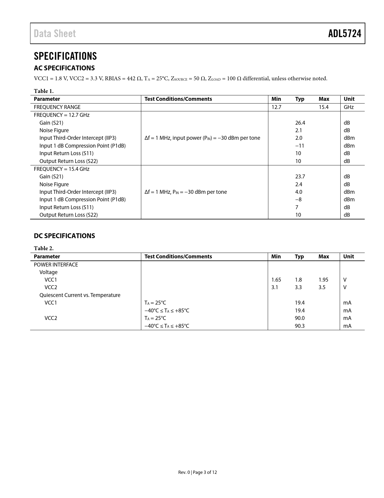

Data Sheet. ADL5724. SPECIFICATIONS AC SPECIFICATIONS. Table 1. Parameter. Test Conditions/Comments. Min. Typ. Max. Unit
Data Sheet ADL5724 SPECIFICATIONS AC SPECIFICATIONS Table 1 Parameter Test Conditions/Comments Min Typ Max Unit
VCC1 = 1.8 V, VCC2 = 3.3 V, RBIAS = 442 Ω, TA = 25°C, ZSOURCE = 50 Ω, ZLOAD = 100 Ω differential, unless otherwise noted.
Table 1. Parameter Test Conditions/Comments Min Typ Max Unit
FREQUENCY RANGE 12.7 15.4 GHz FREQUENCY = 12.7 GHz Gain (S21) 26.4 dB Noise Figure 2.1 dB Input Third-Order Intercept (IIP3) Δf = 1 MHz, input power (PIN) = −30 dBm per tone 2.0 dBm Input 1 dB Compression Point (P1dB) −11 dBm Input Return Loss (S11) 10 dB Output Return Loss (S22) 10 dB FREQUENCY = 15.4 GHz Gain (S21) 23.7 dB Noise Figure 2.4 dB Input Third-Order Intercept (IIP3) Δf = 1 MHz, PIN = −30 dBm per tone 4.0 dBm Input 1 dB Compression Point (P1dB) −8 dBm Input Return Loss (S11) 7 dB Output Return Loss (S22) 10 dB
DC SPECIFICATIONS Table 2. Parameter Test Conditions/Comments Min Typ Max Unit
POWER INTERFACE Voltage VCC1 1.65 1.8 1.95 V VCC2 3.1 3.3 3.5 V Quiescent Current vs. Temperature VCC1 TA = 25°C 19.4 mA −40°C ≤ TA ≤ +85°C 19.4 mA VCC2 TA = 25°C 90.0 mA −40°C ≤ TA ≤ +85°C 90.3 mA Rev. 0 | Page 3 of 12 Document Outline FEATURES APPLICATIONS FUNCTIONAL BLOCK DIAGRAM GENERAL DESCRIPTION TABLE OF CONTENTS REVISION HISTORY SPECIFICATIONS AC SPECIFICATIONS DC SPECIFICATIONS ABSOLUTE MAXIMUM RATINGS THERMAL RESISTANCE ESD CAUTION PIN CONFIGURATION AND FUNCTION DESCRIPTIONS TYPICAL PERFORMANCE CHARACTERISTICS THEORY OF OPERATION APPLICATIONS INFORMATION LAYOUT DIFFERENTIAL vs. SINGLE-ENDED OUTPUT EVALUATION BOARD INITIAL SETUP RESULTS BASIC CONNECTIONS FOR OPERATION OUTLINE DIMENSIONS ORDERING GUIDE
