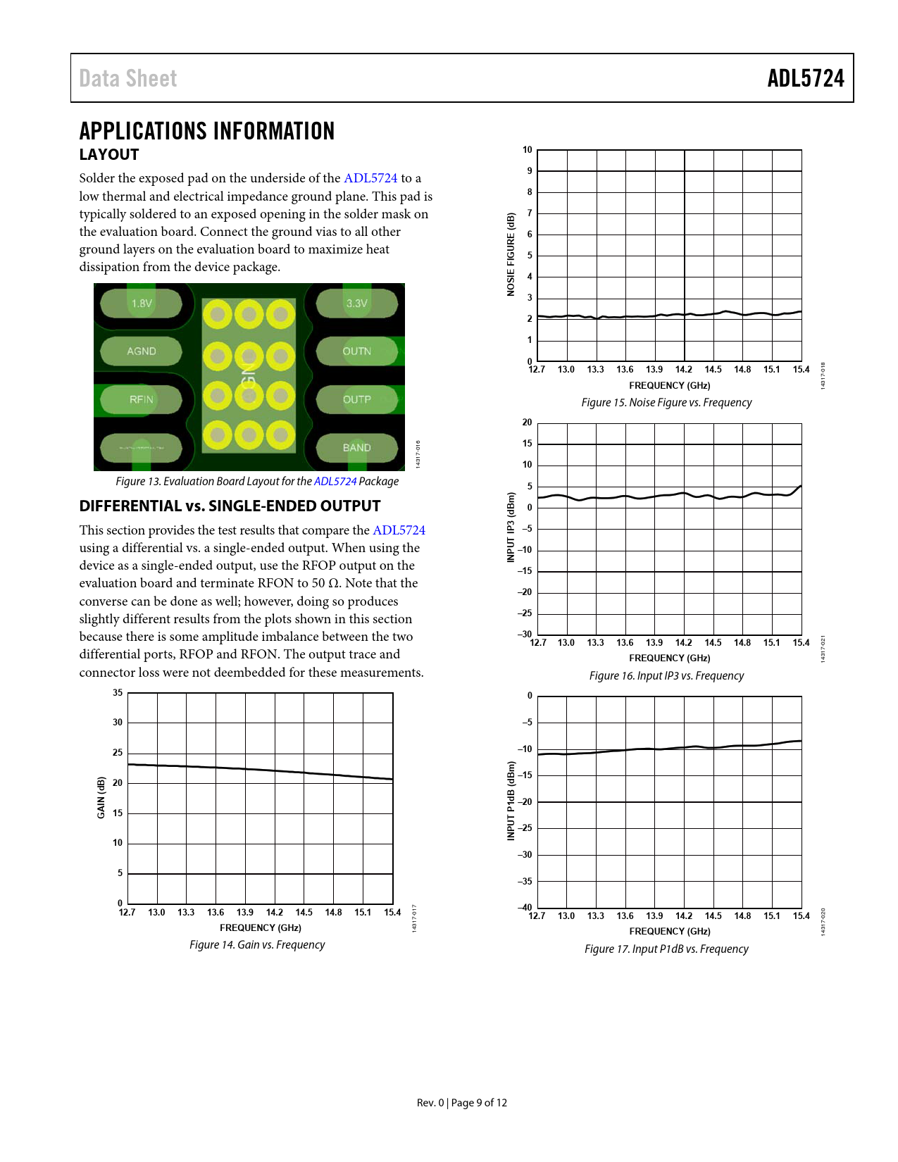

Solder the exposed pad on the underside of the ADL5724 to a low thermal and electrical impedance ground plane. This pad is
8
typically soldered to an exposed opening in the solder mask on
7 B)
the evaluation board. Connect the ground vias to all other
(d 6
ground layers on the evaluation board to maximize heat
URE 5 IG
dissipation from the device package.
F IE 4 S NO 3 2 1 012.7 13.0 13.3 13.6 13.9 14.2 14.5 14.8 15.1 15.4
180 17-
FREQUENCY (GHz)
143 Figure 15. Noise Figure vs. Frequency
20 15
016 14317-
10
Figure 13. Evaluation Board Layout for the ADL5724 Package
5 ) DIFFERENTIAL vs. SINGLE-ENDED OUTPUT m B 0 d 3 (
This section provides the test results that compare the ADL5724
P –5 I T
using a differential vs. a single-ended output. When using the
U P –10 IN
device as a single-ended output, use the RFOP output on the
–15
evaluation board and terminate RFON to 50 Ω. Note that the
–20
converse can be done as well; however, doing so produces
–25
slightly different results from the plots shown in this section because there is some amplitude imbalance between the two
–3012.7 13.0 13.3 13.6 13.9 14.2 14.5 14.8 15.1 15.4
-021 differential ports, RFOP and RFON. The output trace and
FREQUENCY (GHz)
317 14 connector loss were not deembedded for these measurements. Figure 16. Input IP3 vs. Frequency
