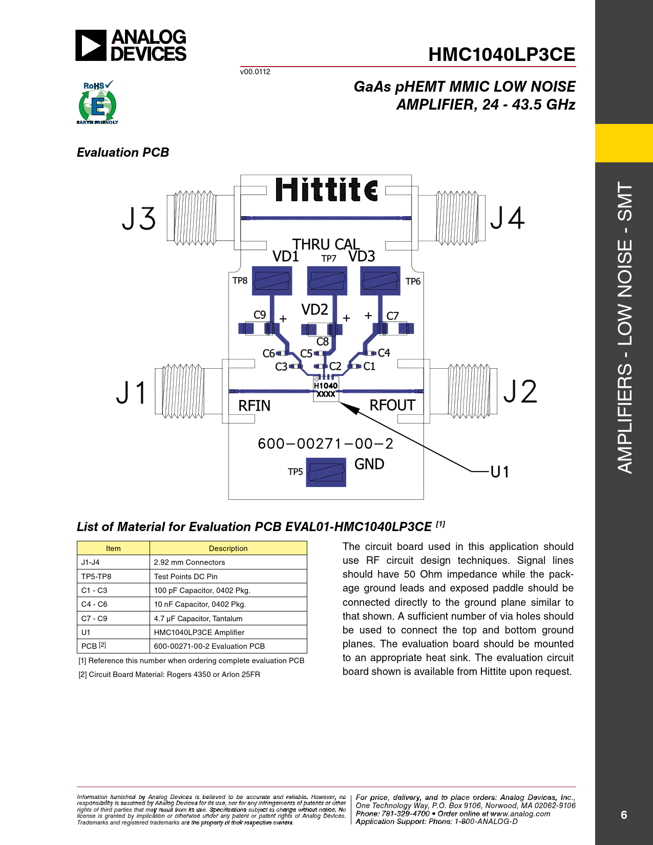

HMC1040LP3CE. GaAs pHEMT MMIC LOW NOISE. AMPLIFIER, 24 - 43.5 GHz. Evaluation PCB
HMC1040LP3CE GaAs pHEMT MMIC LOW NOISE AMPLIFIER, 24 - 43.5 GHz Evaluation PCB
HMC1040LP3CE
v00.0112
T m s e - is o w N lo s - r ie lif p m A
List of Material for Evaluation PCB EVAL01-HMC1040LP3CE [1]
item Description The circuit board used in this application should J1-J4 2.92 mm Connectors use RF circuit design techniques. Signal lines Tp5-Tp8 Test points DC pin should have 50 ohm impedance while the pack- C1 - C3 100 pF Capacitor, 0402 Pkg. age ground leads and exposed paddle should be C4 - C6 10 nF Capacitor, 0402 Pkg. connected directly to the ground plane similar to C7 - C9 4.7 µF Capacitor, Tantalum that shown. A sufficient number of via holes should U1 HmC1040lp3Ce Amplifier be used to connect the top and bottom ground pCB [2] 600-00271-00-2 evaluation pCB planes. The evaluation board should be mounted [1] Reference this number when ordering complete evaluation PCB to an appropriate heat sink. The evaluation circuit [2] Circuit Board material: rogers 4350 or Arlon 25fr board shown is available from Hittite upon request. Inf F or o m r p atio r n ifc ur e n , d ishe e d lbiv y e A r n y a alog n D d t evic o p es is la beclie o eved rd to ebre sa: H ccur iattti e tae M nd re ilicarbloew . H a o ve C wever, o n rp o For price, delivery, and to place orders: Analog Devices, Inc., responsibility is assumed by Analog Devices for its use, nor for any infringements of patents or other oration, 2 Elizabeth Drive, Chelmsford, MA 01824 One Technology Way, P.O. Box 9106, Norwood, MA 02062-9106 Phone: 978-250-3343 Fax: 978-250-3373 O rights of third parties that may result from its use. Specifications subject to change without notice. No P rd ho e ne r O : 7 n 81- -3li 2n 9 e a -47 t w 0 w 0 • O w rd .h e it r o tniltie n .c e ao t m license is granted by implication or otherwise under any patent or patent rights of Analog Devices. www.analog.com
