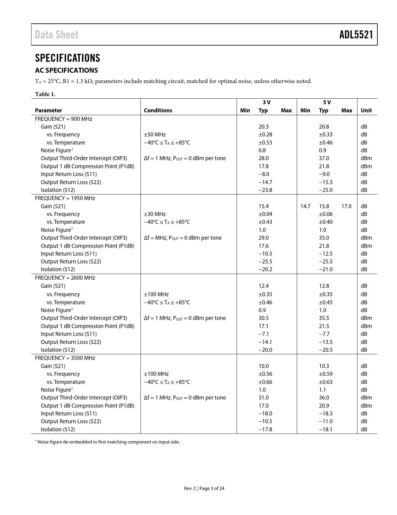

Data Sheet. ADL5521. SPECIFICATIONS AC SPECIFICATIONS. Table 1. 3 V. 5 V. Parameter. Conditions. Min. Typ. Max. Unit
Data Sheet ADL5521 SPECIFICATIONS AC SPECIFICATIONS Table 1 3 V 5 V Parameter Conditions Min Typ Max Unit
TA = 25°C, R1 = 1.3 kΩ; parameters include matching circuit, matched for optimal noise, unless otherwise noted.
Table 1. 3 V 5 V Parameter Conditions Min Typ Max Min Typ Max Unit
FREQUENCY = 900 MHz Gain (S21) 20.3 20.8 dB vs. Frequency ±50 MHz ±0.28 ±0.33 dB vs. Temperature −40°C ≤ TA ≤ +85°C ±0.53 ±0.46 dB Noise Figure1 0.8 0.9 dB Output Third-Order Intercept (OIP3) Δf = 1 MHz, POUT = 0 dBm per tone 28.0 37.0 dBm Output 1 dB Compression Point (P1dB) 17.8 21.8 dBm Input Return Loss (S11) −8.0 −9.0 dB Output Return Loss (S22) −14.7 −15.3 dB Isolation (S12) −23.8 −25.0 dB FREQUENCY = 1950 MHz Gain (S21) 15.4 14.7 15.8 17.0 dB vs. Frequency ±30 MHz ±0.04 ±0.06 dB vs. Temperature −40°C ≤ TA ≤ +85°C ±0.43 ±0.40 dB Noise Figure1 1.0 1.0 dB Output Third-Order Intercept (OIP3) Δf = MHz, POUT = 0 dBm per tone 29.0 35.0 dBm Output 1 dB Compression Point (P1dB) 17.6 21.8 dBm Input Return Loss (S11) −10.5 −12.5 dB Output Return Loss (S22) −25.5 −25.5 dB Isolation (S12) −20.2 −21.0 dB FREQUENCY = 2600 MHz Gain (S21) 12.4 12.8 dB vs. Frequency ±100 MHz ±0.35 ±0.35 dB vs. Temperature −40°C ≤ TA ≤ +85°C ±0.46 ±0.45 dB Noise Figure1 0.9 1.0 dB Output Third-Order Intercept (OIP3) Δf = 1 MHz, POUT = 0 dBm per tone 30.5 35.5 dBm Output 1 dB Compression Point (P1dB) 17.1 21.5 dBm Input Return Loss (S11) −7.1 −7.7 dB Output Return Loss (S22) −14.1 −13.5 dB Isolation (S12) −20.0 −20.5 dB FREQUENCY = 3500 MHz Gain (S21) 10.0 10.3 dB vs. Frequency ±100 MHz ±0.56 ±0.59 dB vs. Temperature −40°C ≤ TA ≤ +85°C ±0.66 ±0.63 dB Noise Figure1 1.0 1.1 dB Output Third-Order Intercept (OIP3) Δf = 1 MHz, POUT = 0 dBm per tone 31.0 36.0 dBm Output 1 dB Compression Point (P1dB) 17.0 20.9 dBm Input Return Loss (S11) −18.0 −18.3 dB Output Return Loss (S22) −10.5 −11.0 dB Isolation (S12) −17.8 −18.1 dB 1 Noise figure de-embedded to first matching component on input side. Rev. C | Page 3 of 24 Document Outline FEATURES FUNCTIONAL BLOCK DIAGRAM GENERAL DESCRIPTION REVISION HISTORY SPECIFICATIONS AC SPECIFICATIONS DC SPECIFICATIONS DE-EMBEDDED S-PARAMETERS, VPOS = 3 V TO 5 V, RFIN = PORT 1, VPOS = PORT 2, RFOUT = PORT 3 ABSOLUTE MAXIMUM RATINGS ESD CAUTION PIN CONFIGURATION AND FUNCTION DESCRIPTIONS TYPICAL PERFORMANCE CHARACTERISTICS 900 MHz, VPOS = 5 V 1950 MHz, VPOS = 5 V 2600 MHZ, VPOS = 5 V 3500 MHz, VPOS = 5 V 900 MHz, VPOS = 3 V 1950 MHz, VPOS = 3 V 2600 MHZ, VPOS = 3 V 3500 MHZ, VPOS = 3 V DC CHARACTERISTICS BASIC CONNECTIONS EVALUATION BOARD SOLDERING INFORMATION AND RECOMMENDED PCB LAND PATTERN TUNING THE ADL5521 FOR OPTIMAL NOISE FIGURE TUNING S22 TUNING THE LNA INPUT FOR OPTIMAL GAIN TUNING THE LNA INPUT FOR OPTIMAL NOISE FIGURE S11 OF THE LNA WITH S22 MATCHED OUTLINE DIMENSIONS ORDERING GUIDE
