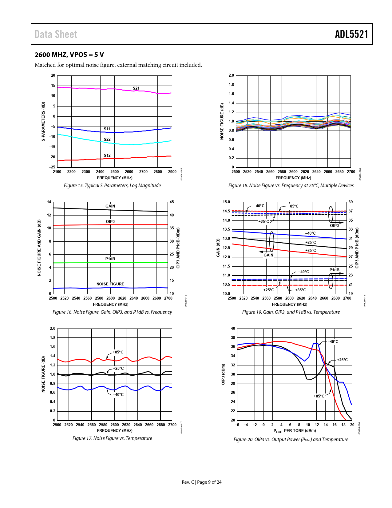

Data Sheet. ADL5521. 2600 MHZ, VPOS = 5 V. 2.0. 1.8. S21. 1.6. 1.4. ( S. 1.2. E T. URE. 1.0. S11. 0.8. ARA. -P –10. S22. 0.6. –15. 0.4. –20. S12. 0.2. –25. 2100. 2200. 2300
Data Sheet ADL5521 2600 MHZ, VPOS = 5 V 2.0 1.8 S21 1.6 1.4 ( S 1.2 E T URE 1.0 S11 0.8 ARA -P –10 S22 0.6 –15 0.4 –20 S12 0.2 –25 2100 2200 2300
Matched for optimal noise figure, external matching circuit included.
20 2.0 15 1.8 S21 10 1.6 B) 1.4 5 d B) ( S (d 1.2 R 0 E T URE E 1.0 IG M –5 F S11 E 0.8 ARA IS -P –10 S S22 NO 0.6 –15 0.4 –20 S12 0.2 –25 0 2100 2200 2300 2400 2500 2600 2700 2800 2900

82 06 06 Figure 15. Typical S-Parameters, Log Magnitude Figure 18. Noise Figure vs. Frequency at 25°C, Multiple Devices
14 45 15.0 39 GAIN –40°C +85°C 14.5 37 12 40 B) OIP3 14.0 35 +25°C (d OIP3 10 35 ) ) IN 13.5 33 A Bm –40°C Bm d d ( D G ) 13.0 31 8 30 B ( B B d +25°C AN 1d ( 1d 12.5 29 IN +85°C URE 6 25 GA 12.0 GAIN 27 IG P1dB 3 AND P 3 AND P F E IP IP 4 20 11.5 25 IS O O –40°C P1dB NO 11.0 23 2 15 NOISE FIGURE 10.5 21 +25°C +85°C 0 10 10.0 19 2500 2520 2540 2560 2580 2600 2620 2640 2660 2680 2700

82 06 06 Figure 16. Noise Figure, Gain, OIP3, and P1dB vs. Frequency Figure 19. Gain, OIP3, and P1dB vs. Temperature
2.0 40 1.8 38 –40°C 1.6 36 +85°C 1.4 34 B) +25°C (d 1.2 ) 32 +25°C m URE B 1.0 d IG 30 3 ( F E 0.8 IS OIP 28 NO 0.6 –40°C 26 +85°C 0.4 24 0.2 22 0 20 2500 2520 2540 2560 2580 2600 2620 2640 2660 2680 2700

06 Figure 17. Noise Figure vs. Temperature Figure 20. OIP3 vs. Output Power (POUT) and Temperature Rev. C | Page 9 of 24 Document Outline FEATURES FUNCTIONAL BLOCK DIAGRAM GENERAL DESCRIPTION REVISION HISTORY SPECIFICATIONS AC SPECIFICATIONS DC SPECIFICATIONS DE-EMBEDDED S-PARAMETERS, VPOS = 3 V TO 5 V, RFIN = PORT 1, VPOS = PORT 2, RFOUT = PORT 3 ABSOLUTE MAXIMUM RATINGS ESD CAUTION PIN CONFIGURATION AND FUNCTION DESCRIPTIONS TYPICAL PERFORMANCE CHARACTERISTICS 900 MHz, VPOS = 5 V 1950 MHz, VPOS = 5 V 2600 MHZ, VPOS = 5 V 3500 MHz, VPOS = 5 V 900 MHz, VPOS = 3 V 1950 MHz, VPOS = 3 V 2600 MHZ, VPOS = 3 V 3500 MHZ, VPOS = 3 V DC CHARACTERISTICS BASIC CONNECTIONS EVALUATION BOARD SOLDERING INFORMATION AND RECOMMENDED PCB LAND PATTERN TUNING THE ADL5521 FOR OPTIMAL NOISE FIGURE TUNING S22 TUNING THE LNA INPUT FOR OPTIMAL GAIN TUNING THE LNA INPUT FOR OPTIMAL NOISE FIGURE S11 OF THE LNA WITH S22 MATCHED OUTLINE DIMENSIONS ORDERING GUIDE
