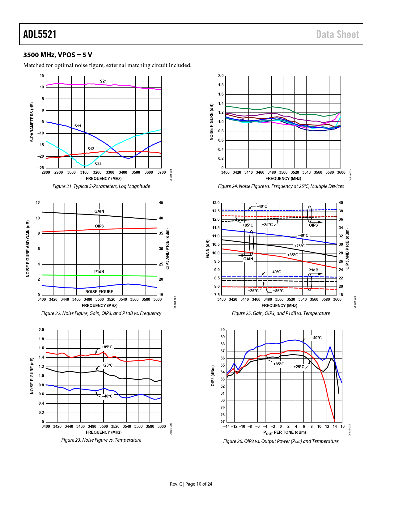

ADL5521. Data Sheet. 3500 MHz, VPOS = 5 V. 2.0. S21. 1.8. 1.6. 1.4. 1.2. T E. 1.0. S11. FIGU E. 0.8. ARA –10. OIS. 0.6. –15. S12. 0.4. –20. 0.2. S22. –25. 2800. 2900. 3000
ADL5521 Data Sheet 3500 MHz, VPOS = 5 V 2.0 S21 1.8 1.6 1.4 1.2 T E 1.0 S11 FIGU E 0.8 ARA –10 OIS 0.6 –15 S12 0.4 –20 0.2 S22 –25 2800 2900 3000
Matched for optimal noise figure, external matching circuit included.
15 2.0 S21 1.8 10 1.6 5 B) ) 1.4 d B ( 0 S (d 1.2 R E E R T E –5 1.0 M S11 FIGU E 0.8 ARA –10 -P OIS S N 0.6 –15 S12 0.4 –20 0.2 S22 –25 0 2800 2900 3000 3100 3200 3300 3400 3500 3600 3700

82 06 06 Figure 21. Typical S-Parameters, Log Magnitude Figure 24. Noise Figure vs. Frequency at 25°C, Multiple Devices
12 45 13.0 40 –40°C GAIN 12.5 38 10 40 12.0 36 B) +85°C +25°C OIP3 (d OIP3 ) 11.5 34 ) IN 8 35 A Bm Bm d 11.0 –40°C 32 d ( ( D G ) B B B d 10.5 30 AN 1d +25°C 1d 6 30 ( IN 10.0 28 URE GA +85°C IG GAIN 3 AND P 9.5 26 3 AND P F 4 25 E IP IP IS O O P1dB 9.0 P1dB 24 –40°C NO 2 20 8.5 22 8.0 20 NOISE FIGURE +25°C +85°C 0 15 7.5 18 3400 3420 3440 3460 3480 3500 3520 3540 3560 3580 3600

82 06 06 Figure 22. Noise Figure, Gain, OIP3, and P1dB vs. Frequency Figure 25. Gain, OIP3, and P1dB vs. Temperature
2.0 40 1.8 39 –40°C 38 1.6 +85°C 37 ) 1.4 B 36 (d +85°C 1.2 +25°C ) 35 E +25°C R m B 34 1.0 d 3 ( FIGU 33 E 0.8 OIP 32 OIS N 0.6 31 –40°C 30 0.4 29 0.2 28 0 27 3400 3420 3440 3460 3480 3500 3520 3540 3560 3580 3600

06 Figure 23. Noise Figure vs. Temperature Figure 26. OIP3 vs. Output Power (POUT) and Temperature Rev. C | Page 10 of 24 Document Outline FEATURES FUNCTIONAL BLOCK DIAGRAM GENERAL DESCRIPTION REVISION HISTORY SPECIFICATIONS AC SPECIFICATIONS DC SPECIFICATIONS DE-EMBEDDED S-PARAMETERS, VPOS = 3 V TO 5 V, RFIN = PORT 1, VPOS = PORT 2, RFOUT = PORT 3 ABSOLUTE MAXIMUM RATINGS ESD CAUTION PIN CONFIGURATION AND FUNCTION DESCRIPTIONS TYPICAL PERFORMANCE CHARACTERISTICS 900 MHz, VPOS = 5 V 1950 MHz, VPOS = 5 V 2600 MHZ, VPOS = 5 V 3500 MHz, VPOS = 5 V 900 MHz, VPOS = 3 V 1950 MHz, VPOS = 3 V 2600 MHZ, VPOS = 3 V 3500 MHZ, VPOS = 3 V DC CHARACTERISTICS BASIC CONNECTIONS EVALUATION BOARD SOLDERING INFORMATION AND RECOMMENDED PCB LAND PATTERN TUNING THE ADL5521 FOR OPTIMAL NOISE FIGURE TUNING S22 TUNING THE LNA INPUT FOR OPTIMAL GAIN TUNING THE LNA INPUT FOR OPTIMAL NOISE FIGURE S11 OF THE LNA WITH S22 MATCHED OUTLINE DIMENSIONS ORDERING GUIDE
