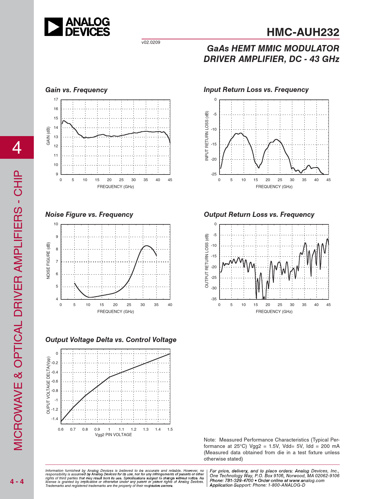

HMC-AUH232. GaAs HEMT MMIC MODULATOR. DRIVER AMPLIFIER, DC - 43 GHz. Gain vs. Frequency. Input Return Loss vs. Frequency
HMC-AUH232 GaAs HEMT MMIC MODULATOR DRIVER AMPLIFIER, DC - 43 GHz Gain vs Frequency Input Return Loss vs Frequency
HMC-AUH232
v02.0209
GaAs HEMT MMIC MODULATOR DRIVER AMPLIFIER, DC - 43 GHz Gain vs. Frequency Input Return Loss vs. Frequency
17 0 16 -5 15 14 -10 (dB) 13 4 GAIN -15 12 11 INPUT RETURN LOSS (dB) -20 10 IP 9 -25 0 5 10 15 20 25 30 35 40 45 0 5 10 15 20 25 30 35 40 45 H FREQUENCY (GHz) FREQUENCY (GHz) S - C R
Noise Figure vs. Frequency Output Return Loss vs. Frequency
10 0 IE IF -5 9 L -10 P 8 -15 M GURE (dB) 7 -20 SE FI 6 R A NOI -25 E 5 OUTPUT RETURN LOSS (dB) -30 IV 4 -35 R 0 5 10 15 20 25 30 35 40 0 5 10 15 20 25 30 35 40 45 FREQUENCY (GHz) FREQUENCY (GHz) L D A IC
Output Voltage Delta vs. Control Voltage
T P 0 -0.2 -0.4 E & O -0.6 V -0.8 A -1 W -1.2 OUPUT VOLTAGE DELTA(Vpp) O -1.4 R 0.6 0.7 0.8 0.9 1 1.1 1.2 1.3 1.4 1.5 IC Vgg2 PIN VOLTAGE Note: Measured Performance Characteristics (Typical Per- M formance at 25°C) Vgg2 = 1.5V, Vdd= 5V, Idd = 200 mA (Measured data obtained from die in a test fi xture unless otherwise stated) Information furnish F ed obr pri y Anal ce, de og Device li s vie s r beyli, a eve nd to pla d to be accura ce o te and rder reliabl s e , pl . Ho ease co wever, no For price, delivery, and to place orders: Analog Devices, Inc., responsibility is assumed by Analog Devices for its use, nor for any infringements of patents or other ntact Hittite Microwave Corporation: One Technology Way, P.O. Box 9106, Norwood, MA 02062-9106 rights of third parties that may result from its use. Specifications subject to change without notice. No
