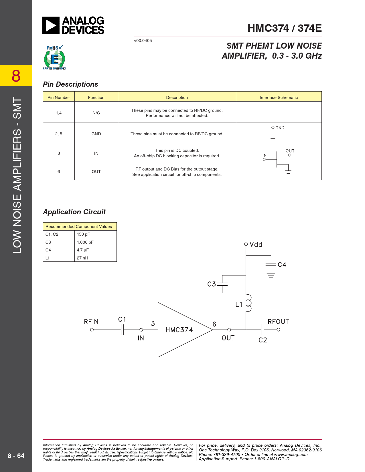

HMC374 / 374E. SMT PHEMT LOW NOISE. AMPLIFIER, 0.3 - 3.0 GHz. Pin Descriptions. Application Circuit. 8 - 64
HMC374 / 374E SMT PHEMT LOW NOISE AMPLIFIER, 0.3 - 3.0 GHz Pin Descriptions Application Circuit 8 - 64
HMC374 / 374E
v00.0405
8
Pin Descriptions
T Pin Number Function Description Interface Schematic These pins may be connected to RF/DC ground. 1,4 N/C Performance will not be affected. - SM S 2, 5 GND These pins must be connected to RF/DC ground. R IE This pin is DC coupled. 3 IN IF An off-chip DC blocking capacitor is required. L P RF output and DC Bias for the output stage. 6 OUT See application circuit for off-chip components. M E A IS
Application Circuit
Recommended Component Values W NO C1, C2 150 pF O C3 1,000 pF L C4 4.7 μF L1 27 nH Information furnish F e o d r pri by An ce, de alog Devic leis vie s rbyeli, a eve nd to pla d to be accur ce o ate an r d der relia s ble , pl . Ho ease co wever, no For price, delivery, and to place orders: Analog Devices, Inc., responsibility is assumed by Analog Devices for its use, nor for any infringements of patents or other ntact Hittite Microwave Corporation: One Technology Way, P.O. Box 9106, Norwood, MA 02062-9106 20 Alpha Road, Chelmsford, MA 01824 Phone rights of third parties that may result from its use. Specifications subject to change without notice. No license is granted by implication or otherwise under any patent or patent rights of Analog Devices. : 978 Phon -e25 : 7 0 81 -3 3 3 29 4 - 3 F 470 ax 0 • O : 978 rder o - nl 25 in 0 e a - t 33 ww 73
