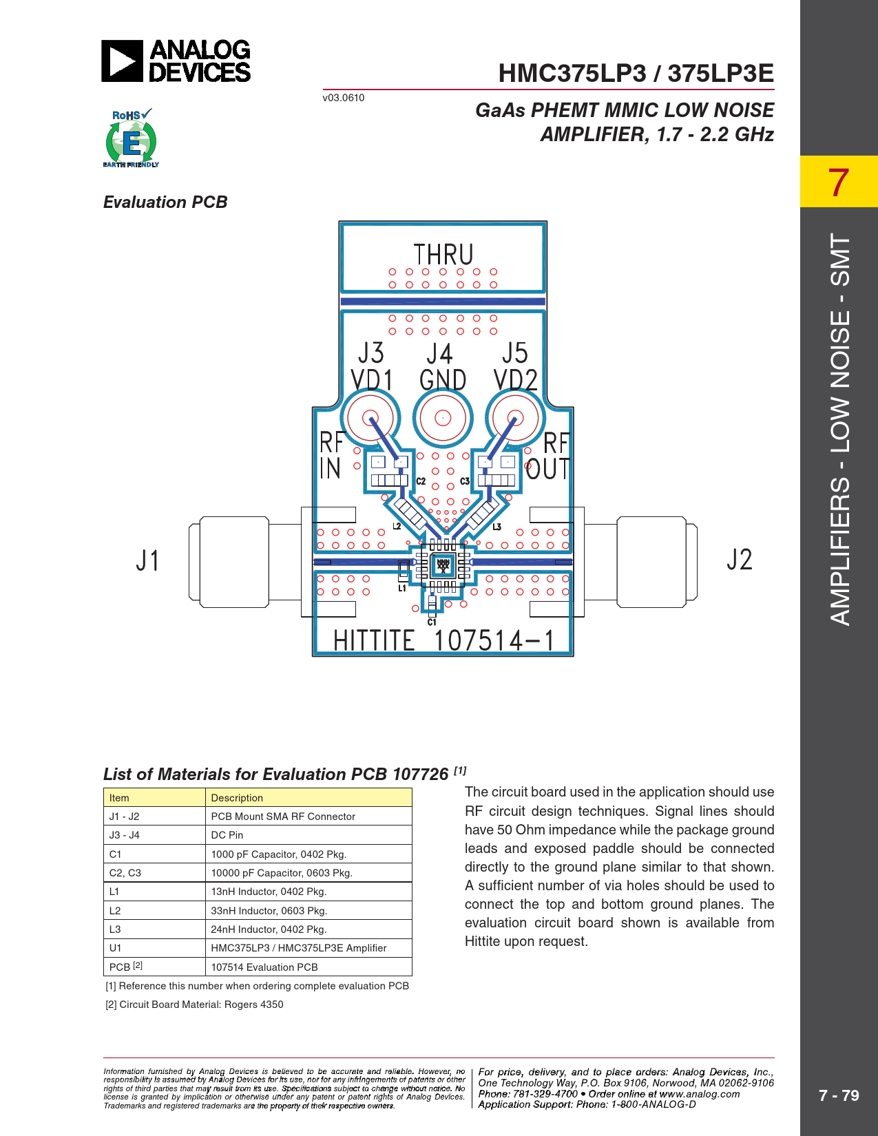

HMC375LP3 / 375LP3E. GaAs PHEMT MMIC LOW NOISE. AMPLIFIER, 1.7 - 2.2 GHz. Evaluation PCB
HMC375LP3 / 375LP3E GaAs PHEMT MMIC LOW NOISE AMPLIFIER, 1.7 - 2.2 GHz Evaluation PCB
HMC375LP3 / 375LP3E
v03.0610
7
Evaluation PCB
T E - SM IS W NO O - L S R IE IF L P M A
List of Materials for Evaluation PCB 107726 [1]
The circuit board used in the application should use Item Description RF circuit design techniques. Signal lines should J1 - J2 PCB Mount SMA RF Connector have 50 Ohm impedance while the package ground J3 - J4 DC Pin leads and exposed paddle should be connected C1 1000 pF Capacitor, 0402 Pkg. directly to the ground plane similar to that shown. C2, C3 10000 pF Capacitor, 0603 Pkg. A sufficient number of via holes should be used to L1 13nH Inductor, 0402 Pkg. connect the top and bottom ground planes. The L2 33nH Inductor, 0603 Pkg. evaluation circuit board shown is available from L3 24nH Inductor, 0402 Pkg. Hittite upon request. U1 HMC375LP3 / HMC375LP3E Amplifi er PCB [2] 107514 Evaluation PCB [1] Reference this number when ordering complete evaluation PCB [2] Circuit Board Material: Rogers 4350 Info F rmoatr pr ion f iurcne, de ished b ly iv A e n r al y o a g D n evd to p ices is bla eli c eve o ed t rde o be ras: H ccuratite tiatne M d reli iacr ble ow . Ho av wev e C er, n o o rpo Fora r t p iro ic n e ,, 2 d 0 eli A ve lrpha R y, and toad, C o place hoel rd m er s s fo : Ard, MA 01 nalog Devic 8 e 2 s 4 , Inc., responsibility is assumed by Analog Devices for its use, nor for any infringements of patents or other One Technology Way, P.O. Box 9106, Norwood, MA 02062-9106 Phone: 978-250-3343 Fax: 978-250-3373 O rights of third parties that may result from its use. Specifications subject to change without notice. No P rde hone r O : 7 n 81- -3li 2n 9 e a -47 t w 0 w 0 • O w rd .ehit r o t nilte in .c e ao t m license is granted by implication or otherwise under any patent or patent rights of Analog Devices. www.analog.com
