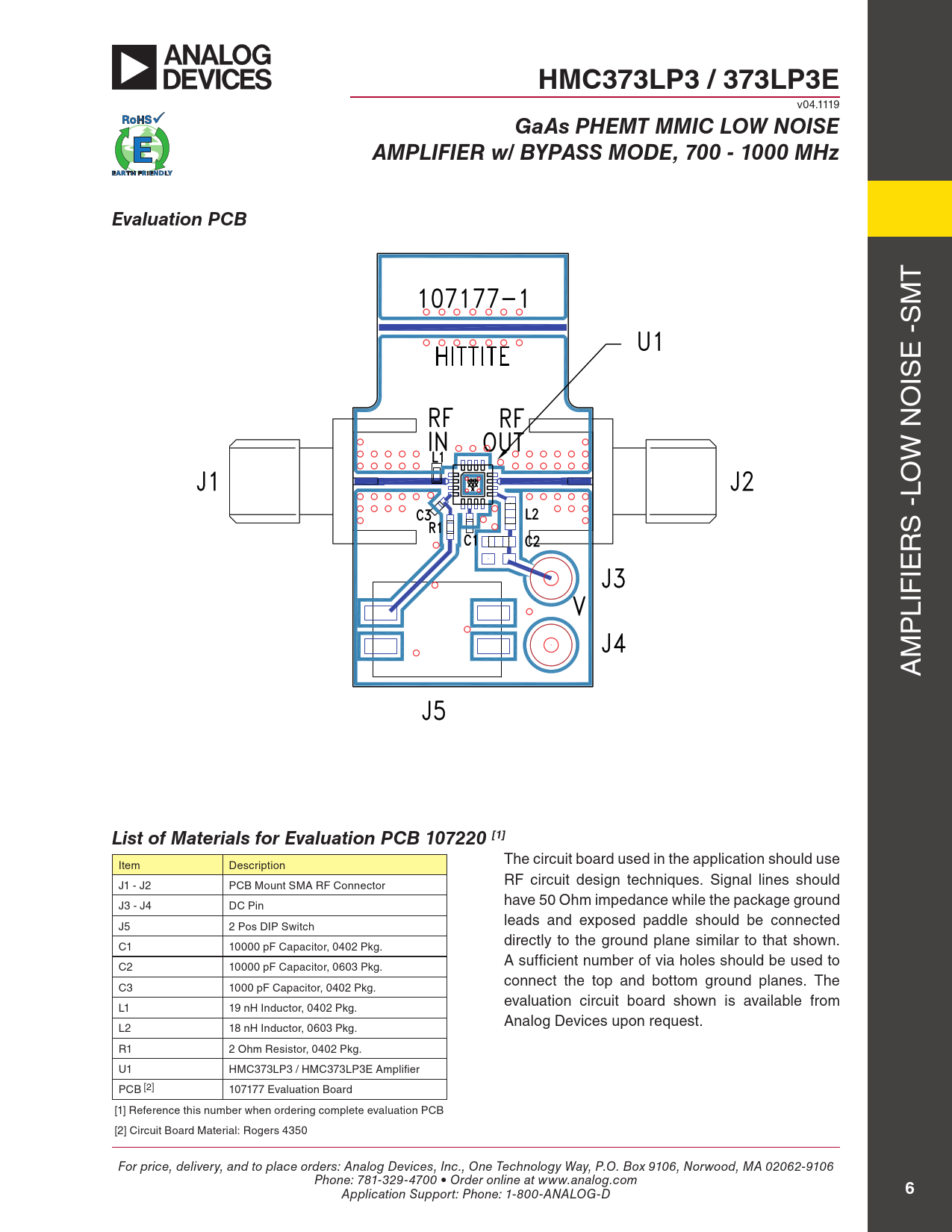

HMC373LP3 / 373LP3E. GaAs PHEMT MMIC LOW NOISE. AMPLIFIER w/ BYPASS MODE, 700 - 1000 MHz. Evaluation PCB
HMC373LP3 / 373LP3E GaAs PHEMT MMIC LOW NOISE AMPLIFIER w/ BYPASS MODE, 700 - 1000 MHz Evaluation PCB
HMC373LP3 / 373LP3E
v04.1119
T M S - E IS O N W LO - S R IE LIF P M A
List of Materials for Evaluation PCB 107220 [1]
Item Description The circuit board used in the application should use J1 - J2 PCB Mount SMA RF Connector RF circuit design techniques. Signal lines should have 50 Ohm impedance while the package ground J3 - J4 DC Pin leads and exposed paddle should be connected J5 2 Pos DIP Switch directly to the ground plane similar to that shown. C1 10000 pF Capacitor, 0402 Pkg. A sufficient number of via holes should be used to C2 10000 pF Capacitor, 0603 Pkg. connect the top and bottom ground planes. The C3 1000 pF Capacitor, 0402 Pkg. evaluation circuit board shown is available from L1 19 nH Inductor, 0402 Pkg. Analog Devices upon request. L2 18 nH Inductor, 0603 Pkg. R1 2 Ohm Resistor, 0402 Pkg. U1 HMC373LP3 / HMC373LP3E Amplifier PCB [2] 107177 Evaluation Board [1] Reference this number when ordering complete evaluation PCB [2] Circuit Board Material: Rogers 4350 For price, delivery, and to place orders: Analog Devices, Inc., One Technology Way, P.O. Box 9106, Norwood, MA 02062-9106 Phone: 781-329-4700 • Order online at www.analog.com Application Support: Phone: 1-800-ANALOG-D
