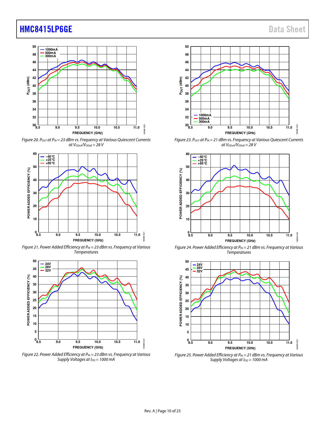

HMC8415LP6GE. Data Sheet. 1000mA 500mA. 300mA. Bm). 1000mA. 500mA 300mA. 8.5. 9.0. 9.5. 10.0. 10.5. 11.0. FREQUENCY (GHz). –40°C. +25°C. +85°C. ICI. D E
HMC8415LP6GE Data Sheet 1000mA 500mA 300mA Bm) 1000mA 500mA 300mA 8.5 9.0 9.5 10.0 10.5 11.0 FREQUENCY (GHz) –40°C +25°C +85°C ICI D E
HMC8415LP6GE Data Sheet 50 50 1000mA 500mA 48 48 300mA 46 46 44 44 42 42 Bm) Bm) d d ( 40 ( 40 UT UT O O P 38 P 38 36 36 34 34 1000mA 32 32 500mA 300mA 30 30 8.5 9.0 9.5 10.0 10.5 11.0
020
023
FREQUENCY (GHz)
16688-
FREQUENCY (GHz)
16688- Figure 20. POUT at PIN = 23 dBm vs. Frequency at Various Quiescent Currents Figure 23. POUT at PIN = 21 dBm vs. Frequency at Various Quiescent Currents at VDDxA/VDDxB = 28 V at VDDxA/VDDxB = 28 V
60 60 –40°C –40°C +25°C +25°C +85°C +85°C 50 50 %) %) ( ( Y Y NC 40 NC E 40 E ICI ICI F F F F 30 30 D E D E ADDE 20 ADDE 20 ER ER W W PO 10 PO 10 0 0 8.5 9.0 9.5 10.0 10.5 11.0
021
024
FREQUENCY (GHz)
16688-
FREQUENCY (GHz)
16688- Figure 21. Power Added Efficiency at PIN = 23 dBm vs. Frequency at Various Figure 24. Power Added Efficiency at PIN = 21 dBm vs. Frequency at Various Temperatures Temperatures
50 50 24V 24V 28V 45 28V 32V 45 32V 40 %) 40 ( %) Y ( Y 35 NC 35 E NC E ICI 30 ICI 30 F F F F 25 D E 25 D E 20 20 ADDE ADDE 15 ER 15 ER W W 10 PO 10 PO 5 5 0 0 8.5 9.0 9.5 10.0 10.5 11.0
022
025
FREQUENCY (GHz)
16688-
FREQUENCY (GHz)
16688- Figure 22. Power Added Efficiency at PIN = 23 dBm vs. Frequency at Various Figure 25. Power Added Efficiency at PIN = 21 dBm vs. Frequency at Various Supply Voltages at IDQ = 1000 mA Supply Voltages at IDQ = 1000 mA Rev. A | Page 10 of 23 Document Outline FEATURES APPLICATIONS FUNCTIONAL BLOCK DIAGRAM GENERAL DESCRIPTION REVISION HISTORY SPECIFICATIONS ELECTRICAL SPECIFICATIONS TOTAL TARGET QUIESCENT CURRENT BY VDDxA/VDDxB ABSOLUTE MAXIMUM RATINGS THERMAL RESISTANCE ESD CAUTION PIN CONFIGURATION AND FUNCTION DESCRIPTIONS INTERFACE SCHEMATICS TYPICAL PERFORMANCE CHARACTERISTICS THEORY OF OPERATION APPLICATIONS INFORMATION TYPICAL APPLICATION CIRCUIT AND PULSOR CIRCUIT USING THE EV1HMC8415LP6G WITH THE DRAIN BIAS PULS0R BOARD RECOMMENDED BIAS SEQUENCE Power-Up Bias Concept for the EV1HMC8415LP6G with the Pulsor Power-Down Bias Concept for the EV1HMC8415LP6G with the Pulsor MAKING AVERAGE TO PULSED APPROXIMATIONS EVALUATION PCB BILL OF MATERIALS OUTLINE DIMENSIONS ORDERING GUIDE
