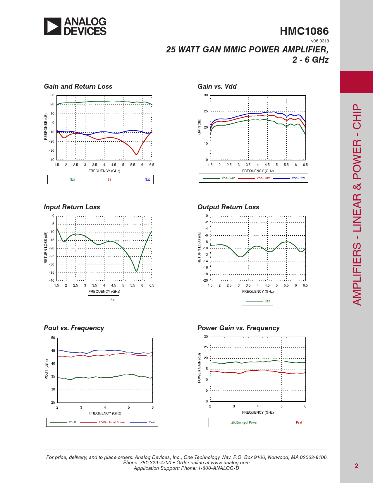

Description25 WATT GaN MMIC POWER AMPLIFIER, 2 - 6 GHz
Pages / Page9 / 2 — HMC1086. 25 WATT GAN MMIC POWER AMPLIFIER,. 2 - 6 GHz. Gain and Return …
File Format / SizePDF / 643 Kb
HMC1086. 25 WATT GAN MMIC POWER AMPLIFIER,. 2 - 6 GHz. Gain and Return Loss. Gain vs. Vdd. Input Return Loss. Output Return Loss
HMC1086 25 WATT GAN MMIC POWER AMPLIFIER, 2 - 6 GHz Gain and Return Loss Gain vs Vdd Input Return Loss Output Return Loss
HMC1086
v06.0318
25 WATT GAN MMIC POWER AMPLIFIER, 2 - 6 GHz Gain and Return Loss Gain vs. Vdd
30 30 20 25 10 IP B) (d ) B 0 d H SE ( N 20 IN -10 A G ESPO R -20 15 R - C -30 E -40 10 1.5 2 2.5 3 3.5 4 4.5 5 5.5 6 6.5 1.5 2 2.5 3 3.5 4 4.5 5 5.5 6 6.5 W FREQUENCY (GHz) FREQUENCY (GHz) O Vdd= 24V Vdd= 28V Vdd= 32V S21 S11 S22 R & P
A 0 0 E -2 -5 IN -4 ) -10 ) B B -6 (d (d S -15 S S S -8 O O L -20 L -10 N N S - L UR -25 -12 UR T T R RE -14 RE -30 -16 IE -35 -18 -40 -20 LIF 1.5 2 2.5 3 3.5 4 4.5 5 5.5 6 6.5 1.5 2 2.5 3 3.5 4 4.5 5 5.5 6 6.5 P FREQUENCY (GHz) FREQUENCY (GHz) S11 M S22 A
Pout vs. Frequency Power Gain vs. Frequency
30 50 25 45 B) 20 (d N 40 AI (dBm) G 15 ER 35 W POUT 10 PO 30 5 0 25 2 3 4 5 6 2 3 4 5 6 FREQUENCY (GHz) FREQUENCY (GHz) P1dB 25dBm Input Power Psat 25dBm Input Power Psat For price, delivery, and to place orders: Analog Devices, Inc., One Technology Way, P.O. Box 9106, Norwood, MA 02062-9106 Phone: 781-329-4700 • Order online at www.analog.com Application Support: Phone: 1-800-ANALOG-D
