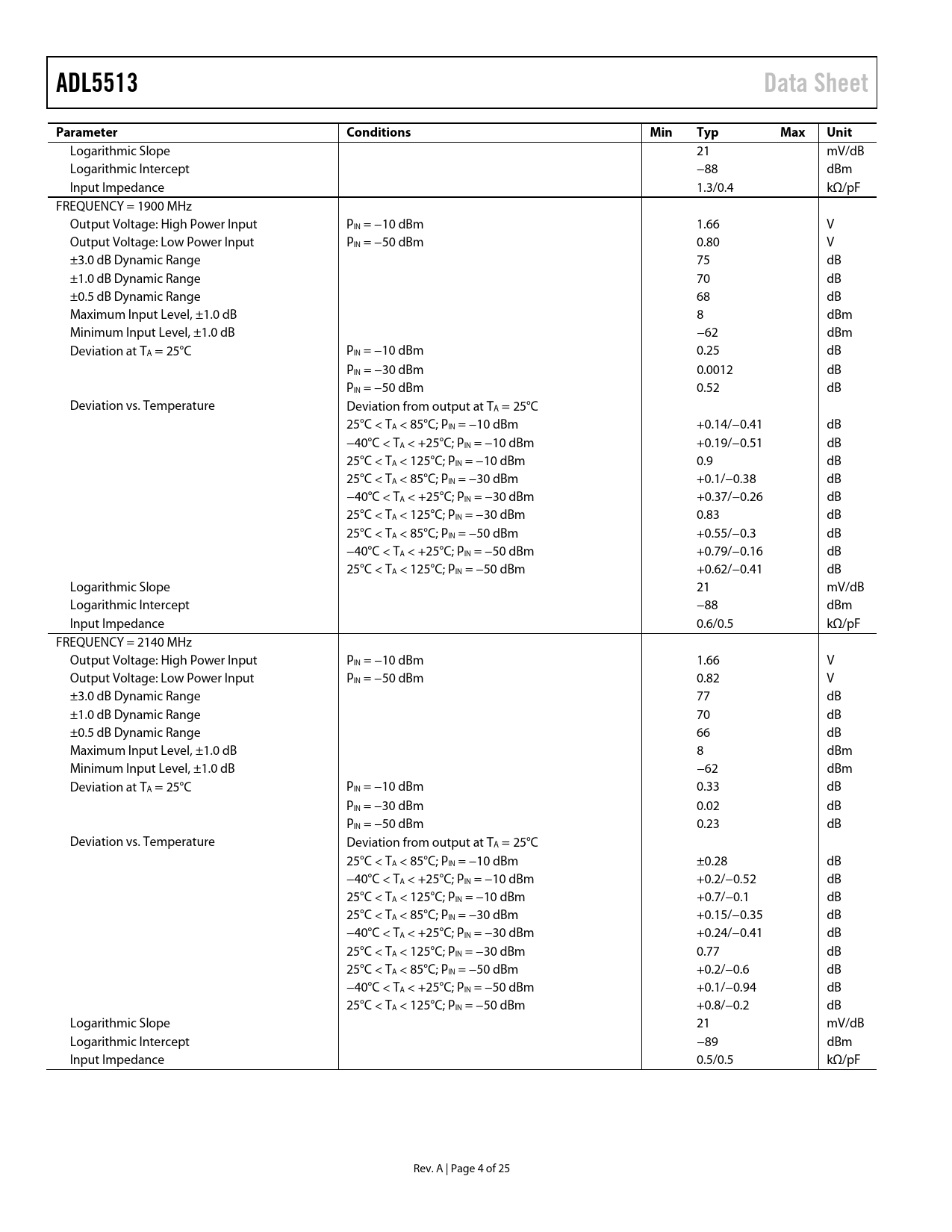

Pages / Page25 / 4 — ADL5513. Data Sheet. Parameter. Conditions. Min. Typ. Max. Unit
RevisionA
ADL5513 Data Sheet Parameter Conditions Min Typ Max Unit
Logarithmic Slope 21 mV/dB Logarithmic Intercept −88 dBm Input Impedance 1.3/0.4 kΩ/pF FREQUENCY = 1900 MHz Output Voltage: High Power Input PIN = −10 dBm 1.66 V Output Voltage: Low Power Input PIN = −50 dBm 0.80 V ±3.0 dB Dynamic Range 75 dB ±1.0 dB Dynamic Range 70 dB ±0.5 dB Dynamic Range 68 dB Maximum Input Level, ±1.0 dB 8 dBm Minimum Input Level, ±1.0 dB −62 dBm Deviation at TA = 25°C PIN = −10 dBm 0.25 dB PIN = −30 dBm 0.0012 dB PIN = −50 dBm 0.52 dB Deviation vs. Temperature Deviation from output at TA = 25°C 25°C < TA < 85°C; PIN = −10 dBm +0.14/−0.41 dB −40°C < TA < +25°C; PIN = −10 dBm +0.19/−0.51 dB 25°C < TA < 125°C; PIN = −10 dBm 0.9 dB 25°C < TA < 85°C; PIN = −30 dBm +0.1/−0.38 dB −40°C < TA < +25°C; PIN = −30 dBm +0.37/−0.26 dB 25°C < TA < 125°C; PIN = −30 dBm 0.83 dB 25°C < TA < 85°C; PIN = −50 dBm +0.55/−0.3 dB −40°C < TA < +25°C; PIN = −50 dBm +0.79/−0.16 dB 25°C < TA < 125°C; PIN = −50 dBm +0.62/−0.41 dB Logarithmic Slope 21 mV/dB Logarithmic Intercept −88 dBm Input Impedance 0.6/0.5 kΩ/pF FREQUENCY = 2140 MHz Output Voltage: High Power Input PIN = −10 dBm 1.66 V Output Voltage: Low Power Input PIN = −50 dBm 0.82 V ±3.0 dB Dynamic Range 77 dB ±1.0 dB Dynamic Range 70 dB ±0.5 dB Dynamic Range 66 dB Maximum Input Level, ±1.0 dB 8 dBm Minimum Input Level, ±1.0 dB −62 dBm Deviation at TA = 25°C PIN = −10 dBm 0.33 dB PIN = −30 dBm 0.02 dB PIN = −50 dBm 0.23 dB Deviation vs. Temperature Deviation from output at TA = 25°C 25°C < TA < 85°C; PIN = −10 dBm ±0.28 dB −40°C < TA < +25°C; PIN = −10 dBm +0.2/−0.52 dB 25°C < TA < 125°C; PIN = −10 dBm +0.7/−0.1 dB 25°C < TA < 85°C; PIN = −30 dBm +0.15/−0.35 dB −40°C < TA < +25°C; PIN = −30 dBm +0.24/−0.41 dB 25°C < TA < 125°C; PIN = −30 dBm 0.77 dB 25°C < TA < 85°C; PIN = −50 dBm +0.2/−0.6 dB −40°C < TA < +25°C; PIN = −50 dBm +0.1/−0.94 dB 25°C < TA < 125°C; PIN = −50 dBm +0.8/−0.2 dB Logarithmic Slope 21 mV/dB Logarithmic Intercept −89 dBm Input Impedance 0.5/0.5 kΩ/pF Rev. A | Page 4 of 25 Document Outline Features Applications Functional Block Diagram General Description Table of Contents Revision History Specifications Absolute Maximum Ratings ESD Caution Pin Configuration and Function Descriptions Typical Performance Characteristics Theory of Operation Applications Information Basic Connections Input Signal Coupling Output Filtering Output Interface Setpoint Interface Description of Characterization Error Calculations Adjusting Accuracy Through Choice of Calibration Points Temperature Compensation of Output Voltage Device Calibration Power-Down Functionality Measurement Mode Setting the Output Slope in Measurement Mode Controller Mode Constant Power Operation Increasing the Dynamic Range of the ADL5513 Evaluation Board Outline Dimensions Ordering Guide
