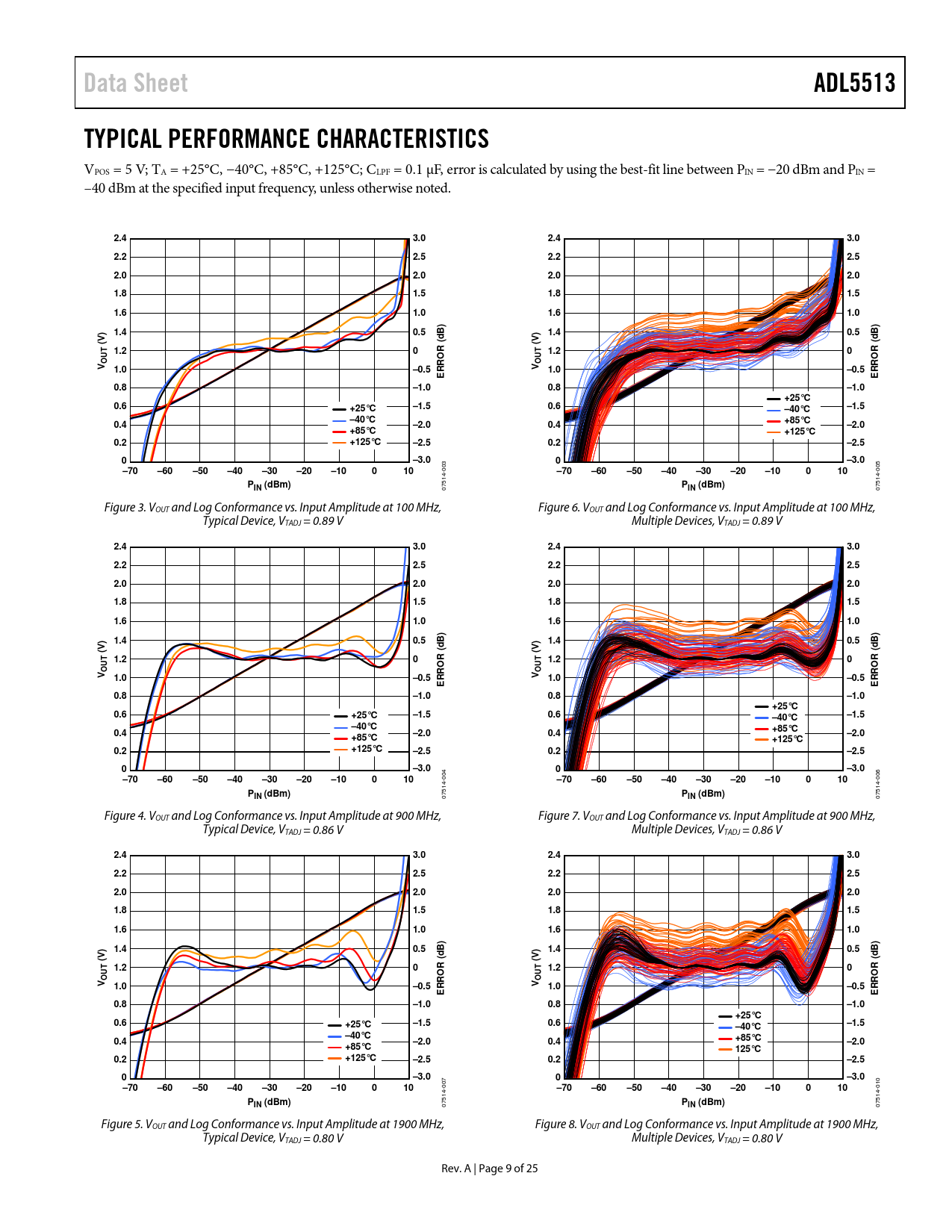

Data Sheet. ADL5513. TYPICAL PERFORMANCE CHARACTERISTICS. 2.4. 3.0. 2.2. 2.5. 2.0. 1.8. 1.5. 1.6. 1.0. 1.4. 0.5. (V). 1.2. R (. –0.5. RRO. 0.8. –1.0. +25°C. 0.6
Data Sheet ADL5513 TYPICAL PERFORMANCE CHARACTERISTICS 2.4 3.0 2.2 2.5 2.0 1.8 1.5 1.6 1.0 1.4 0.5 (V) 1.2 R ( –0.5 RRO 0.8 –1.0 +25°C 0.6
VPOS = 5 V; TA = +25°C, −40°C, +85°C, +125°C; CLPF = 0.1 μF, error is calculated by using the best-fit line between PIN = −20 dBm and PIN = −40 dBm at the specified input frequency, unless otherwise noted.
2.4 3.0 2.4 3.0 2.2 2.5 2.2 2.5 2.0 2.0 2.0 2.0 1.8 1.5 1.8 1.5 1.6 1.0 1.6 1.0 1.4 0.5 B) B) d 1.4 0.5 d (V) (V) 1.2 0 R ( 1.2 0 R ( UT UT O O V 1.0 –0.5 RRO V 1.0 –0.5 RRO E E 0.8 –1.0 0.8 –1.0 +25°C 0.6 –1.5 +25°C 0.6 –1.5 –40°C –40°C 0.4 –2.0 0.4 +85°C –2.0 +85°C +125°C 0.2 +125°C –2.5 0.2 –2.5 0 –3.0 0 –3.0 –70 –60 –50 –40 –30 –20 –10 0 10

07514- Figure 3. VOUT and Log Conformance vs. Input Amplitude at 100 MHz, Figure 6. VOUT and Log Conformance vs. Input Amplitude at 100 MHz, Typical Device, VTADJ = 0.89 V Multiple Devices, VTADJ = 0.89 V

07514- Figure 4. VOUT and Log Conformance vs. Input Amplitude at 900 MHz, Figure 7. VOUT and Log Conformance vs. Input Amplitude at 900 MHz, Typical Device, VTADJ = 0.86 V Multiple Devices, VTADJ = 0.86 V

07514- Figure 5. VOUT and Log Conformance vs. Input Amplitude at 1900 MHz, Figure 8. VOUT and Log Conformance vs. Input Amplitude at 1900 MHz, Typical Device, VTADJ = 0.80 V Multiple Devices, VTADJ = 0.80 V Rev. A | Page 9 of 25 Document Outline Features Applications Functional Block Diagram General Description Table of Contents Revision History Specifications Absolute Maximum Ratings ESD Caution Pin Configuration and Function Descriptions Typical Performance Characteristics Theory of Operation Applications Information Basic Connections Input Signal Coupling Output Filtering Output Interface Setpoint Interface Description of Characterization Error Calculations Adjusting Accuracy Through Choice of Calibration Points Temperature Compensation of Output Voltage Device Calibration Power-Down Functionality Measurement Mode Setting the Output Slope in Measurement Mode Controller Mode Constant Power Operation Increasing the Dynamic Range of the ADL5513 Evaluation Board Outline Dimensions Ordering Guide
