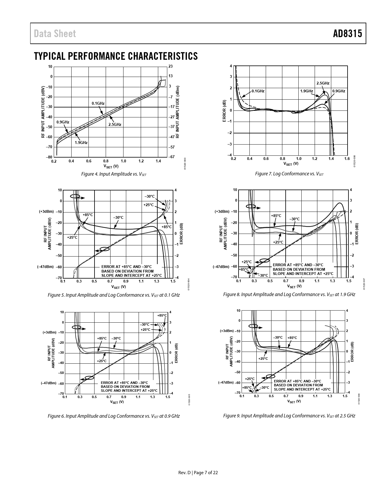

Pages / Page22 / 7 — Data Sheet. AD8315. TYPICAL PERFORMANCE CHARACTERISTICS. 2.5GHz. ) –10. …
RevisionD
File Format / SizePDF / 450 Kb
Data Sheet. AD8315. TYPICAL PERFORMANCE CHARACTERISTICS. 2.5GHz. ) –10. 0.1GHz. 1.9GHz. 0.9GHz. Bm). –20. UDE. B) d. IT –30. –17. IT L. R (. –27. AM –40
Data Sheet AD8315 TYPICAL PERFORMANCE CHARACTERISTICS 2.5GHz ) –10 0.1GHz 1.9GHz 0.9GHz Bm) –20 UDE B) d IT –30 –17 IT L R ( –27 AM –40
Data Sheet AD8315 TYPICAL PERFORMANCE CHARACTERISTICS 10 23 4 0 13 3 2.5GHz ) –10 3 2 BV 0.1GHz 1.9GHz 0.9GHz d Bm) ( d –20 –7 ( 1 UDE 0.1GHz UDE B) d IT –30 –17 L IT L R ( P 0 P O –27 R AM –40 AM ER –1 UT 0.9GHz 2.5GHz UT –50 –37 NP I F INP –2 R –60 –47 RF 1.9GHz –3 –70 –57 –80 –67 –4

15 015 0 Figure 4. Input Amplitude vs. VSET Figure 7. Log Conformance vs. VSET
10 4 10 4 –30°C 0 3 0 3 +25°C (+3dBm) –10 2 (+3dBm) –10 2 +85°C –30°C +85°C ) –30°C BV) –20 1 BV –20 1 d B) d ( +85°C B) UT ( d (d UT ( NP –30 0 R NP –30 0 R I UDE I UDE IT +25°C IT RF L RRO RF L RRO P P +25°C –40 –1 E –40 –1 E AM AM –50 –2 –50 –2 +25°C (–47dBm) –60 ERROR AT +85°C AND –30°C –3 (–47dBm) –60 ERROR AT +85°C AND –30°C –3 BASED ON DEVIATION FROM +85°C BASED ON DEVIATION FROM SLOPE AND INTERCEPT AT +25°C –30°C SLOPE AND INTERCEPT AT +25°C –70 –4 –70 –4

52 01 01 Figure 5. Input Amplitude and Log Conformance vs. VSET at 0.1 GHz Figure 8. Input Amplitude and Log Conformance vs. VSET at 1.9 GHz
10 4 10 4 +85°C 3 0 3 0 –30°C +25°C (+3dBm) –10 2 (+3dBm) –10 2 ) ) +85°C –30°C –30°C +85°C V BV –20 1 B –20 1 d d B) T ( d UT U E ( ( (dB) P D 0 R NP –30 0 R –30 U I UDE IN IT F IT RF L RRO R +25°C RRO P PL E –40 +25°C –1 E –40 –1 M M A A –50 –2 –50 –2 +25°C (–47dBm) ERROR AT +85°C AND –30°C –60 ERROR AT +85°C AND –30°C –3 (–47dBm) –60 –3 BASED ON DEVIATION FROM BASED ON DEVIATION FROM +85°C –30°C SLOPE AND INTERCEPT AT +25°C SLOPE AND INTERCEPT AT +25°C –70 –4 –70 –4 0.1 0.3 0.5 0.7 0.9 1.1 1.3 1.5 0.1 0.3 0.5 0.7 0.9 1.1 1.3 1.5
