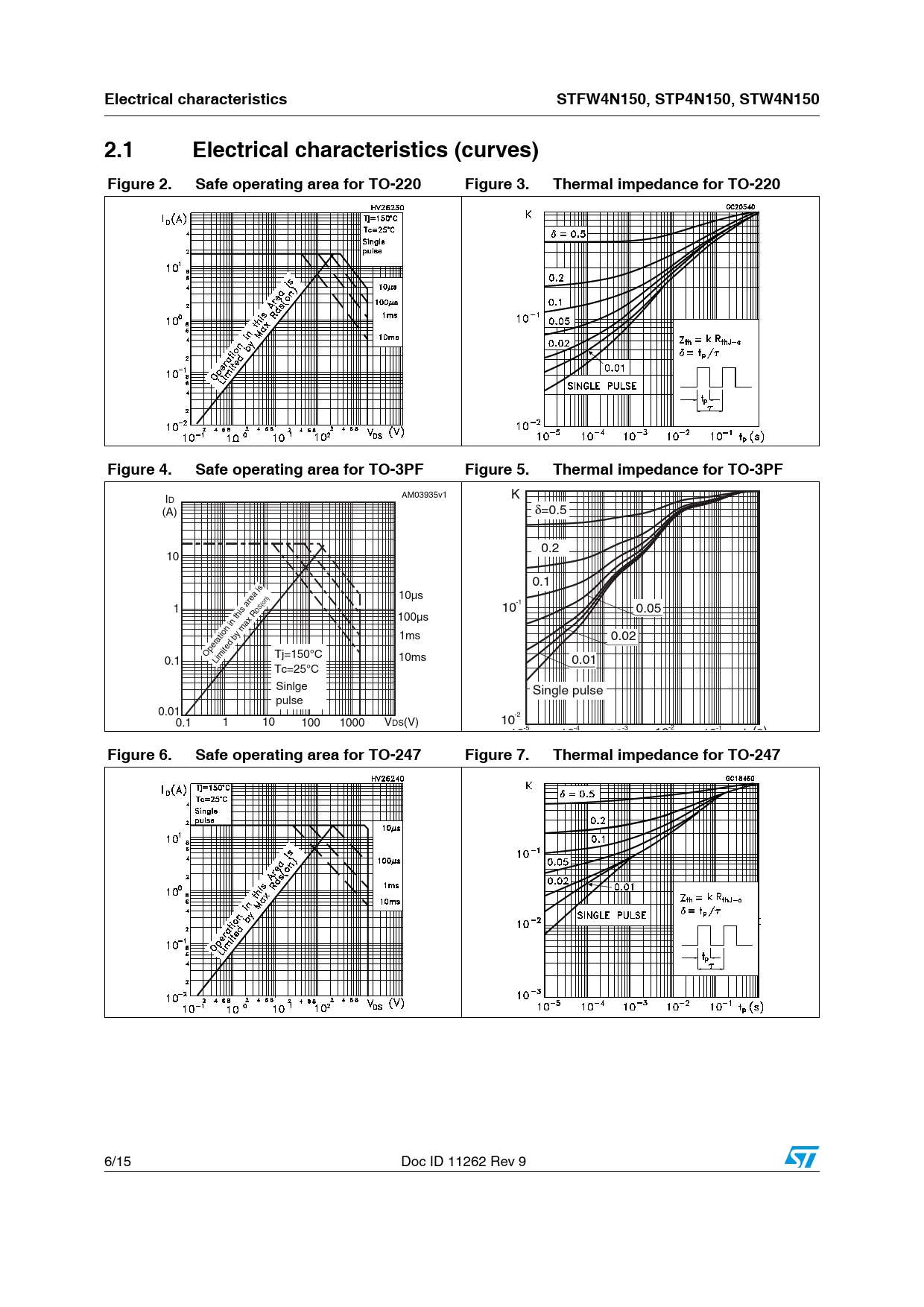

Electrical characteristics. STFW4N150, STP4N150, STW4N150. 2.1 Electrical. characteristics (curves). Figure 2
Electrical characteristics STFW4N150, STP4N150, STW4N150 2.1 Electrical characteristics (curves) Figure 2
Electrical characteristics STFW4N150, STP4N150, STW4N150 2.1 Electrical characteristics (curves) Figure 2. Safe operating area for TO-220 Figure 3. Thermal impedance for TO-220 Figure 4. Safe operating area for TO-3PF Figure 5. Thermal impedance for TO-3PF
TO3PF I AM03935v1 K D (A) δ=0.5 0.2 10 0.1 a is 10µs -1 1 (on) s are S D 10 0.05 100µs ax R 1ms ation in thi by m 0.02 Oper Tj=150°C 0.1 Limited 10ms 0.01 Tc=25°C Sinlge Single pulse pulse 0.01 -2 0.1 1 10 100 1000 VDS(V) 10 -5 -4 -3 -2 -1 10 10 10 10 10 t (s)
Figure 6. Safe operating area for TO-247 Figure 7. Thermal impedance for TO-247
