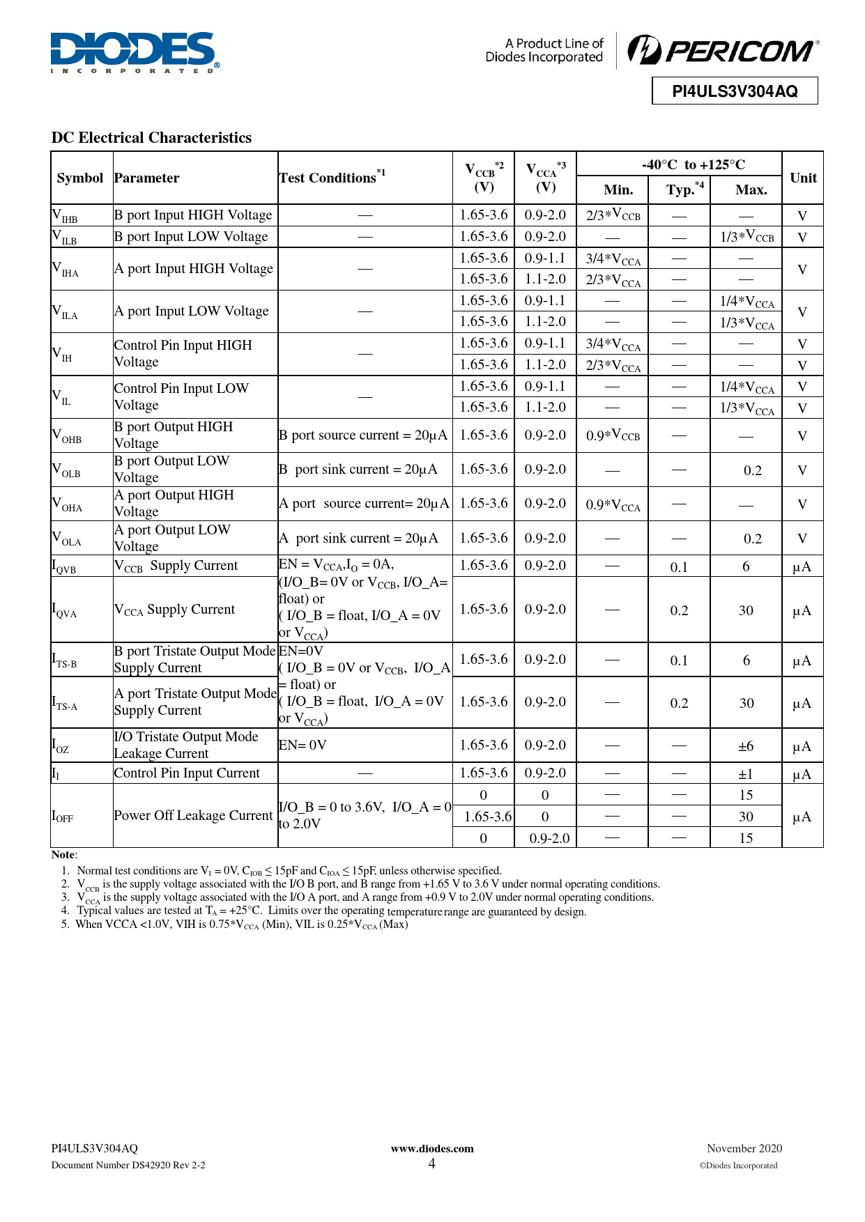

DescriptionAutomotive Qualified 140Mb/s Bi-directional Level Translator for Push-Pull Applications Features
Pages / Page13 / 4 — PI4ULS3V304AQ. DC Electrical Characteristics. -40°C to +125°C. Symbol …
PI4ULS3V304AQ. DC Electrical Characteristics. -40°C to +125°C. Symbol Parameter. Test Conditions*1. CCB. CCA. Unit. (V). Min. Typ.*4. Max. Note
PI4ULS3V304AQ DC Electrical Characteristics -40°C to +125°C Symbol Parameter Test Conditions*1 CCB CCA Unit (V) Min Typ.*4 Max Note
PI4ULS3V304AQ DC Electrical Characteristics V *2 V *3 -40°C to +125°C Symbol Parameter Test Conditions*1 CCB CCA Unit (V) (V) Min. Typ.*4 Max.
VIHB B port Input HIGH Voltage — 1.65-3.6 0.9-2.0 2/3*VCCB — — V VILB B port Input LOW Voltage — 1.65-3.6 0.9-2.0 — — 1/3*VCCB V 1.65-3.6 0.9-1.1 3/4*V V CCA — — IHA A port Input HIGH Voltage — V 1.65-3.6 1.1-2.0 2/3*VCCA — — 1.65-3.6 0.9-1.1 — — 1/4*V V CCA ILA A port Input LOW Voltage — V 1.65-3.6 1.1-2.0 — — 1/3*VCCA Control Pin Input HIGH 1.65-3.6 0.9-1.1 3/4*V V — CCA — — V IH Voltage 1.65-3.6 1.1-2.0 2/3*VCCA — — V Control Pin Input LOW 1.65-3.6 0.9-1.1 — — 1/4*V V — CCA V IL Voltage 1.65-3.6 1.1-2.0 — — 1/3*VCCA V B port V Output HIGH B port source current = 20µA 1.65-3.6 0.9-2.0 OHB 0.9*V Voltage CCB — — V B port V Output LOW B port sink current = 20µA 1.65-3.6 0.9-2.0 — OLB — 0.2 V Voltage A port V Output HIGH A port OHA source current= 20µA 1.65-3.6 0.9-2.0 0.9*V Voltage CCA — — V A port V Output LOW A port sink current = 20µA 1.65-3.6 0.9-2.0 — — OLA 0.2 V Voltage I 1.65-3.6 0.9-2.0 — QVB VCCB Supply Current EN = VCCA,IO = 0A, 0.1 6 µA (I/O_B= 0V or VCCB, I/O_A= float) or I 1.65-3.6 0.9-2.0 — QVA VCCA Supply Current ( I/O_B = float, I/O_A = 0V 0.2 30 µA or V ) CCA B port Tristate Output Mode EN=0V I 1.65-3.6 0.9-2.0 — TS-B 0.1 6 µA Supply Current ( I/O_B = 0V or VCCB, I/O_A = float) or A port I Tristate Output Mode ( I/O_B = float, I/O_A = 0V 1.65-3.6 0.9-2.0 — TS-A 0.2 30 µA Supply Current or V ) CCA I/O Tristate Output Mode I EN= 0V 1.65-3.6 0.9-2.0 — — OZ ±6 µA Leakage Current II Control Pin Input Current — 1.65-3.6 0.9-2.0 — — ±1 µA 0 0 — — 15 I/O_B = 0 to 3.6V, I/O_A = 0 IOFF Power Off Leakage Current 1.65-3.6 0 — — 30 µA to 2.0V 0 0.9-2.0 — — 15
Note
: 1. Normal test conditions are VI = 0V, CIOB ≤ 15pF and CIOA ≤ 15pF, unless otherwise specified. 2. VCCB is the supply voltage associated with the I/O B port, and B range from +1.65 V to 3.6 V under normal operating conditions. 3. VCCA is the supply voltage associated with the I/O A port, and A range from +0.9 V to 2.0V under normal operating conditions. 4. Typical values are tested at TA = +25°C. Limits over the operating temperature range are guaranteed by design. 5. When VCCA <1.0V, VIH is 0.75*VCCA (Min), VIL is 0.25*VCCA (Max) PI4ULS3V304AQ
