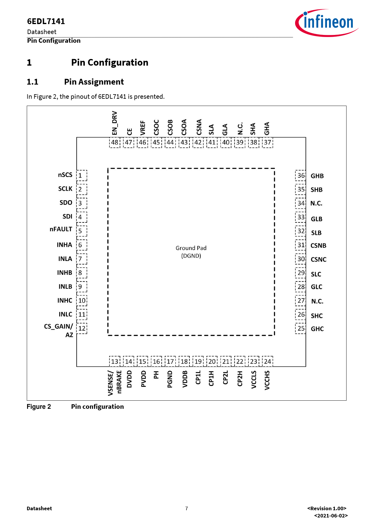

Pin Configuration 1 Pin Configuration 1.1 Pin Assignment
In Figure 2, the pinout of 6EDL7141 is presented.
Figure 2 Pin configuration Datasheet
