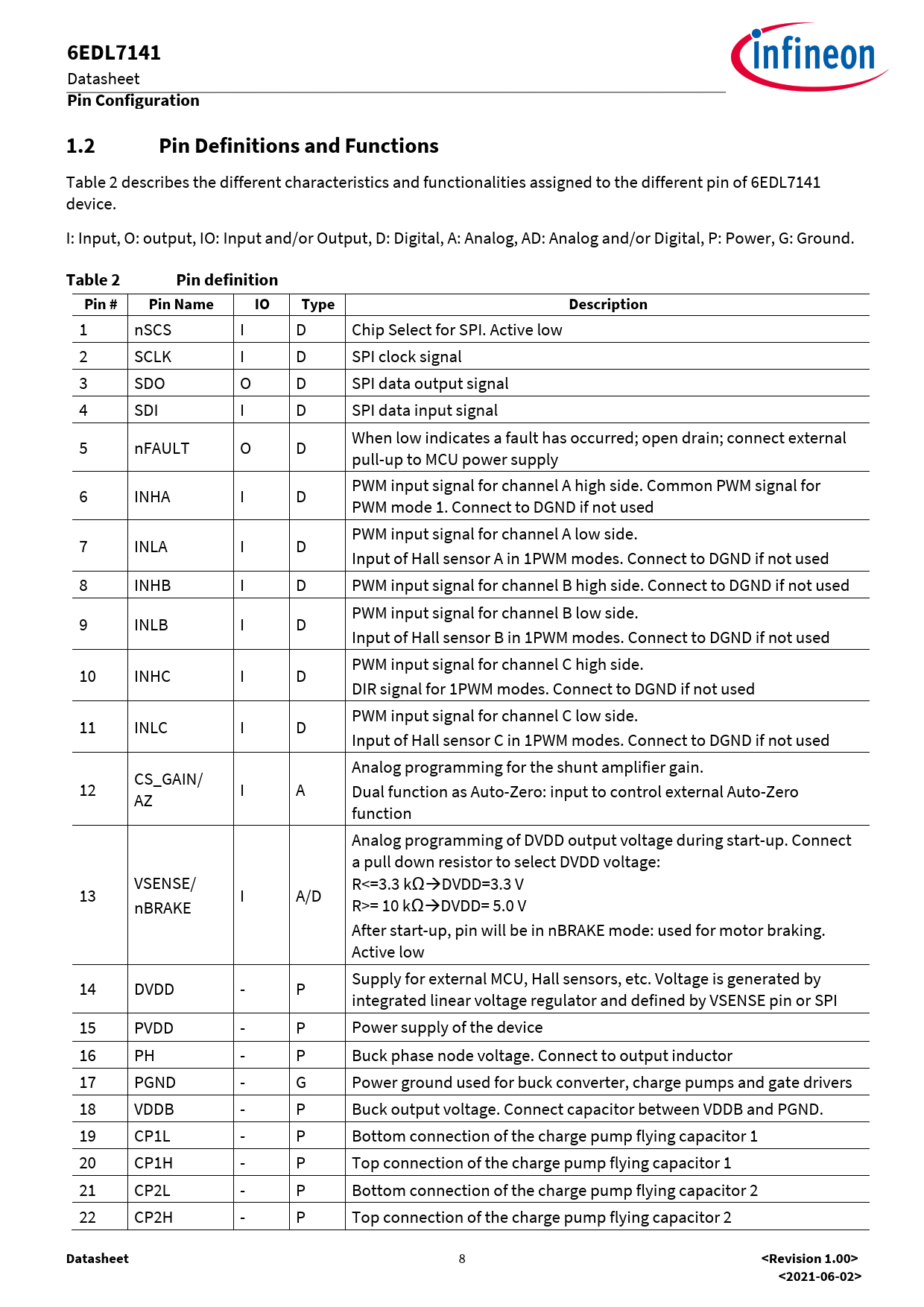

Pin Configuration 1.2 Pin Definitions and Functions
Table 2 describes the different characteristics and functionalities assigned to the different pin of 6EDL7141 device. I: Input, O: output, IO: Input and/or Output, D: Digital, A: Analog, AD: Analog and/or Digital, P: Power, G: Ground.
Table 2 Pin definition Pin # Pin Name IO Type Description
1 nSCS I D Chip Select for SPI. Active low 2 SCLK I D SPI clock signal 3 SDO O D SPI data output signal 4 SDI I D SPI data input signal When low indicates a fault has occurred; open drain; connect external 5 nFAULT O D pull-up to MCU power supply PWM input signal for channel A high side. Common PWM signal for 6 INHA I D PWM mode 1. Connect to DGND if not used PWM input signal for channel A low side. 7 INLA I D Input of Hall sensor A in 1PWM modes. Connect to DGND if not used 8 INHB I D PWM input signal for channel B high side. Connect to DGND if not used PWM input signal for channel B low side. 9 INLB I D Input of Hall sensor B in 1PWM modes. Connect to DGND if not used PWM input signal for channel C high side. 10 INHC I D DIR signal for 1PWM modes. Connect to DGND if not used PWM input signal for channel C low side. 11 INLC I D Input of Hall sensor C in 1PWM modes. Connect to DGND if not used Analog programming for the shunt amplifier gain. CS_GAIN/ 12 I A AZ Dual function as Auto-Zero: input to control external Auto-Zero function Analog programming of DVDD output voltage during start-up. Connect a pull down resistor to select DVDD voltage: VSENSE/ R<=3.3 kΩDVDD=3.3 V 13 I A/D nBRAKE R>= 10 kΩDVDD= 5.0 V After start-up, pin will be in nBRAKE mode: used for motor braking. Active low Supply for external MCU, Hall sensors, etc. Voltage is generated by 14 DVDD - P integrated linear voltage regulator and defined by VSENSE pin or SPI 15 PVDD - P Power supply of the device 16 PH - P Buck phase node voltage. Connect to output inductor 17 PGND - G Power ground used for buck converter, charge pumps and gate drivers 18 VDDB - P Buck output voltage. Connect capacitor between VDDB and PGND. 19 CP1L - P Bottom connection of the charge pump flying capacitor 1 20 CP1H - P Top connection of the charge pump flying capacitor 1 21 CP2L - P Bottom connection of the charge pump flying capacitor 2 22 CP2H - P Top connection of the charge pump flying capacitor 2
