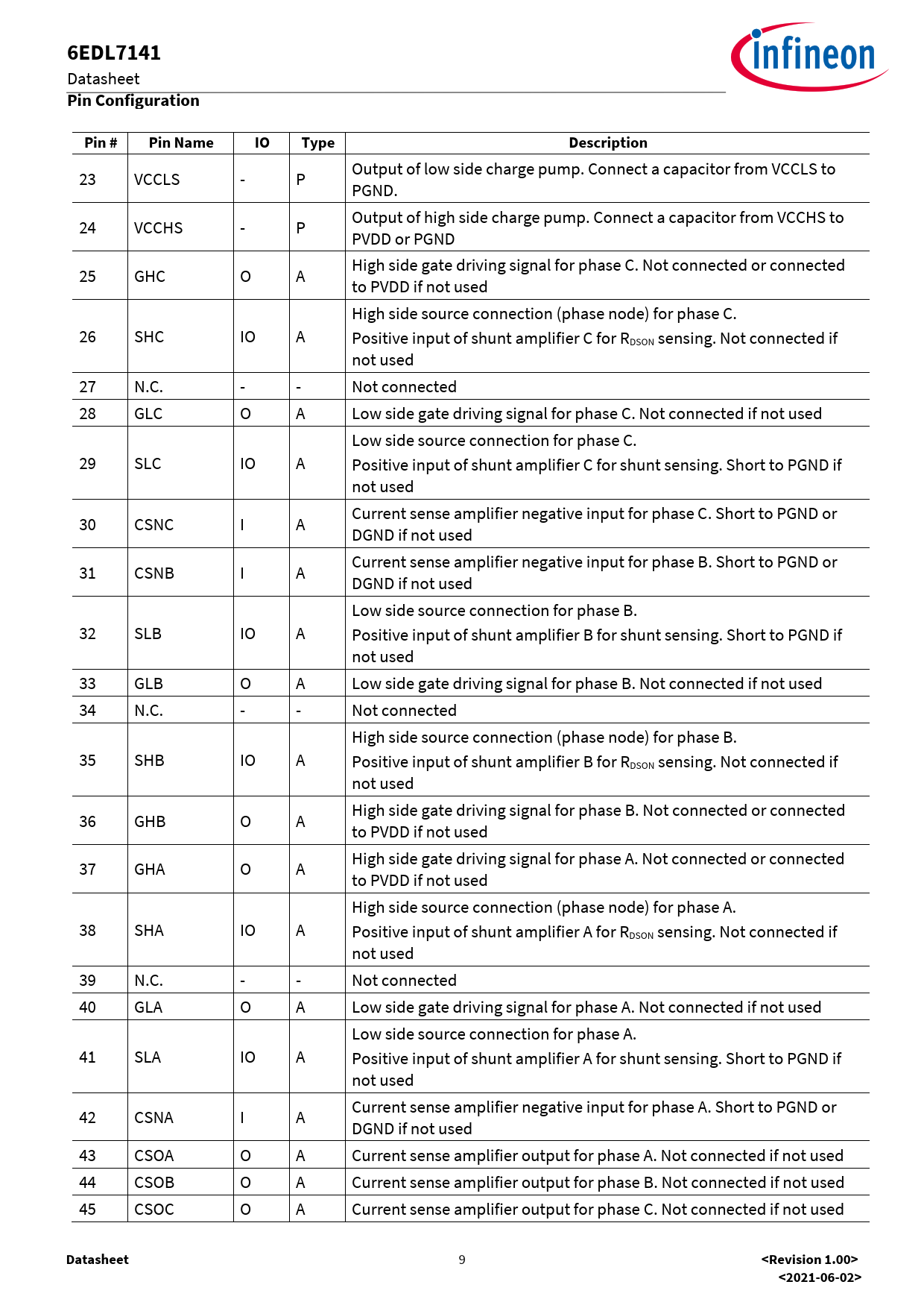

Pin Configuration Pin # Pin Name IO Type Description
Output of low side charge pump. Connect a capacitor from VCCLS to 23 VCCLS - P PGND. Output of high side charge pump. Connect a capacitor from VCCHS to 24 VCCHS - P PVDD or PGND High side gate driving signal for phase C. Not connected or connected 25 GHC O A to PVDD if not used High side source connection (phase node) for phase C. 26 SHC IO A Positive input of shunt amplifier C for RDSON sensing. Not connected if not used 27 N.C. - - Not connected 28 GLC O A Low side gate driving signal for phase C. Not connected if not used Low side source connection for phase C. 29 SLC IO A Positive input of shunt amplifier C for shunt sensing. Short to PGND if not used Current sense amplifier negative input for phase C. Short to PGND or 30 CSNC I A DGND if not used Current sense amplifier negative input for phase B. Short to PGND or 31 CSNB I A DGND if not used Low side source connection for phase B. 32 SLB IO A Positive input of shunt amplifier B for shunt sensing. Short to PGND if not used 33 GLB O A Low side gate driving signal for phase B. Not connected if not used 34 N.C. - - Not connected High side source connection (phase node) for phase B. 35 SHB IO A Positive input of shunt amplifier B for RDSON sensing. Not connected if not used High side gate driving signal for phase B. Not connected or connected 36 GHB O A to PVDD if not used High side gate driving signal for phase A. Not connected or connected 37 GHA O A to PVDD if not used High side source connection (phase node) for phase A. 38 SHA IO A Positive input of shunt amplifier A for RDSON sensing. Not connected if not used 39 N.C. - - Not connected 40 GLA O A Low side gate driving signal for phase A. Not connected if not used Low side source connection for phase A. 41 SLA IO A Positive input of shunt amplifier A for shunt sensing. Short to PGND if not used Current sense amplifier negative input for phase A. Short to PGND or 42 CSNA I A DGND if not used 43 CSOA O A Current sense amplifier output for phase A. Not connected if not used 44 CSOB O A Current sense amplifier output for phase B. Not connected if not used 45 CSOC O A Current sense amplifier output for phase C. Not connected if not used
